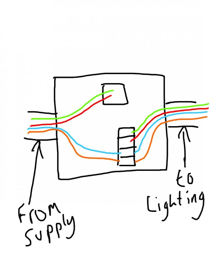

We are in the process of completing changing our garden and as a result we need to think about sockets etc.
Previously there were a number of outdoor sockets and seperate lights but all run off a 4 core 2.5mm swa cable which has seperate circuits on mains box to turn off either the outdoor sockets or lights.
In our new garden I would like to keep one socket and then the lighting circuit for installing low voltage lights. These lights though run off a plug socket so I am not sure how to lay this out.
My gardener has started work so needs to know what to do with the wires. At the moment I have kept one socket and a swa wire coming off that on that was originally used for lighting.
Will this work when the electrician comes to install the low voltage(that comes with a plug)?
I could always get him to change the single socket to a double and use one for the plug for the lights and the other as a spare but this would mean both socket and lights would be on the same circuit.
Could another socket be installed using the swa cable that was previously used for lighting?
The low voltage lights I have seen are 12v and run off a transformer that needs to be plugged into a powet socket. Does that answer you question?

Is the transformer a wall-wart, or one with a trailing flex? If the former will the socket retain its IP rating with it in? If the latter can it be used outdoors?

I would ideally like this to go the lighting circuit so I can keep the lighting and power sockets on separate circuits, as they were before.

There is one socket as it stands but want to leave that as a spare for lawnmower etc.
Replace it with a double one.
Sockets on lighting circuits are rarely a good idea.

Ok I might have that wrong then. I didnt have a long look at it.
I'm not too concerned with how it is since theres no power to it yet and when the electrician comes he will know what to do.
I simply wanted to know if the gardener needs to worry about burying the lighting swa cable or not, if this will be disconnected.
I might give the electrician a ring and ask him about it.
