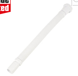

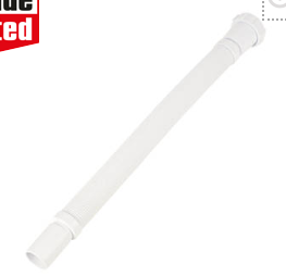

Morning all,
Just a quick question if anyone can help:
I've to connect the following 32 mm flexible waste pipe to a 40mm waste drain pipe in a restricted space under floor board:
https://www.screwfix.com/p/mcalpine-flexcon1-flexible-connector-white-white-32mm/38473
Is there a compression or push-fit fitting that adapts a 32mm waste fitting to a 40mm waste pipe?
Something along the lines of following would be good but this one adapts a 40mm push-fit waste fitting to accept 32mm push-fit waste pipe
https://www.wickes.co.uk/FloPlast-WP38W-Push-Fit-Waste-Reducer---White-40mm-x-32mm/p/431911
Your quick help would be highly appreciated. Many thanks in advance.

I agree NotSoNewBoy, solvent weld is ideal, do they do small tubes for just a few applications of solvent weld (the whole bottle would go waste otherwise)?

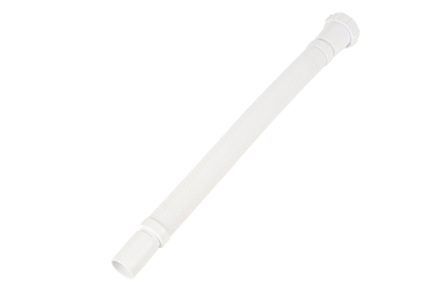

The link that you sent would not help me unfortunately. The 32mm compression fitting is same as that on the 32mm flexi drain pipe, so it will need a 32mm pipe between them. Space is not a luxury at the moment where this is going in.
If the "40" mm pipe below flooring is Solvent weld ( ABS) pipe , push fit fittings will not be compatible. You either use a compression reducer or solvent weld fittings. Why can't you use newboys suggested reducer ?
Hi terryplumb, if I have to use the compression fitting that notsonewboy suggested, I would need to insert a small 32mm pipe to attach the flex waste pipe with the compression fitting. Please check the first image in my original post and compare it to the compression fitting:
Use the adapter to convert to the 40mm and then the compression end of the flexi pipe takes a small piece of 32mm pipe, that then fits into the compression end of the basin trap.
Or get one of these if a flexi is really needed
images
The 40 mm end of the fitting goes onto the pipe below floor ,the spigot end of the flexi goes into the other end. The compression end of your flexi goes onto your 32mm pipe. Where do you think a small piece of pipe goes ?
Ok, I see why we are not on same page. Unfortunately, this is not a standard shower tray that I am connecting the flex pipe to. The "32mm pipe end" of flexi is already connected to the shower cubicle (please don't ask me why or how:sneaky:).
So this is the bit I need to connect under the floor board to 40 mm pipework:
OK ,unconventional to say the least !! Small piece of 32 mm pipe required to the reducer then.
I think the only option is go for solvent weld due to lack of space. Do they do any small quantity of solvent weld cement?
Yes you can buy a small tube , but price wise they are not much cheaper. Are you sure the 40 mm pipe is suitable for solvent welding ?
I believe so. They are several other solvent welds in place and its the thick Gray colour one. I thought they support solvent weld:)
