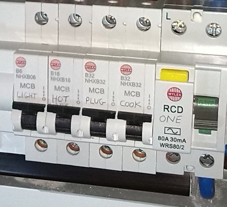

Although it's not a dramatic example, you have MCBs with ratings totalling 86A fed from an 80A RCD. If you take the other side of the CUI into account, you have MCBs with ratings totalling 146A fed from what I presume is a 100A Main Switch. That's all fine, and quite 'normal'.

Yup. Stick a clamp meter round the tails in 'normal use' (without an electric shower going or the oven on) and you'll find it's less than 10A. Whenever I've done it, it's more like 5 or 6A
