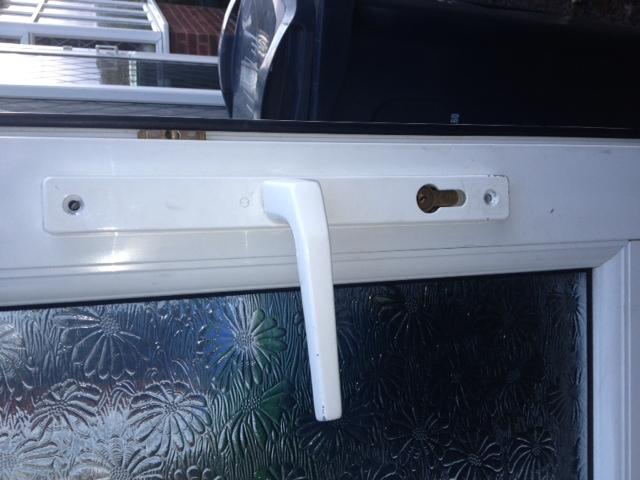

Hi,
I have just moved into a property (without properly looking at the porch door) and I have noticed that the door is a 5 point looking door (I think thats its called) and even the frames are set up for it but when I lock it, it only locks the main lock and the 'hooks' dont come over.
I have opened the handle and all I can see are the two springs (one for the inside hadle and the other for the out) and 1 single bar (this is to connect both handles), and then the lock.
Is there and thing I can do to make the door so it will lock properly? Will I need a new Gearbox or a new handle? If so, where could I get these?
Chris

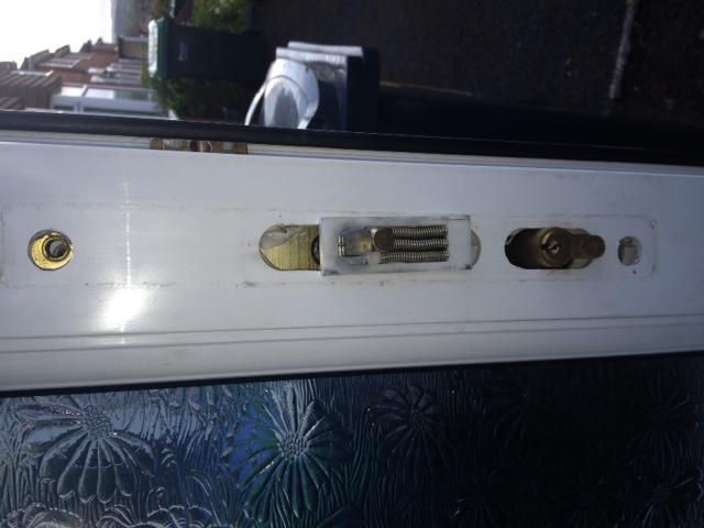

I have already tried this but the handle will not go up. When I took the handle off, the single 'bar' would not go clockwise.
From picture 1 it looks like you had no problem getting the handles off, can you see if the sq spindle is in good nick, no marks, rounding or anything, ditto to the spindle hole in the lock block itself. With the handles off, can you get a slotted screwdriver to throw the bolts/hooks and the lock mechanism?

The square spindle is in good working order, no dents or anything like that, the same goes for the spindle hole.
Looking at it, there appears to be two holes in the lock. Last night, I tried putting the spindle in both holes and tried raising the handle but neither hole would move clockwise. Thus not being able to throw the bolts/hooks over.
After taking the handles, springs and spindle off/out, I can see the lock but its not the best as there is loads of plastic in front. Is there an easy way for me to get the lock out or would that involve me taking the metal strip off on the inside of the door?
I cannot see any marks on the lock itself but then would it be better if I was to remove it?
Would more pictures help or not?

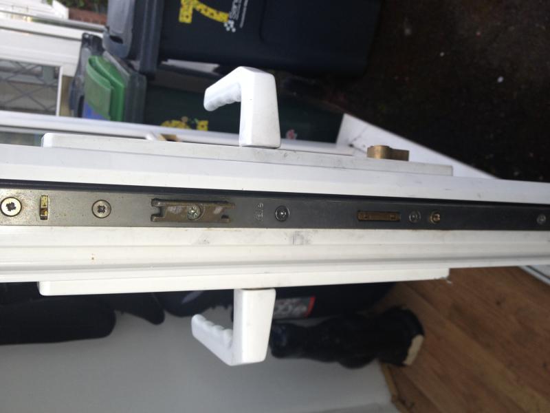

As I need to take it out and have a look, please see a photo that I took this morning (sorry its so dark, it was taken at half 6)
Can you please advise what screws I need to take you to find what lock I need?
I am also being stupid here but how will I be able to wiggle the lock out if I cannot get to it?

I have circle the four screws that are different, then there is one in the lock (yellow) and then a completely different screw (blue) which I think holds the lock in place.
So, can you let me know (in stupid terms) how to get the gearbox out so I can use your site to get a new one.
The one you've circled blue will be the euro cylinder (key operated lock tumblers) take this out and waggle the cylinder out (whicherver works - inwards or outwards) take off the handles and lay aside. Ignore the one circled yellow. Now you need to follow this youtube video, just ignore the add(s) - https://www.youtube.com/watch?v=KWVXn8RKR8k

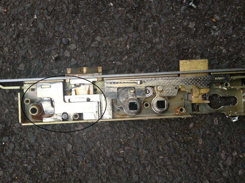

I have managed to get in, please see below for a pict.
The part that is circled is removeable.
Forgot to say that there is a bolt under that panel, it is smaller than the bolt in the bottom middle of my circle. This is connected to the bigger bolt by a bar which does turn
Sorry I got to take a pict of the gearbox with that panel off. Advise if you want a pict with it off.
