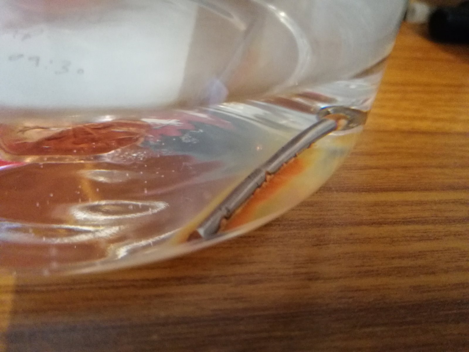

The central heating is original from when the property was built and, as the setup is Primatic, has never had or been able to have inhibitor. Only on 2nd boiler since new and I'd be very surprised if the system has been flushed at any time except for the boiler replacement, if that. Now intending to replace the current boiler and get rid of the Primatic so the system can have inhibitor. But should all the pipework be replaced at the same time? If not, what sort of lifetime should I expect post system update (ie new boiler, Primatic changed to something decent, inhibitor added and kept up to date)?

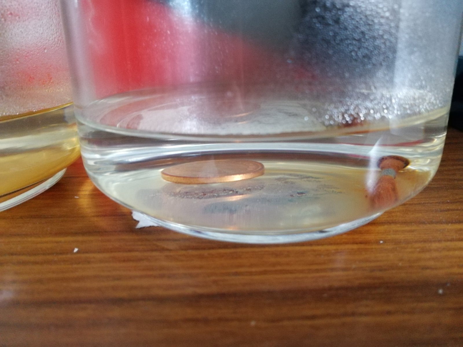

I did the corrosion test of 2 jars containing an iron nail and copper coin, one with circuit water and one with fresh from the tap water and am attaching photos. The nails were as new as I had to hand, bright with no corrosion visible. Both nails corroded but the circuit water nail corroded MUCH faster than the tap water nail and also turned the water rust coloured. I also tried checking pH with some litmus paper I had to hand but that didn't help. Finally, according to the water provider the water here is 130 mg/l / 9.24 Clarke degree (moderate hard).
Here is both jars, after 1 day. Circuit water on left, tap water on right.
Here are close ups of circuit (first) and tap (second)
Then after days here are both jars again
And here are close ups of circuit (first) and tap (second)
CentralHeatingCorrosionTestDay10CH.jpg CentralHeatingCorrosionTestDay10Tap.jpg
Pipes should be OK if everything heats up well. I wouldn't rip the house apart to repipe unless there were known blockages. Majority of corrosion on a Primatic system will be in rads and there will probably be significant magnetite corrosion debris in them too. So, bare minimum would be PROPER THOROUGH power flush, making sure the person doing it uses a rad hammer. The rad hammer is to loosen the debris in rads which can attach itself to inside and be difficult to remove. If the rads are old, consider new ones - they're quite cheap these days. Finally, fit a quality magnetic filter on the return to boiler.

You're welcome, 1001. Frequent bleeding could be down to gas being produced as a by-product of the corrosion process. But without seeing the system, it could be other things too. I would be starting with a proper clean and dosing with corrosion inhibitor and get the system checked if this doesn't improve matters.
