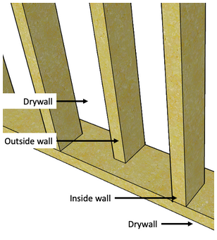

Silly question - with 50mm metal studs can you in-step/stagger them (to make say 60mm void width) so sound vibration does not go into plasterboard, through metal and into pasterboard on other side?
This method seperates the two plasterboard walls from each other.
Done tihs with wood studding, but noted it costs more as needs double the vertical studding. And not sure if can be done with metal studding as never used:
Staggered Stud to reduce noise transmission

Not really, Metal stud sits in a channel top and bottom so you wouldn't get the in-out staggered effect. You'd need to build two separate walls close together.
