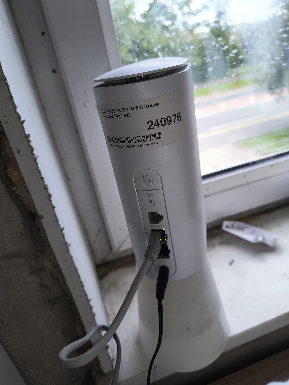

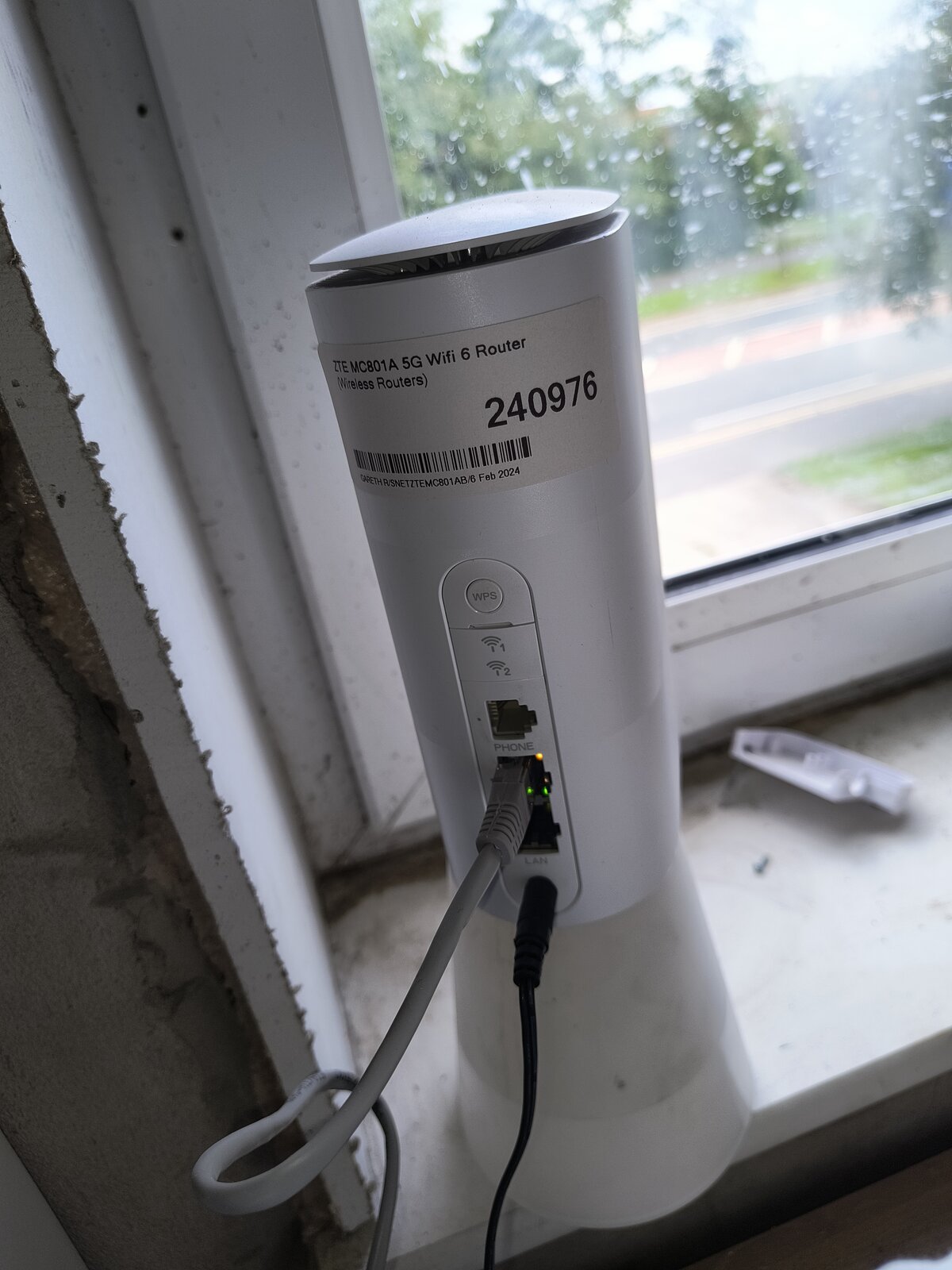

MC801a from CEX.
This, with a £15 a month unlimited smarty SIM is now our home broadband.
They sell "3" and unlocked routers - the 3 is cheaper. I've had a 3 one (worked with Smarty) but I expensively knocked it off a cupboard after a week, a second 3 one that didn't like Smarty (returned free - CEX very good) and a more expensive unlocked.

This is what I have, I think the things on the back are ethernet.
