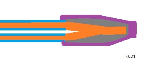

Just tell me how you put the heat shrink onto the conductors before soldering them and keep the heat shrink sleeve cool enough that it does not shrink before it can be sld over the soldered joint.
It can be done but requires a lot of the cable's sheath to be removed so the the heat shrink can put on the conductors before soldering and kept away from the heated area of copper until the soldering is completed..

Or are you advocating this type of soldered joint where the heat shrink does not have to be put on the conductors until after the joint has cooled
