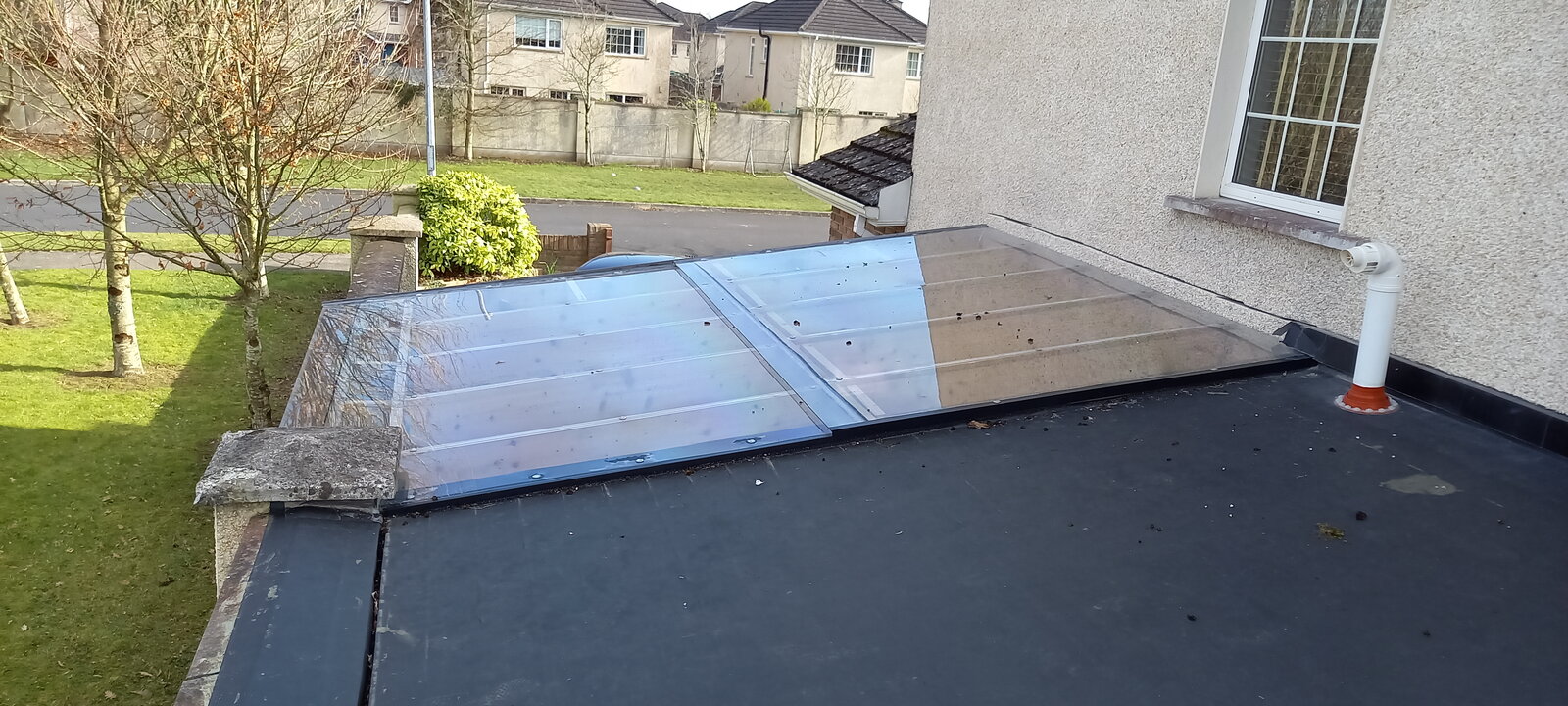

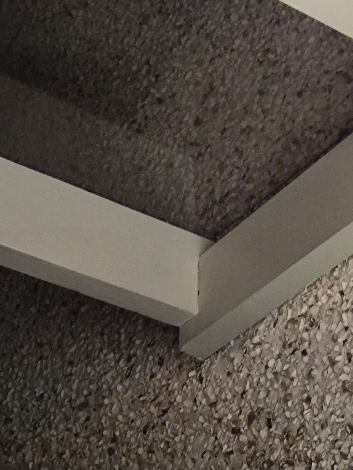

Yes went with 6mm solid clear and worked out well.

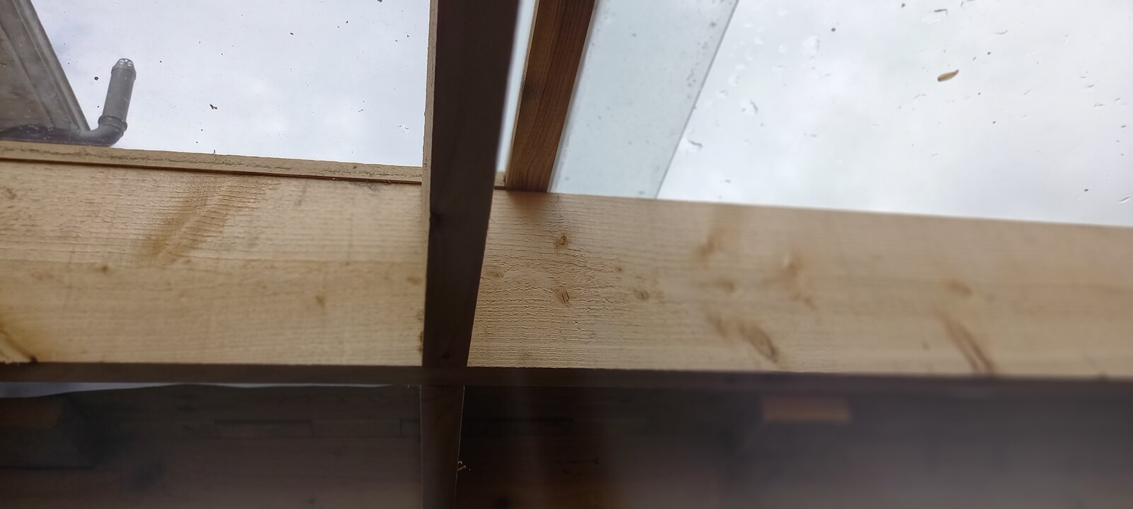

Purlins are 200 x 50mm @ 600 ctrs - well over-sized but I was matching in with adjoining epdm roof which is t&g on 175 x 50.
There is flex in the sheet for sure but only when handling or fixing. When in place it looks just like glass.

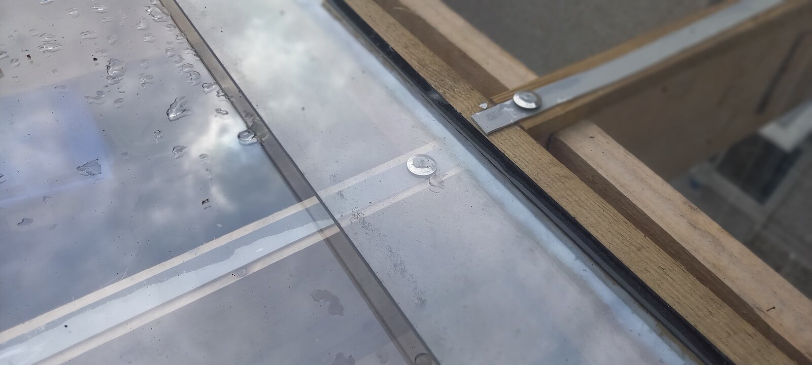

For the top of the purlins you can see a grey one sided tape:
Scapa® 3507 PVC Single Sided Foam Tape 25 mm X 30 mtrs Thickness 2.5mm sourced online from Self Adhesive Supplies.
Nut sure if this is absolutely necessary but I felt it no harm to cushion the poly.

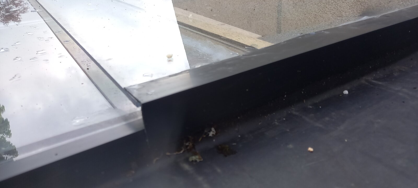

My pitch is 9 degrees so I was confident about my overlap detail as per photos.
Basically one sheet is 25mm higher that the other (2x1 batten on rafter) and overlap is circa 150mm.

For the fixings I went with these from ACCU:
https://www.accu.co.uk/en/sealing-raised-pozi-wood-screws/377517-SPRKSW-4-5-70-25-A2
Used the longer ones on upper sheet to go through extra batten and the 55mm for the lower sheet.
Just preferred the lower profile as opposed to the standard hex head cladding screw.

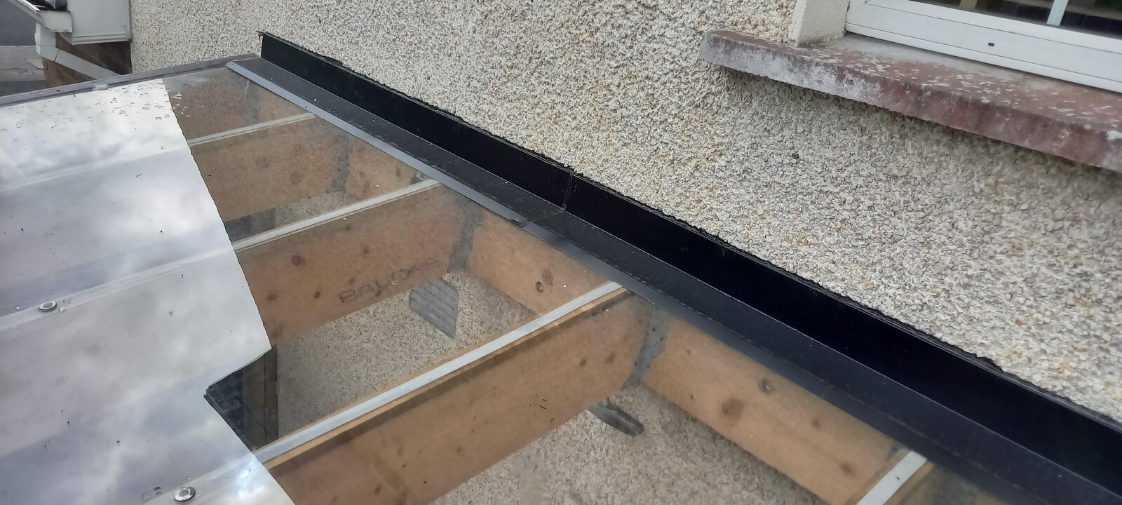

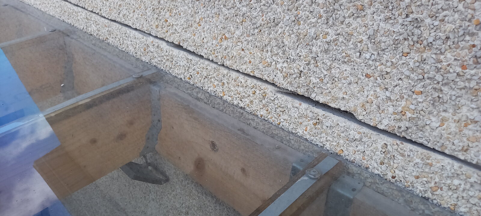

Mine will also be lean-to into a pebble dashed wall - did you grind a channel for flashing? Lead?
Just on the centres of supports, you better check with supplier. My supplier suggested supports at 500/600mm ctrs so 1m might be pushing it.
I sourced specific drill bits and jigsaw blades for plastic / plexiglass.
Might be OTT but just didn't wan't to take a chance based on price of sheets and having not worked with poly before.
Here's the drill bit:
https://www.fine-tools.com/kunststoffbohrer.html
The jigsaw blades I used are Bosch T101A sourced from Toolstop.
The H section for joint should be fine with plenty of clear neutral mastic. I assume this needs to be supported so ensure you have a rafter under.
I did look at it for mine but it's not recommended for going across the roof, ok for going in the direction of the fall so good for you.
On the flashing, yes I got a friend to consaw a cut but instead of lead I got an aluminium angle flashing made up by a local cladding supplier.
Just filled to cut with mastic and pushed the flashing into place, another bead of mastic across the top.
Flashing was easier to slot into place mean less work on the poly.
Make sure you chase before fitting the poly. Flashband tape another option but I'd imagine once stuck to the wall and poly there's no going back !

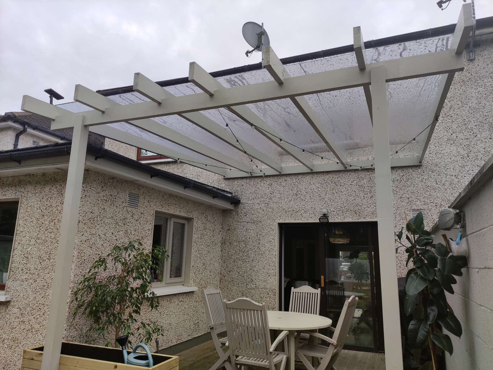

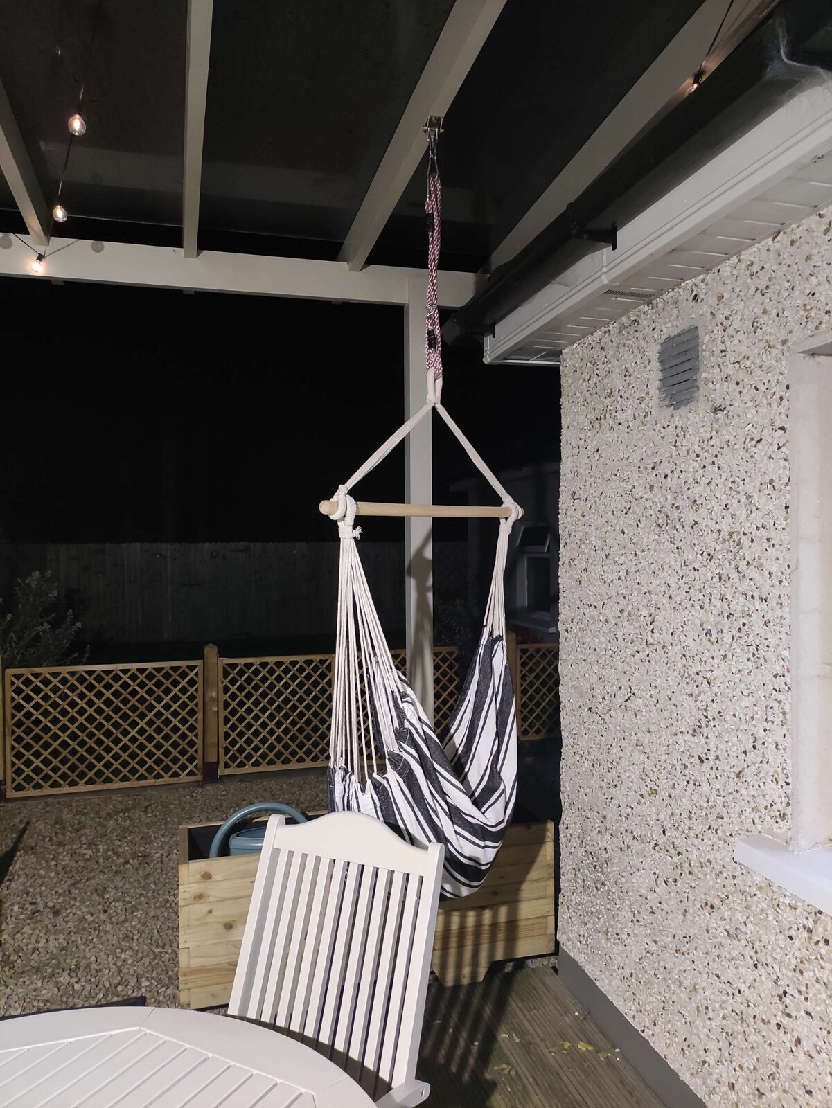

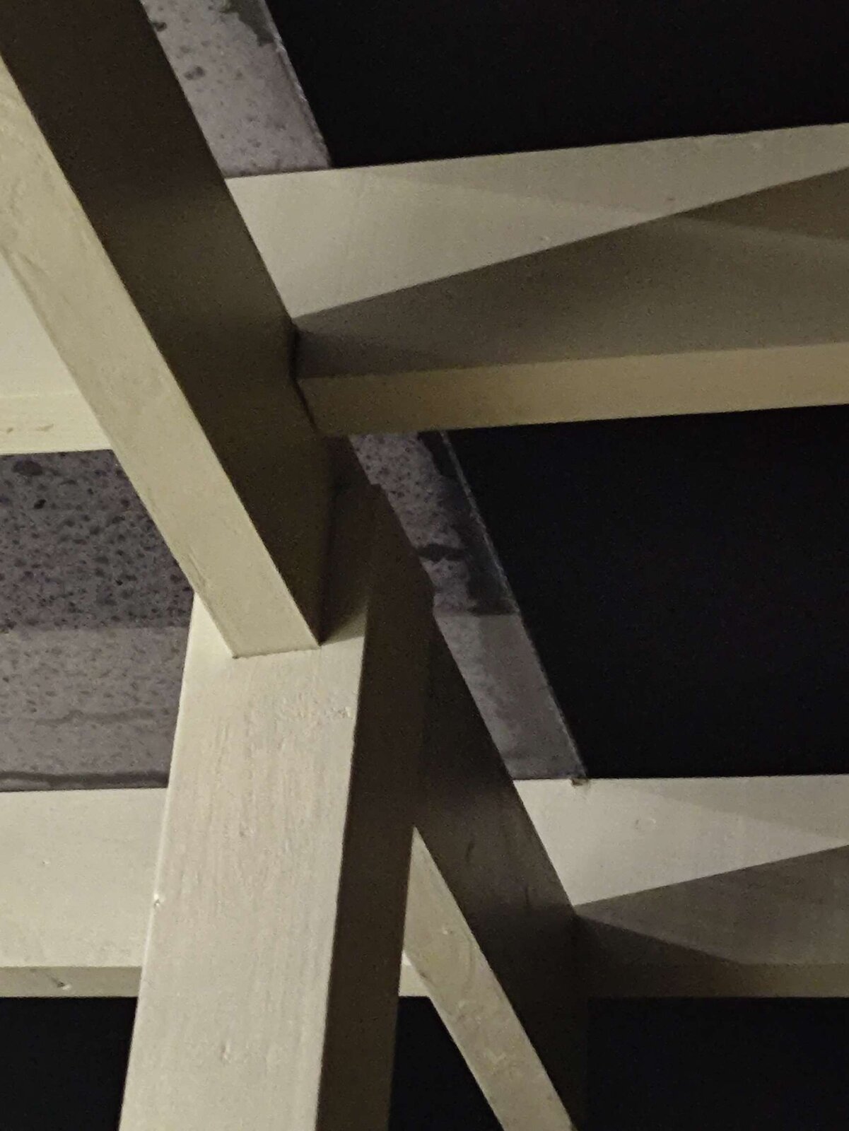

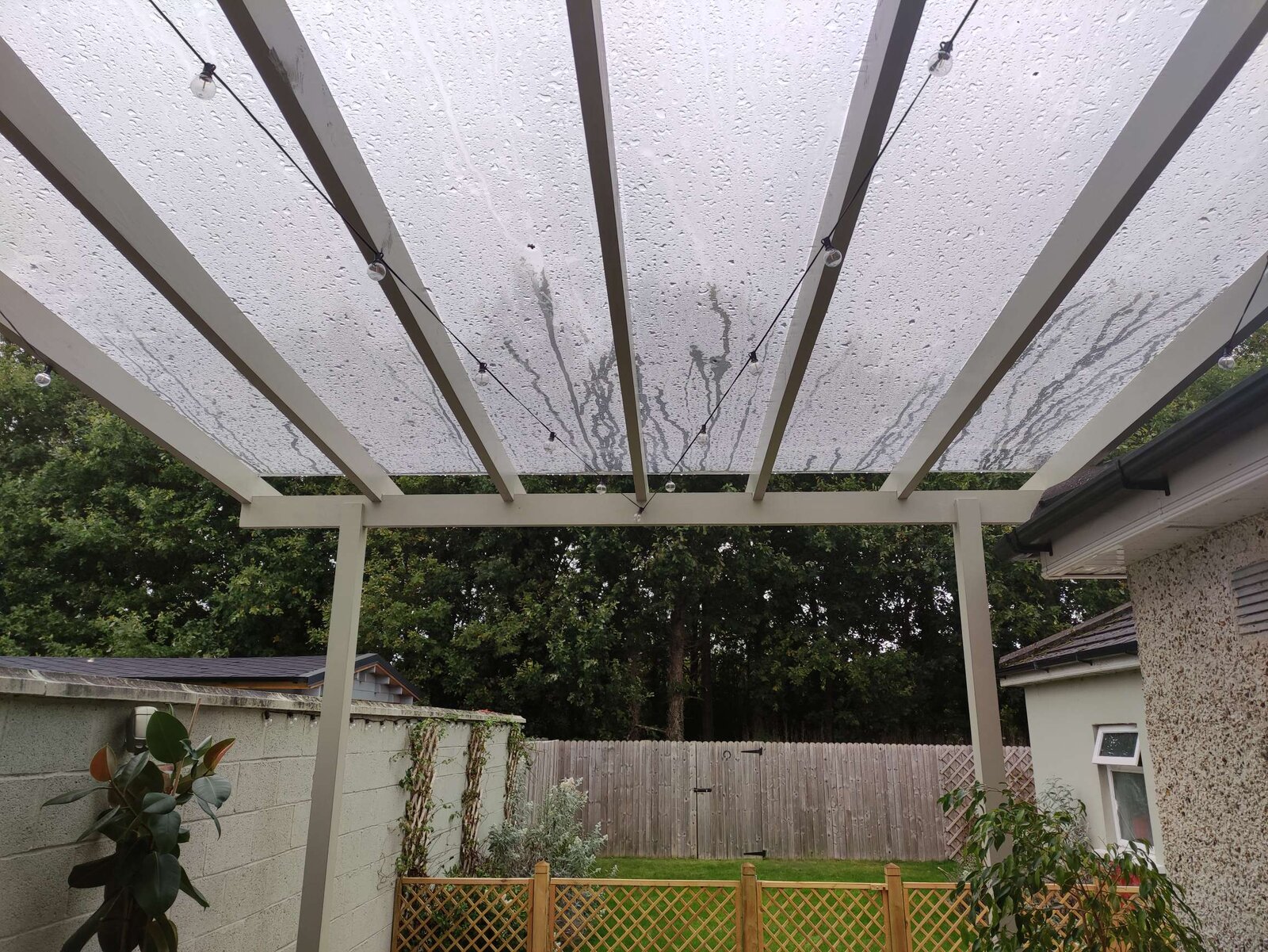

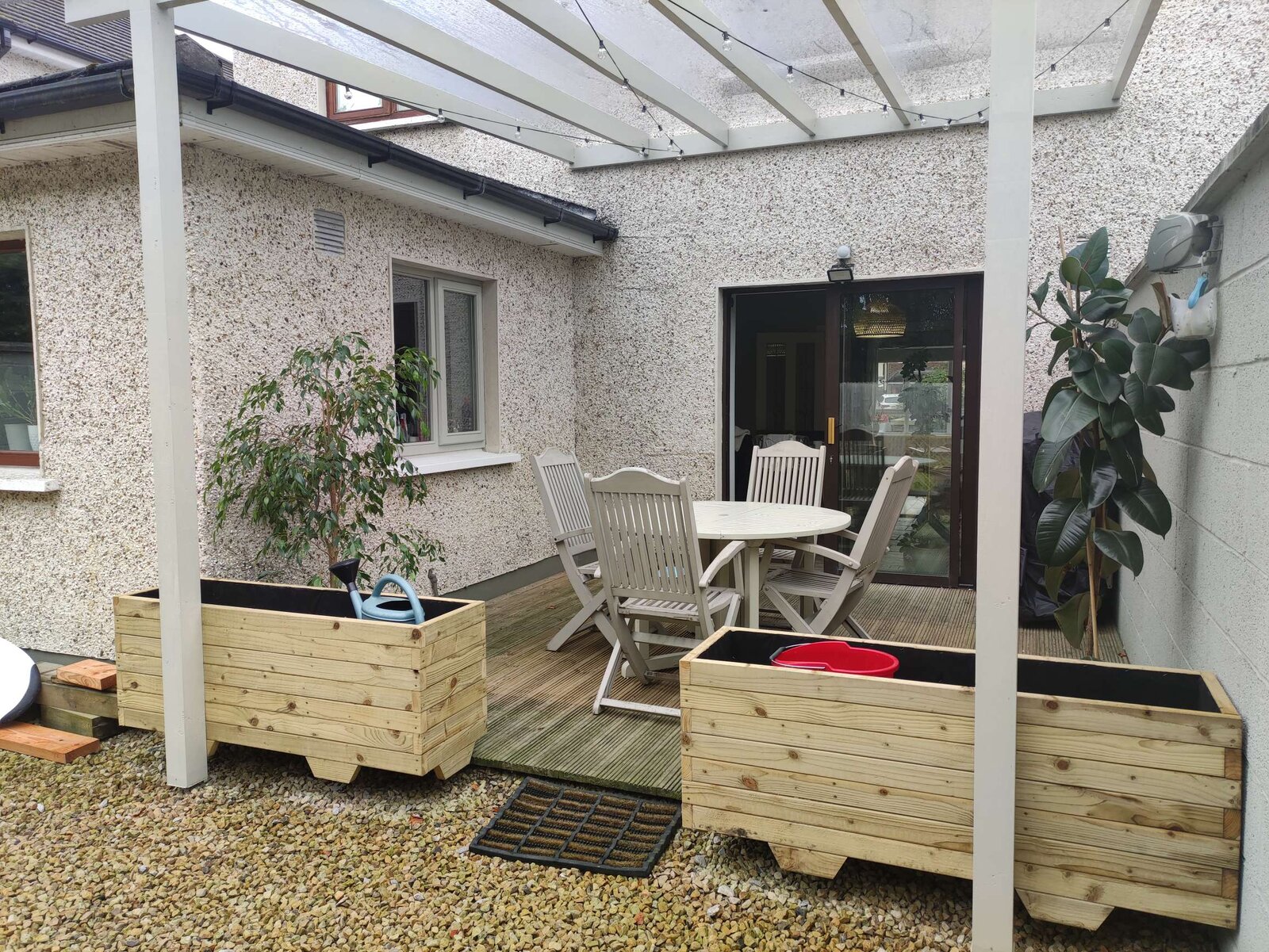

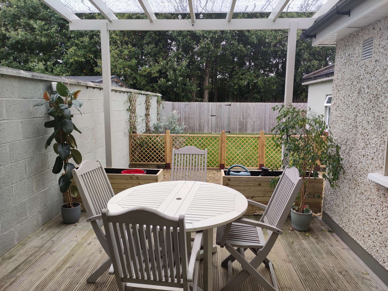

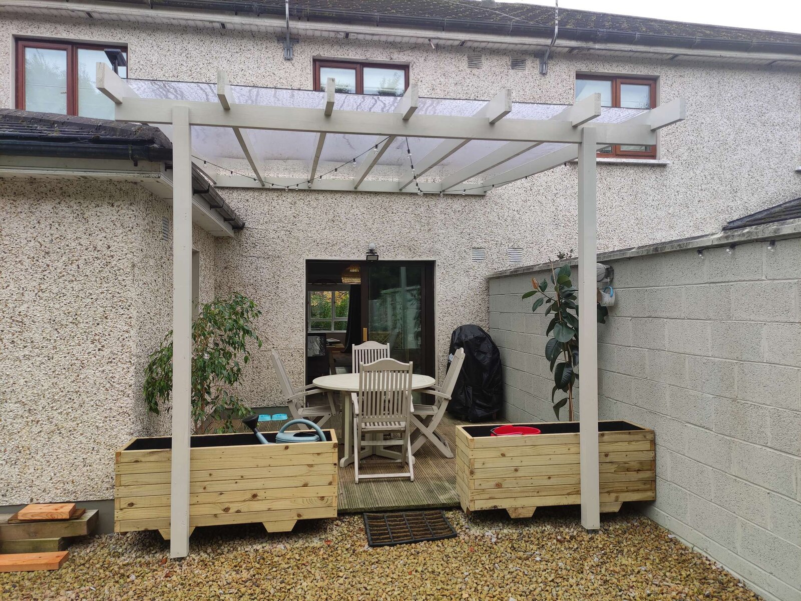

Thanks again for the info Sam. Just to give a bit of feedback to you and anyone else looking to do similar job....

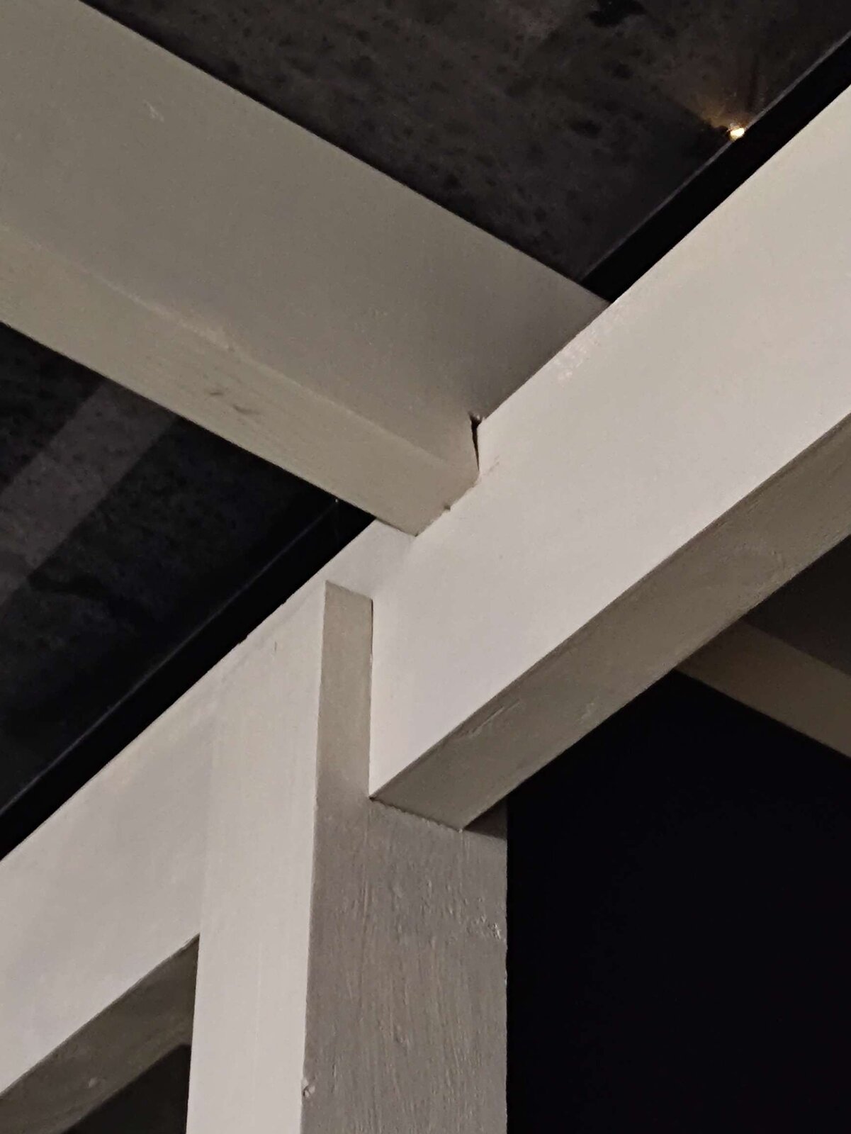

I finished the job - a 4 X 4m lean-to pergola, using 4" posts mounted on poured concrete footings using galvanised 100-150mm Height Adjustable Elevated Post Base Support (Size: 100 x 100mm) https://www.amazon.co.uk/dp/B085BW29NG/ref=cm_sw_r_apan_glt_fabc_R51W1YZT6BF72VHMQS71.
Wallplate/ledger, cross beam and the rafters were all 6x2's. I used larch timber as it's a bit more dense than white/red deal etc. And I had intended oiling it with osmo UV oil, but I felt it looked like a an extension waiting to be finished, so ended up painting it in the end.
I used 7 rafters, so at approx 667mm centres which I think turned out to be plenty close together for the 6mm solid polycarbonate sheets. I reckon 1m spacing might have been too far apart but not by much - they're v solid. I used two sheets each measuring approx 4 X 2 m (manufacturer cut them to exact sizes for me).
As Sam mentioned, it was v difficult to get those v large sheets up onto the 3m high roof, without marking the strong, but somewhat soft and so easily marked, polycarbonate - I made a large holder/frame from transverse 2x2" lengths and then fixed two more, long 2x2" lengths onto the end of the rafters sloping down to the ground - I then slide the frame up that ramp. Then myself and my brother, on ladders, slowly moved the sheets sideways off the holder/frame onto the rafters.
I actually ordered similar foam tape to place on top of the rafters to cushion the poly - but didn't use it in the end and I think it's grand.
To join the two sheets (joint runs down the 15 degree fall, hidden on top of the middle rafter), I just butted the sheets together with a bead of silicon between. Not perfect but the pergola is open to the sides so I don't mind if it's not 100% dry (although no drips so far after a month). Similarly, I just butted the sheets up to the wall over the wallplate. Dry enough for my purposes (there's a big eave/overhang on the house roof so that helps).
Lastly I drilled 9mm holes in the poly and used 6.3x45mm grey Tek roofing screws to fix the sheets to the rafter (Easydrive Timber Roofing Double Slash Point Screws - Screwfix). Oversizing the holes is necessary for the expansion/contraction of the sheets.
And then added some planters and made a small gate to keep our little locked fella in! Thanks again for the info Sam. Good luck to anyone embarking on similar. Pat.

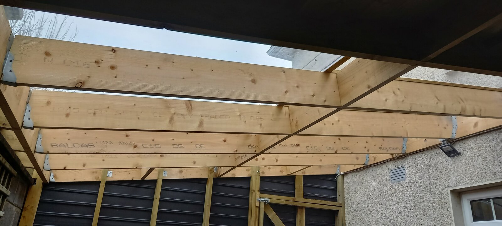

Hi! I know it’s been a while but I wanted to ask how these applications are working for you guys? Anything you’d do different?
I currently have corrugated clear panels and want to replace with solid PolyCarb. Trying to figure out what thickness, size sheets I need and what modifications to my current set up I will need.
I was hoping to have at least 36in width opening (yes, I’m the US. Had to do some converting on these numbers, A little less than a meter) but, after reading your posts, I’m afraid it would sag.
36 inches = 3 feet = 914.4mm. That is wide. Is this an existing structure with timbers at those 3 foot centres ?
Is flat multiwall sheeting an option for you - those spans might be ok with a thick multiwall.
Your supplier should be able to advise.
If you are set on clear poly then I suggest you consider providing additional rafters in between existing to make span a foot and a half.
