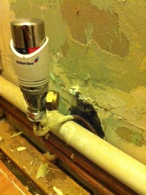

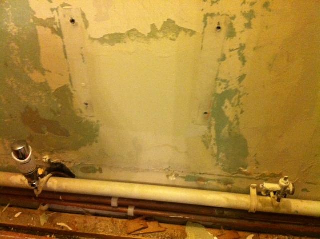

ok, so working on the downstairs cloakroom turned into bit of a mare,
have 8mm microbore pipe for the central heating and need to convert to 15mm to fit a towel rad im planning to put up (or trying to!)
the problem is shown in the photos. i have brought some solder ring fittings with some reducers 8-15mm and some 15mm elbows but by the time i have put them in its going to be way too bulky and due to the direction of the current 8mm pipes going to protrude too much to box in
see the photos for the situation,
any suggestions on how i can do this easier,
are there some kind of flexible solution i can use, or even still an 8mm to 15mm elbow as the current direction of the pipes is gonna give me all kinds of problems
can you not just run it in 8mm and put a reducing olive in the rad valve?

well you would have had to solder onto the 8mm anyway whatever you do, can be hard to make 8mm look neat is the only problem, especially on bends. Can go with compression but be very careful not to overtighten and squash the pipe.
Might risk solder joints, getting better all the time and practise makes perfect... I hope!

Been playing about with some ideas...
How about using a reducer straight into a 15mm street elbow? This would probably just be ok and then can continue with normal elbows until I get to the position I need
Anyone had much experience with these street elbows?
can you not just adjust the pipes to where you need them ? the rad valves you have on there already have 8mm reducers in the valves, you could just undo the bottom nut & the pipe will fit straight into the new valves using the old nuts
I'm not very experienced with this 8mm stuff. Is it a case of carefully bending by hand ? It seems pretty flexible.
I should of said the new towel rad is half the width of the old rad so also need the adjustment there
I take it you are aware that the towel radiator is highly unlikely to provide anything like sufficient heat for the room?
As for the pipework, have you lifted the floorboards to see if there is any sufficient slack or spare which might provide you with what you need to relocate the valves anyway?
In any case, if you are happy to use 15mm then why not do what you have to do above the boards with this, and use a reducer below the floor to join onto the 8mm?
