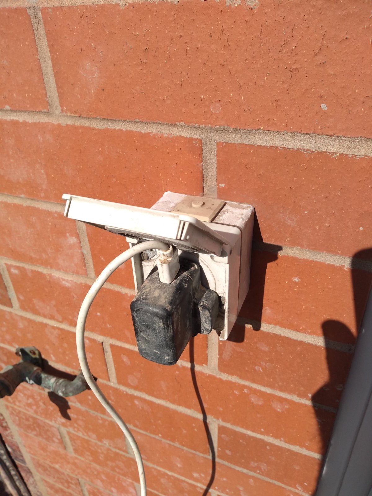

I recently fitted an outside socket outside my attached garage:

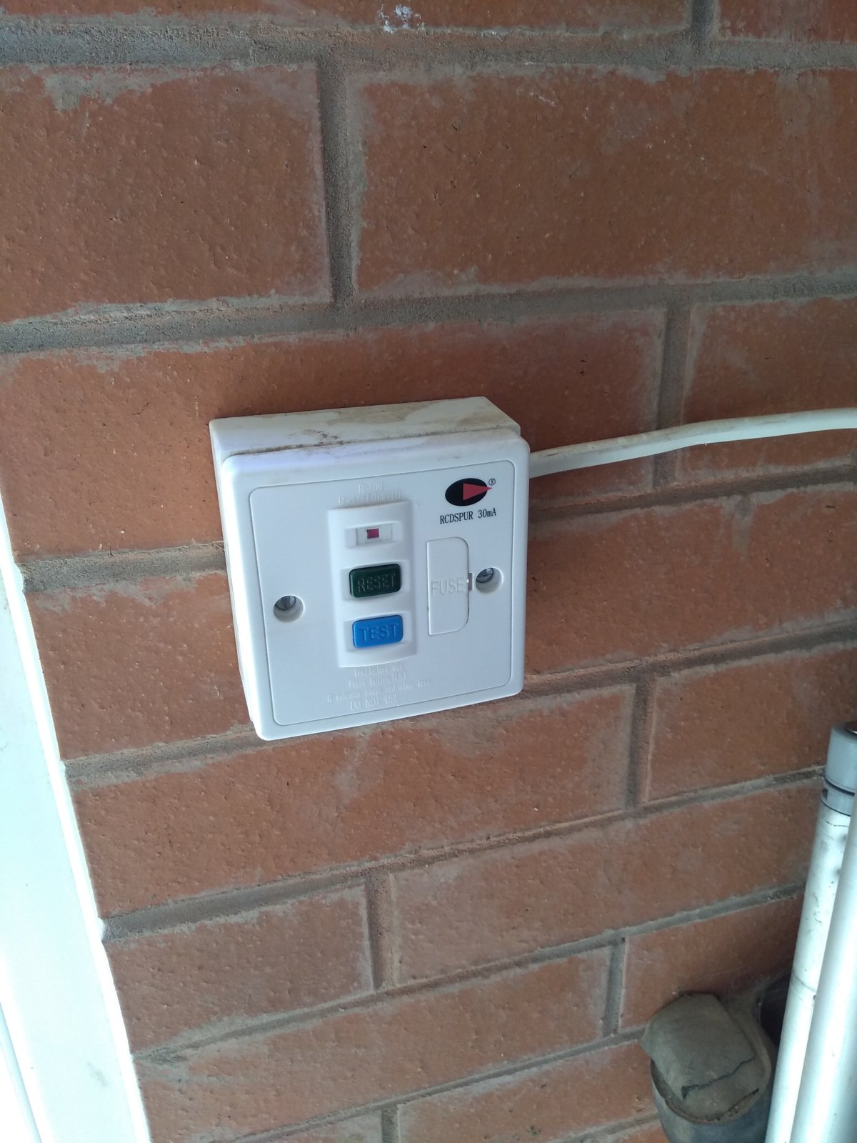

With this RCD on the inside:

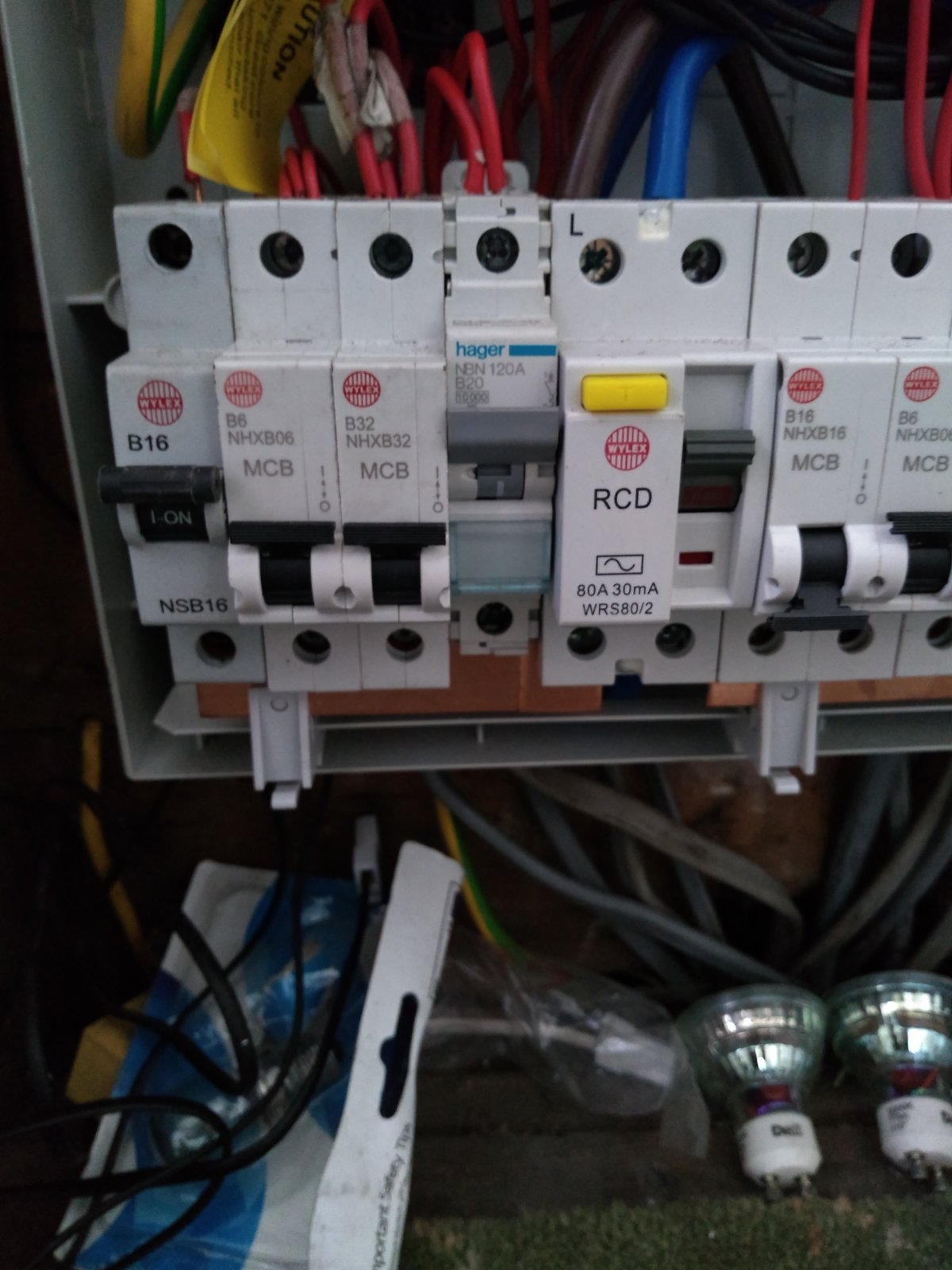

Until now I've run the grinder off the kitchen ring via an extension cable out of the window with no problems. The garage is a 2.5mm radial on a 16amp MCB (only other things on the circuit are 2 small freezers). From the same MCB is another 2.5mm radial feeding my other garage at the top of the garden - I've never had any issues with this setup before.
The grinder attempts to start but trips the main MCB (not the spur). If I plug it into the freezer socket it trips the main MCB. If I plug it in the kitchen it works fine.

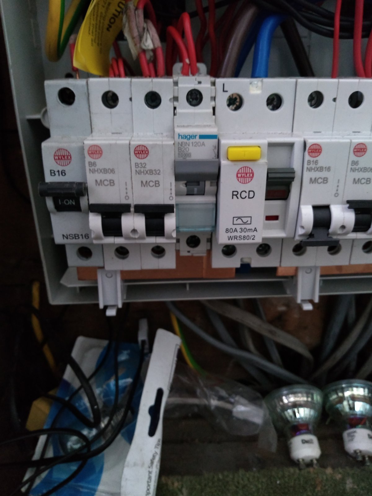

You were right!
Temporarily tried a B20 I had lying around and it works fine:
Unfortunately it's a Hager and doesn't fit my Wylex board but I'll get the correct one next time I see the family electrician.

You shouldn't have temporarily put the wrong device in. Hager must not be used in a Wylex DB.
Oh dear. Anyway I did it, obviously it didn't fit on the bus bar perfectly but it was fine for 2 minutes. Nephew will drop me round a Wylex next week.

For what it's worth, I'm not an electrician but there is bare copper showing on those cables.
Also I HATE seeing mcb's not in sequence. i.e. all 6's at the start, followed by 16's, 20's 32's etc
I agree some circuits may be protected by the RCD whilst others may not but there is no excuse for having them installed in the manner of the picture.
It looks so sloppy.
(And yes I do have 'mild' OCD but I have pride in any work I do as well.)
Surely you would put the highest current value next to the switch to reduced voltage drops and minimise bus bar heating effects.
It's actually better to alternate between heavy and light loads to minimise heating effects. Although it's common practice to start with the highest rating and work your way down, it's actually not the best way.
I would have expected all MCBs at their max loads to have roughly the same rise in temperature. Prepared to be corrected though.
