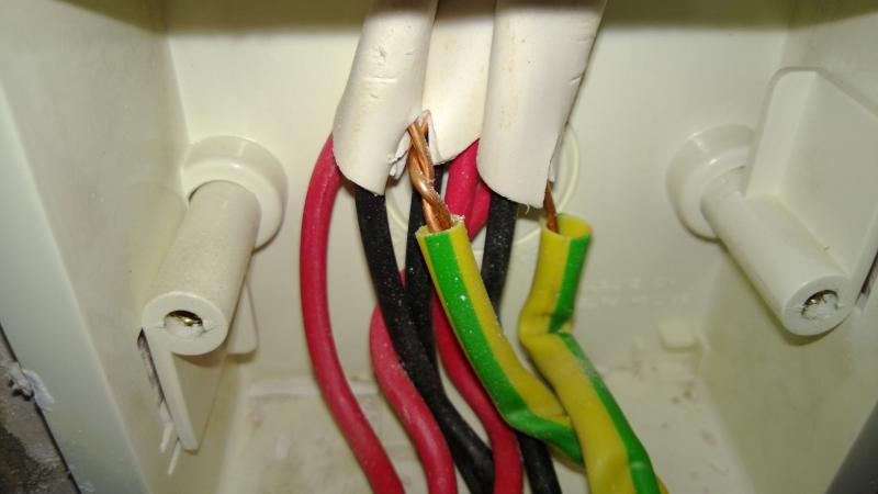

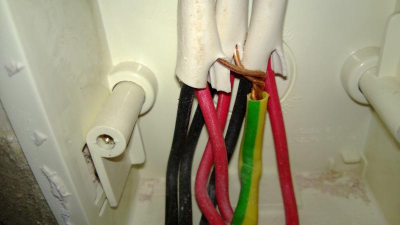

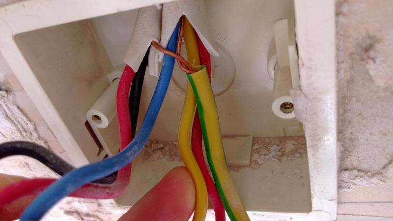

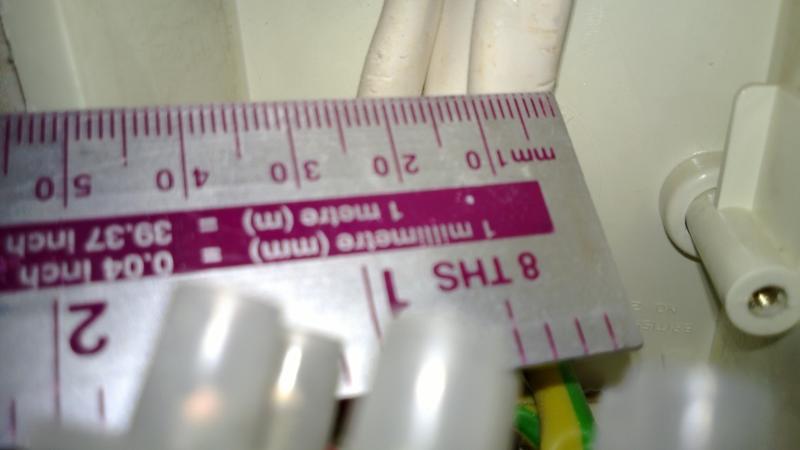

Morning! So here are some better pictures. All wiring seems to be the same size, a flattened white oval shape about 10mm across.

Using a voltage detector, boxes 2 & 3 are live. On my main fusebox is a fuse labelled "sockets" and if I turn this off all of the wall sockets go dead, including these boxes 2 & 3.
Box 1 shows no voltage with the main fuse switched on or off. On an adjacent wall there are under cabinet lights wired into the lighting circuit with their own wall switch, so I tried flicking this on and off but could not detect voltage on box 1.

According to TLC website (new colour cables only) - Three core and earth 1mm ² is 9.8mm diameter while 1.5mm ² is 11.4mm. Which would seem to confirm that box 1 was a lighting circuit- probably two way. This being the main power switch - which means that the strappers (yellow, blue and red) could be linked to another switch somewhere. Not to be replaced with a socket unless certain alterations are made.
Same website also indicates that 2.5mm ² T&E is approximately 10.3mm wide which would be the correct size for a radial or ring final socket circuit.
In this case both box 2 and 3 have the ring/radial final circuit cables and a spur. Given that this is/was a kitchen it may suggest that box 2 and box 3 were fused connection switch/spurs to another socket or appliance - or they were sockets themselves.
Add this to the physical tests you made with the circuits mcb it would suggest that you could make box 2 and 3 sockets.
For a ring final circuit I would expect a 32A Mcb and two lives in the live terminal of the Mcb. Only real way to know though is by testing.
The only other odd thing, which is causing me some doubt, is why the installer hasn't simply run the ring/radial across the boxes instead of apparently running them up to the ceiling and back down again for boxes 2 and 3?

Is that true? your final pic, with the ruler (which I assume is box 1) seems to show the cable on the left as about 7mm and the one on the right as about 10mm. That makes total sense and it seems very probable that there was once a (possibly/probably two-gang) light switch there - although your tests suggest that those cables may no longer be connected to anything.
The other two boxes are clearly part of a live sockets circuit (probably a ring, but possibly a radial), but both have spurs going off to unknown places.
I think box 3 is the close up photograph - the scars on the sheath seem to match.
Indeed - either a 2-gang light switch (one being two-way) or a single 2-way light switch plus a power feed. However, if our assumptions are correct, I can't really see what (practical) "certain alterations" could be made to allow one to to connect a socket to either of those cables. Am I missing something?
