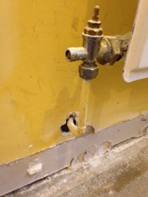

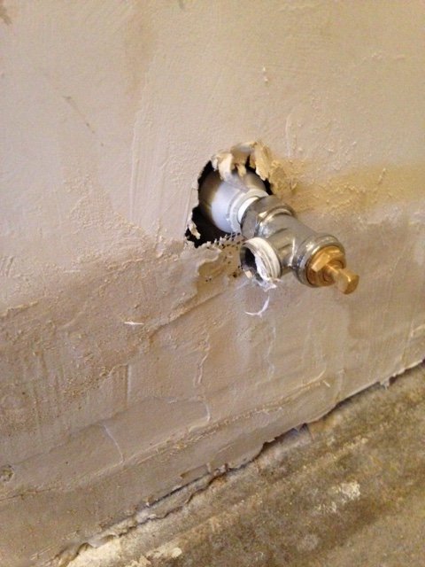

Nortonj, not sure these pics will help but heres a photo of an old rad & valves and another of the pipework i've already adjusted.
Original
adjusted using plastic (wall still needs skimming).
With the plastic fitting in the last photo, make sure it's either locked or a collet clip fitted, some fittings have been known to release with movement (expansion / contraction) pressing on the plaster.
