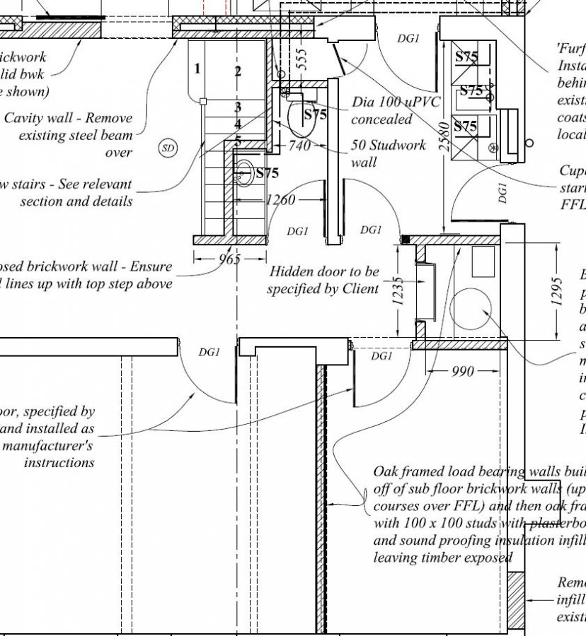

Yes all considered and discounted... plans are below showing what is planned...
we're in an old cottage with lots of woodwork on show and low ceilings, didn't want a door at the end of the corridor so wife agreed to this solution...

They put inset rollers under the bottom edge of some big doors. I think one of those articles the OP linked to mentions it. Being a belt and braces sort, I'd want a brass or stainless curved track in the floor for it to run on. Most flooring is otherwise going to get worn away over time i'd have thought. You do sometimes see that arrangement on older work with large heavy doors. I don't have enough experience on that type of work to know if they are still generally used though. Probably not necessary in this case with the right pivot hinges I'd have thought.
from reading around if you get teh pivot hinge, and bookcase construction right there is no need for any other support, runners or wheels etc... It is sitting between two new dense concrete block walls on a newly laid slab so I'm confident it won't go anywhere if it's built properly. I have also asked our carpenter that did our roof if he might be interested but i suspect it will be a bit fiddly for him...
The issue of weight is paramount to the design of something like this. Even concrete blockwork has limits to what it will support in terms of static and dynamic loading which puts the hinges into the range of specialist commercial products rather than over the counter domestic stuff. Without knowing the loadings you envisage it is difficult to even come up with a design which will work reliably in the long term but you will also have to consider the considerable effort required to open and close a door weighing maybe 200 to 300 kg when fully loaded. This is well within the capabilities of commercial hardware (the biggest gib doors we've ever installed were about 3 metres high and weighed about 350 kg - but the floor boxes were made to order at about £1k). The gib pivot design reduces the physical effort to open the door a little and means that pull-out from wall fixings isn't an issue but it does mean having a strong and stiff our beneath it to carry the considerable weight of these things
As Dave says look for specialised carpentry firms who've done one-off before or alternatively look for a firm in the commercial interior fitout se tor (high end shop, hotel or bar fitters) to find a suitable firm (I know of several in the north but doubt that they'd be willing to entertain job so far away). It's hardly what most cut roof specialists would be in the market to do.
