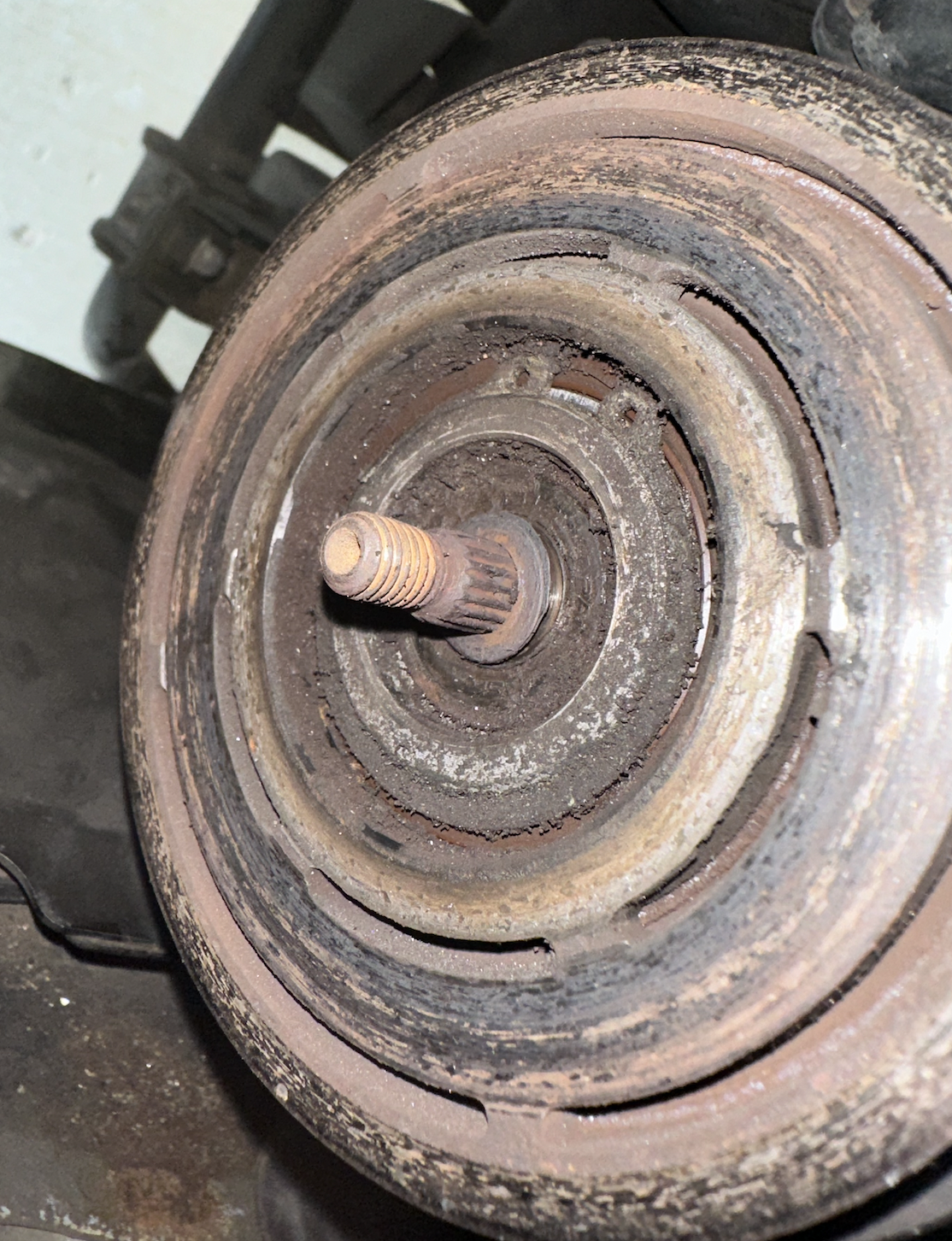

I've got a 1996 Mitsubishi Delica L400 and was hearing some pretty terrible noises from the engine a couple days after my car was in the shop for a different issue. I determined it was the A/C compressor clutch hub plate doing some funky stuff and rubbing against the pulley or something.
I tried remove it to take a look inside, but noticed that it was spinning independently of the shaft, making it impossible for me to take the nut off of the end of the shaft. Instead of taking the nut off, it just rotates the shaft. Normally I see people holding the hub steady to hold the shaft in place while they unscrew the nut but I can't do that since they are spinning independantly.
VIDEO OF HUB
Any ideas what I could do / why this is even happening? I'm trying to learn how to take care of this car without constantly taking it to the shop so any help is super appreciated. Thanks!

Hey all thanks again for the advice and hello from across the pond lol! It took quite a bit of janky solutions but I finally got the compressor into a position where I could fit my impact wrench in and was able to shock that nut off.

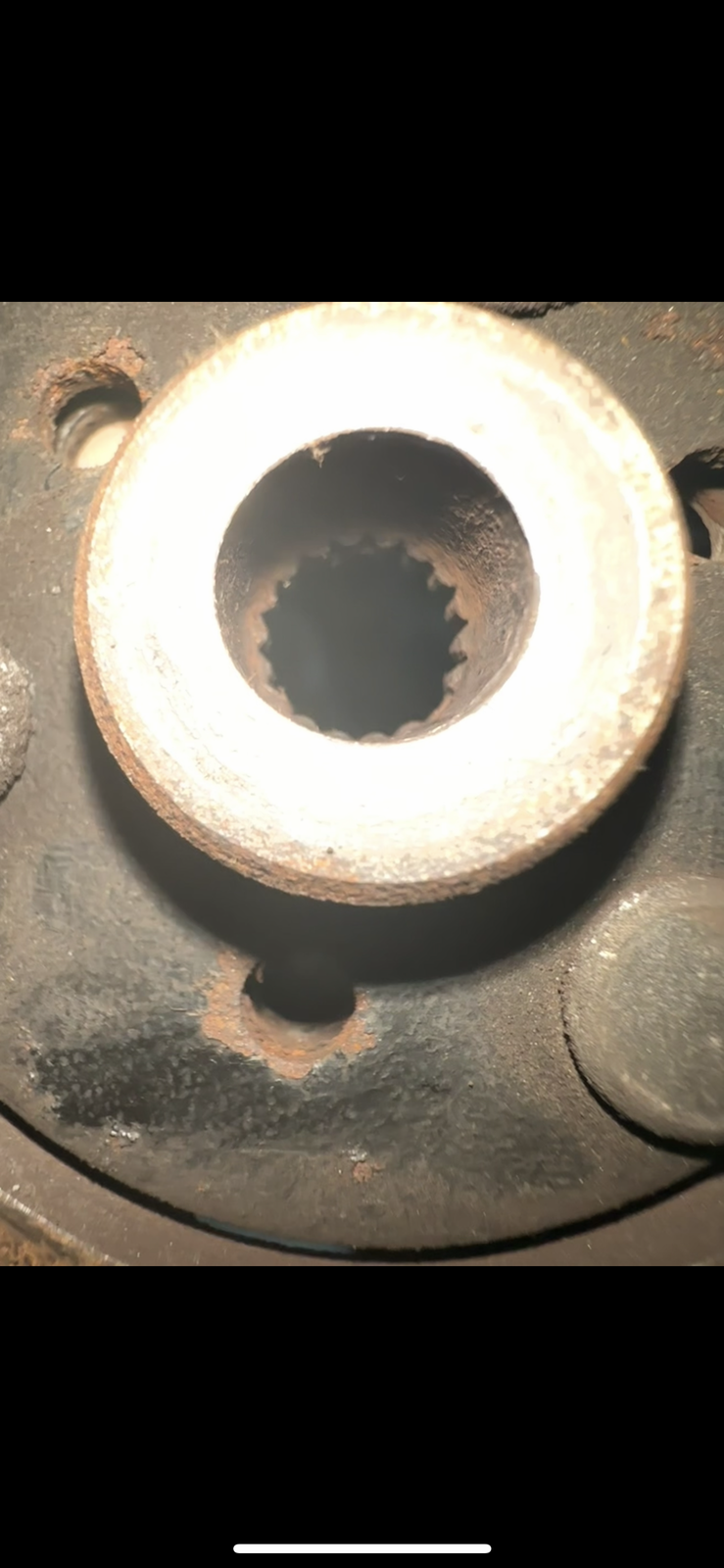

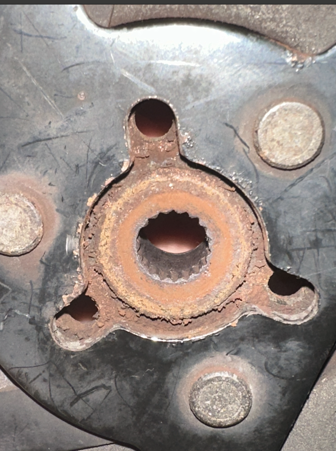

After taking a look at the hub I'm fairly certain the issue is that the teeth on it have been stripped off. Here are some photos:
Hub exterior face
Hub interior face
As you can hopefully see the teeth do not extend all the way to the end of the interior face. I'm assuming this means they were stripped off, but I don't know if they are supposed to go all the way to the end.
The good news is that the compressor shaft itself seems to be in pretty good tact:
Although it does have quite a bit of dirt/debris (is that ok?).

Crikey That's had a hard life! It's not great engineering practice to have the male spline going all the way into the female spline, because you need a bit of clearance to be able to tighten the nut, without running out of thread, but that seems excessive. I'm also curious, (if the nut was tight), how it was able to fail like that? There shouldn't have been any movement between the male and female splines, is the nut was tight.
Is the compressor itself seized? Can you put (I think you call them "vise grips", in America?) on the end of the shaft and turn it reasonably easily by hand? Is the aircon system still holding gas? The shaft doesn't look "wet", which suggests that either it ran out of gas (and lubricating oil) long ago, or the shaft seal is still good. If there is any doubt at all, over the condition of the compressor, it might be better to cut your losses and just replace the whole thing. If you think it's still good, can you get the maker's name and model number off it, and maybe search for electromagnetic clutch assemblies for that make and model of compressor. You might find the outer pulley is wrong (i.e. it is the wrong diameter or has grooves for the wrong type of belt) but you MIGHT be able to make one good one out of the two?

That sounds encouraging then! I am also surprised at the damage to the female splines. There is a process known as "fretting" (or at least, that's the UK English slang for it!) where two mating components move, very slightly, relative to one another, and start to wear. It's a vicious circle, because once the movement starts, any amount of wear increases the gap, so the parts can then "hammer" at each other. You can see that an AC compressor clutch has quite a hard life. It will cut in and out, continuously, every few minutes, as the aircon system demands. Each time that electromagnetic clutch energises, it puts a bit shock load into the spline - especially when driving at higher engine speeds. In effect, it goes from zero RPM to about engine speed in a fraction of a second each time it cuts in! But how that movement started in the first place, is a mystery. The workshop would have had no reason to try and undo the nut on the pulley assembly.
Anyway, I don't think duct tape will work. These are big shock loads. The compressor is likely to require a couple of horsepower to turn it, and, as mentioned, when you switch the AC on, the belt needs to accelerate the compressor up to engine speed in a fraction of a second. To be honest, I can't think of anything that would withstand that kind of loading, other than hardened steel. Maybe some off that "chemical metal" stuff (an epoxy with metal powder in it), might stand a chance, but it's messy and you'll have to then try to clean the remains of it off the spline when you come to fit the new assembly. Personally, I wouldn't bother.
