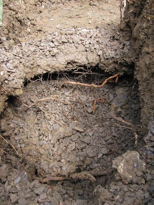

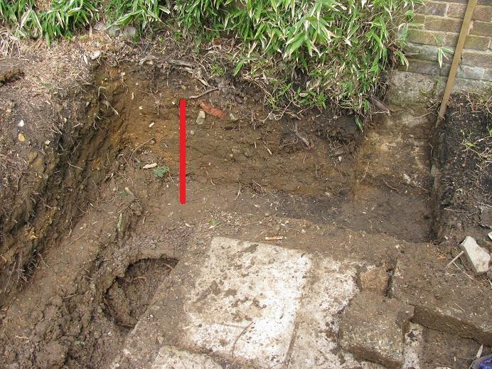

I've been digging the foundation trench for my retaining wall, and I seem to have come across a large pocket of loose agrigate. My soil is heavy clay.
I first noticed it knockling the marking stakes in (shown in red). One just didn't stop going in, and easily pulled out. On further digging, I started lifting out this agrigate. It extends some way under the patio to the side. but I've no idea how much.
What could this be? Builders waste? a soakaway (under where we used to have ponds)? There were a couple of concrete blocks dumped over the top.
And more importantly, what should I do about it? I could dig down a few inches and cover up with clay and lay ontop of it. or douse it with cement and let it harden. Or, do I have to remove it all to make a stable base?

Just to get the ball rolling as no one else has, if all it is is gravel I'd remove it and refill the void with MOT1 compacted in layers. Often when bad advice is given (like this may well be :oops:) the regulars in the know will correctly advise, hopefully! Or they'll confirm it as good advice. :p
Check where your roof drainage points.. as others have said sounds alot like a soakaway..
If its not a huge soft spot (so less than a metre or so) then you can probably bridge it with some reinforcement in the bottom of the footing.. just make sure the ground each side is pretty solid..
I'm going to be laying 2 lengths of rebar in the foundations throughout the entire footing. My house drainage is nowhere near it, however there is a garage block backing onto it that it could be.

Pretty sure i said put some rebar in the bottom of the footing over the soft spot to bridge it.. 3-4 x 10mm bars in the bottom, extending 1m beyond the patch each side should be plenty..

Anyway, cheers for that, I'll reinforce the corner and stick weep holes in. I assume I'll still need the waterproof membrane at the back.
Also, the trees are now gone with the exception of the fig.
DPM (either a sheet or black jack painted on the rear) is a better way to go, without one water will leach through the wall and cause stains to appear (normally brown ones).. and a weep holes about every 1.5m or so..
