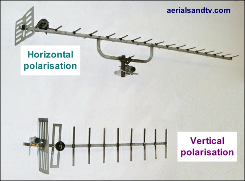

Hi all.
I live in a 2 bedroom terraced house in west london.
The aerial on the chimney is the cheapo Yagi Uda type- the ones where the horizontal bars seem to be equidistant and then a plate with slots at 90 degrees at the end. From there I have CT100 cable that runs in to the attic- at a guess about 3m.
In the attic there used to be a powered amplifier with two outputs. There are a total of 4 devices running off the aerial, 3 tellys and I radio.

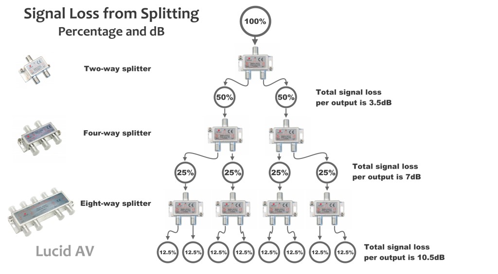

During the lock down I decided to buy a proper F Type tool and plugs and a basic 6 way splitter. I naively thought that I could do away with the amplified unit and use the passive splitter. I soon discovered that without the amp I could only power one telly and that as soon as I did so the signal on the first telly I tried dropped from 75% signal strength when using a straight female F type in to the feed to 48% when using the passive F-type splitter. In both cases the signal quality remained 100%. The next TV I tried (master bedroom), with the first TV removed from the equation only had 32% signal and 74% quality when using the female direct in to the feed, as soon as I plugged it into the splitter it went to 40% signal and zero quality. That telly however is a bit of a Frankenstein, the feed runs down to the B&0 telly down stairs and then runs up to the tv in the bedroom which is also a B&O. The coax from the telly down stairs sends whatever is on the telly down stairs up to the tv in the master bedroom via a digi box and the other functions are sent via a B&O masterlink cable.
The third telly is in the kitchen. All have CT100 cable running to them. The B&0 radio/cd player has an old coax.
All worked until recently until the 20 year old powered amplified unit died. I picked up a new one from toolstation today and additionally picked up a masthead amplifier. I have only installed the in loft unit thus far. Everthing is working but I am guessing that some channels will still pixelate (as they did previously). I will fit the masthead amplifier but I need to wait until I pick up the roof/apex conversion kit for my ladder.
The one I picked up has 4 outputs. My (lay) understanding is that I need to fit it with in 1m of the aerial. I am happy to do that, but before opening the box I would like some advice. Should I get a better aerial and return the masthead amplier or if I stick with the MA should I extend the cables to meet it and ditch the cheap powered amplifier.
Will the MA and powered amp potentially cause problems? Should I use the MA with just one output and the powered amp?

From your description, it sounds a bit like you have contract aerial. This could be a digital era aerial, or something that was installed when we just had analogue but it still works okay today; lots do. These may not be exactly what your aerial looks like, but something along these lines.
Contract aerials are mostly about keeping the cost down, so they sacrifice some performance in order to achieve a lower price. They work, but don't generate as much signal power as you get with a good alternative. Since quality is a measure of the gap between signal level and background noise, then the more signal that the aerial can pull in compared to the baseline of background noise then the better the quality measure.

The point about Group A aerials is they're excellent at reception within their band, but they're not so good outside of their range. This could be one reason why some channels are pixelating.
For much of the past thirty-five years or so, CP has used frequency channels 22 to 34. That was a good match for Group A aerials which are recommended to cover channels 21~37. What changed was the start of the channel shuffling to allow the sell-off some of the TV channel range for 4G mobile telecoms use. In the case of CP, there were some additional channels allocated at c55 and c56. These are transmissions where the TV needs to have an HD tuner, so they won't show up on a TV that has just a Freeview SD tuner. However, if the TV is properly equipped, and the aerial you have is a Group A aerial, then even despite the transmission power of CP, I would expect you to struggle to get good signal for these channels. They're only temporary too. In fact, the one on c56 has already been switched off (June 30th, 2020).

You'll also lose signal strength through cable. CT100 is decent coax if it's the genuine stuff with a copper core and copper foil + braid shield, but like any coax, there's always some loss. With WF100 and CT100 in good condition you'll see a loss of 0.15dB per metre, and so every 10m sees the signal drop by -1.5dB.
Connections will lose something too. Figure on about -0.25~0.5dB each.
Two-way splitters will reduce the signal by half per output (-3dB) plus an extra -0.5dB for the insertion loss.
All of the above though is passive reductions. This means that the signal strength is reduced, but there's no increase in the noise. If signal quality is 100% to start with, then all else being equal, it will still be 100% after the losses.
It sounds dramatic to say that you lose half the signal (and a bit more) simply by splitting two-ways, but RF signals are resilient to these kinds of losses. Most TVs will do just fine with a signal level of 50dB at the aerial input, and so it's possible to add up the combined effect of all the losses in the signal chain to work back to a target level for signal at the aerial. For somewhere with a high field strength from the transmitter, plus using a high-gain aerial fed directly in to a TV, they could well end up with too much signal.
Active splitting and amplification both add loudness and noise to the signal. Sometimes you have to accept that, but I think in your situation the masthead amp would be OTT.
All amplifiers and active splitters add their own noise to the signal. This has an effect of reducing the gap between the background noise and the signal level itself. Since this signal-to-noise ratio (SNR) is what determines the Quality measure, then anything that reduces the SNR also reduces the quality. Once that is chipped away, there's no way to get it back. The addition amplification increases both the signal level and the background noise by the same amount, so you end up with a louder but noisier signal.
The amplification is there mainly to compensate for the losses in the signal cable from the amp to the TVs. For this reason, any active amplification goes as close to the aerial as possible; hence why we have masthead amps and active signal splitters in the loft. This is the opposite of best practise for passive splitting. They work best where the signal is left to the latest possible moment before splitting. For this reason, passive splitter are best used closest to the TVs.

(TL;DR) To recap then, I would change the TV aerial. I wouldn't fit any amplification at all. Use a passive splitter instead. Add an FM aerial and combine the signal with the TV feed before passive splitting.
