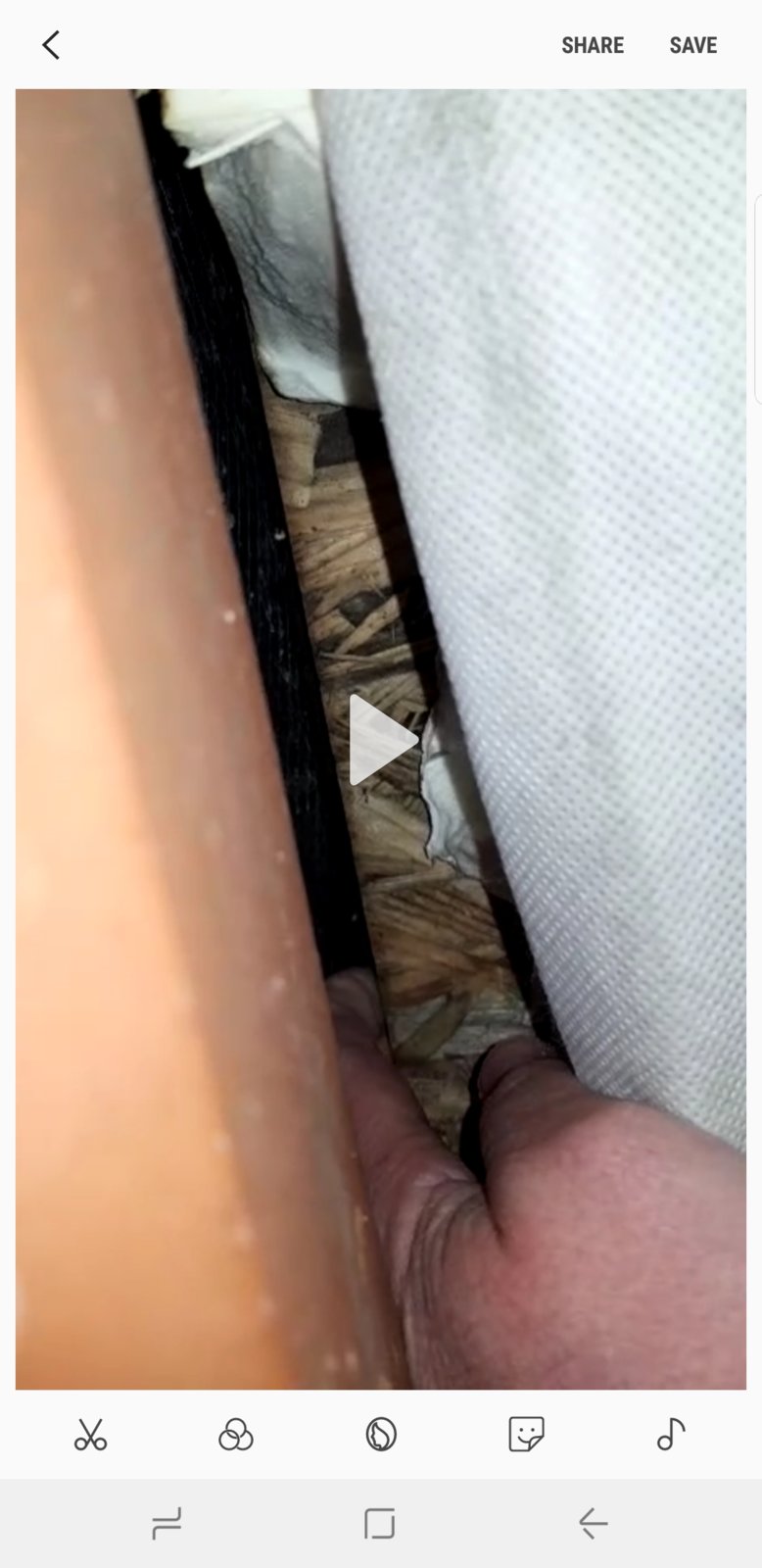

I built a two storey oak framed extension which was erected end sept last year. The frame and panels were exposed for two months of weather before the roof going on (Mid Nov). It was plaster boarded and plastered in February this year.
The extension compromises of an oak frame skeleton with a timber frame encapsulation for my walls.
The panel compromises of (Inside to outside);
12mm Plasterboard
VCL
38x89 studs, soleplates and wall plates.
50mm Kingspan within the studs top to bottom.
12mm OSB
75mm Kingspan
Breather membrane
47x72 studs
Larch feather edge cladding
The panel itself is sat on block work on top of DPM which is running underneath into cavity.
There is then a canted brick on exterior wall 3 bricks high where I have lead flashing running back to meet breather membrane of the wall panel. This is effectively capping cavity, should this return to 47x72 studs only??
The problem I'm getting is a smell on one wall only of damp/wet wood/dirt. From the soleplates the smell is worse. There is no water getting into the extension or no sign of any leaks. The smell is only on the ground floor, its become worse since we've had more rain.
I have inspected the wall internally by removing the skirting board and cutting away some plasterboard and there is no sign of water ingress. But I cant see a great deal to be honest.

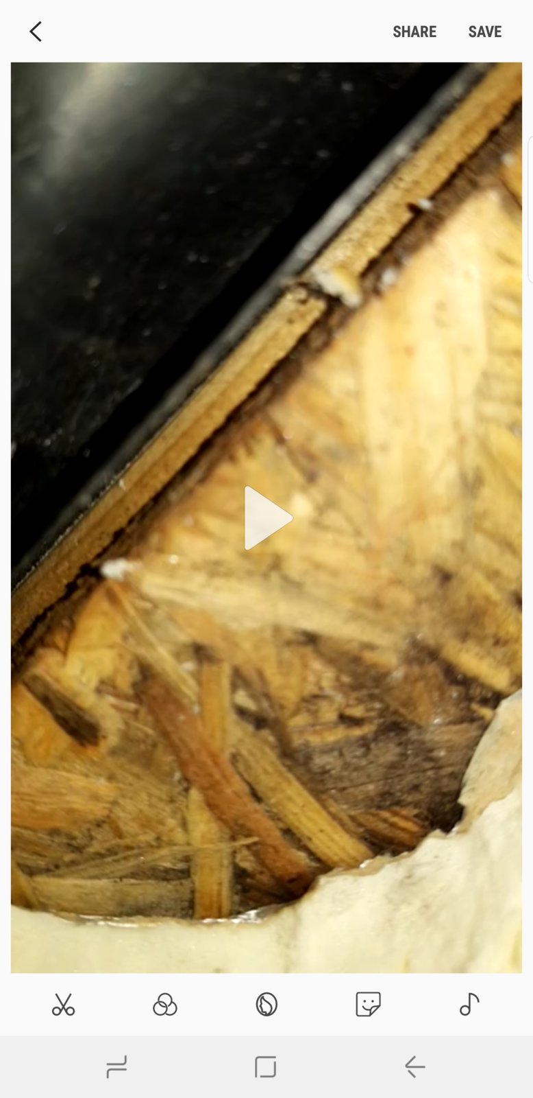

On the exterior I have removed the bottom featheredge board and lead flashing to look into cavity etc. I have peeled up the membrane and cut away a small amount of the 75mm Kingspan. Behind this is where I have found the OSB to be dampish and it smells just like the described smell above, it looks slightly black as well. I can only see approx 30mm high as I don't want to go cutting away more insulation. The Kingspan is dry also.
The elevation concerned takes a fair amount of stick when it rains as its an open area with no protection from the existing house or and surrounding buildings.
Building regs have signed all of my work of as well and were happy with everything they saw.
I am completely unsure of the problem here as I keep reading different things on the internet and also thinking the worse case scenario. Condensation? Water leak? Not enough ventilation within cavity as lead returns to breather paper capping cavity possibly or maybe the osb has got wet from before cladding and roof went on.
Can anyone shed any light on my problem please. Sorry if it isn't explained well enough. I can add a few photos if needed.
Many thanks

The osb sits over the cavity. Along with the 75mm insulation. I have attached two photos, they are spaced 300mm apart. Not the best im afraid.
Should the cavity be ventilated??
Hopefully it will give you an idea.

As Notch7 said you have insulation both sides of the OSB.
I am no expert on this method of construction but i am quite sure the Breather Membrane should be over the OSB and the 75mm of Kingspan shouldn't be there at all.
Also you have used 89mm studs and filled with 50mm Kingspan.. Does the 50mm Kingspan sit up against the OSB or the VCL? Because if the 50mm Kingspan sits against the VCL then you have created an AirGap/Cold Spot between the Kingspan and OSB where condensation will form and could cause your problem.
