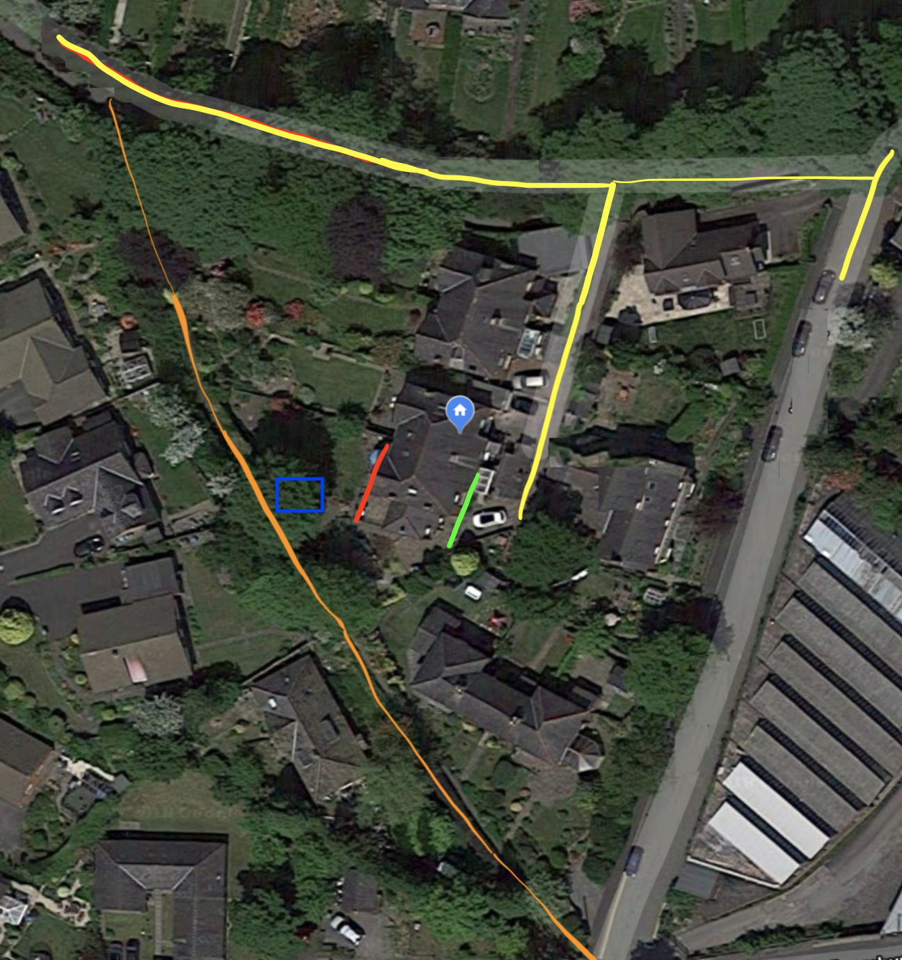

I would like to build a shed (log cabin) in my garden, and would like to ask your opinion on it's placement. The house as we use it (same for all 4 houses in the street), is pretty much back to front, i.e. road access is via the rear, primary access and post delivered at the rear.
The traditional "front" of the house is not used that way for all practical purposes, with that door only being opened onto the front garden on summer days. There is a public footpath going past the front of the house however as the council don't maintain it, its our responsibility (cuts through our land on the deeds).
My question is where would the Principal elevation of the house be based on this? I have attached a map to explain things a bit better.
Key:
Yellow - road/highway
Orange - public path/right of way
Blue - proposed site of shed
Red - traditional 'front' of property
Green - traditional 'rear' of property, though hopefully legal Principal Elevation
Any thoughts appreciated.

I would like to think that your proposed shed sits in the rear garden.
The main access road and all the cars park at the 'front' and you and your neighbouring properties share amenity space to the 'rear'
It's pretty tough though, without knowing the area and getting the feel for it, also seeing the front and rear elevations of the properties may make a difference. When were the properties built? Has anyone else got any other outbuildings in the 'rear' of their gardens? Has anyone nearby applied for planning permission for any "front" or "rear" extensions? These would all help give a more informed opinion.
You could get a definitive view from the Local Planning Department for £103 by submitting a lawful development certificate for a proposed rear outbuilding and letting them do the work for you and have something tangible at the end of it. May be pertinent in this case unless you feel comfortable with going ahead.

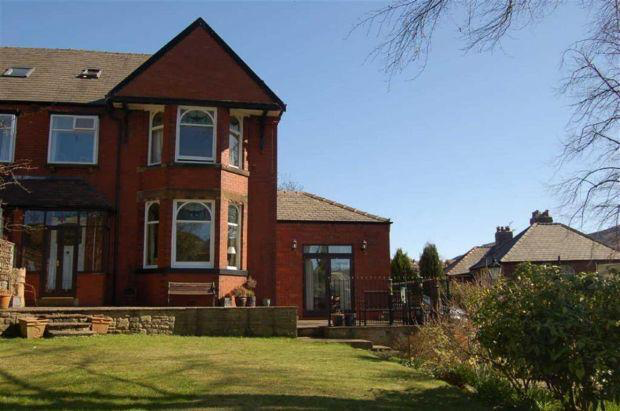

A nearby house currently for sale, to all intents is the same setup as ours. The most commonly used entrance where mail is delivered etc is in frame 1, whereas what would be the traditional "frontage" is frame 6, though not used for day to day purposes.So hoping to be able to prove that frame 1 is principal.
https://www.rightmove.co.uk/property-for-sale/property-75791714.html
There are a couple of other houses of this type with sheds in the 'rear' garden (i.e. what looks like the front if you just saw a picture of it without the usage context). Gosh it's confusing :D

That house you posted a link to is debatable. There's been a few bits of case law on this (one where properties were close to a river and they referred back to the old Ordnance Survey maps at appeal) but I can't recall the sites off my head. I don't like the fact the doorbell is at the 'rear' I still favour the rear being where your outbuilding is proposed, but I can definitely see arguments that prove that wrong.
I think a deciding factor is going to be around vehicular and pedestrian movements to and from the property. Put a sign up saying "All post to be delivered to the principle elevation (the other side)" refit the door bell and letter box, put some kids toys in the 'rear' garden and invite the planning officer, woody et al. during the application stage might ensure the decision goes in your favour.

All post is currently delivered to the side that I hope is considered as the principal elevation, as is the normal entrance for residents and visitors, vehicular access etc. Bins etc are also there. The proposed site for the outbuilding is much more private, we would place the sun loungers, garden furniture, swingball, paddling pool and bbq there in the summer, and there are benches there year round. It is very private - 95% hidden from the public path by 7ft hedge, with only a small gate leading onto the path. For all purposes it is our "back" garden, even though to look at both faces of the house it probably looks more like a traditional 'front garden' in that the bay windows are there. On the left of the attached photo is the door we very seldom use, minus any doorbell or letterbox.
