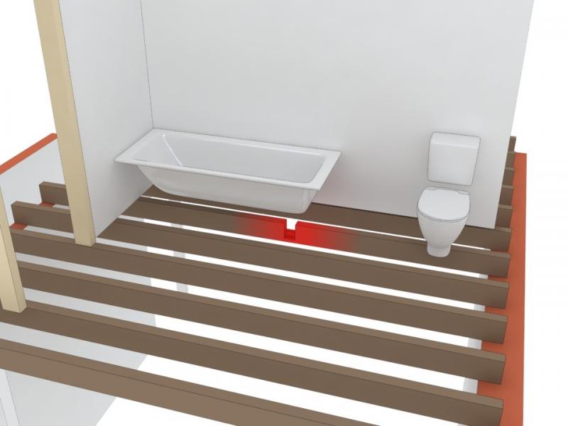

Relevant area in 3D to scale, easier to see the situation

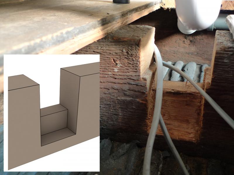

1st floor Bathroom joist notched to accommodate a deep trap on bath waste, not an uncommon issue I gather. 100yr old terrace, the original large rear 1st floor single room subdivided back in the days of plaster & lath to create two smaller rooms, one being the bathroom. History unknown but estimated age of sanitaryware just removed including the problem bath trap, 30-40 years - so I assume the joist's been in this state for at least that long.
Joists:
7"x3"; spacing 390mm centres, span: 4m, passing under stud wall 1m from one end
Damage:
95mm wide x approx 80% of cross-section removed.
Approximate centre of 4m span
Timber otherwise sound & dry
Loading:
Under bath inline with centre of bath, so subject to fluctuating loads. Also inline with the toilet base, not to mention a pedestal basin (not shown) between bath and toilet - and I was surprised at how heavy that was, when I pulled it out. All in all, a fair bit of weight bearing down, although some of it is distributed across adjoining joists via the floorboards. Stud wall across joist may be helping to support it.

I'm not entirely convinced & for peace of mind alone would rather do something about it now, while the bathroom's apart and empty and the opportunity is available. It might have been like this for decades without much drama but obviously it's structural vandalism and in the worst possible place along the joist; every time I took a bath I'd never quite be able to stop contemplating a sudden unplanned trip to the ground floor at 9.81m/s² in a sort of low-budget log flume simulation.

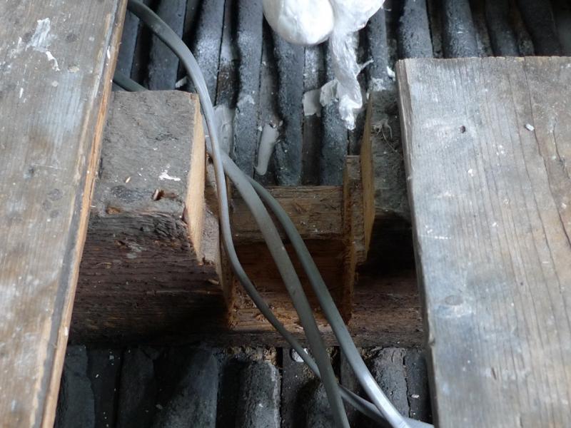

Access to the rear (as viewed in the 3D image) of the joist is poor (plumbing)
Apart from lifting some boards I'm clear on the front face to apply reinforcement, no pipes/cable to contend with. New trap's well clear of the floor, ironically.

The difficult [rear] face is free to one side of the notch, but on the other side I can only go about 160mm clear before I run into plumbing and extra timberwork which was added to support the pipework, so unfortunately a reinforcing plate wouldn't do a lot of good that side.
Where rear access is a problem I was considering coach screws through the front as opposed to coach bolts for those areas.

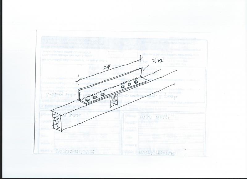

Mark;
If the notch is under the bath, could you do something like this?
A piece of well-bolted steel angle would transfer the compressive force across the notch.
Perhaps move the bath nearer to the wc if needs be?
Perhaps raise the joist until it has a much deflection as some of the distant joists, bolt a plate to the bottom surface under the notch, fill the notch with wood (probably with the grain aligned at right angles to the joist grain) and then lower the joist
which now puts the bottom plate and the remaining wood in tension (like the bottom fibers of the other joists) and puts the added wood in compression.

@ Tony - many thanks for taking the trouble to sketch that idea, simple=elegant compared with my own side reinforcement. The notch is indeed under the bath; I've 300mm to the right to play with remaining in the bath's 'footprint', to the left it'd foul the one floorboard I'd need to keep for the bath feet, but that could be worked around.
I like it, worth some thought. Get where you're at re: resisting the compressive force on the top of the beam, it's a shame the ceiling prevents adding an equivalent flange along the bottom of the beam to conteract the corresponding tension.
