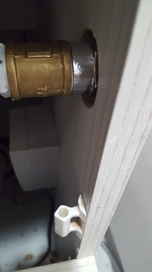

a very slow dripping from joint. how to fix it. Can't be tightened
2 May 2016
77
2
There is drop of water dripping every 10 minutes from a joint between socket and valve. (as shown in the picture).
This was put in place using ptfe tape and tightened to the end. It cannot be tightened any further or remove and refitted with more tape etc.
I believe the leak is so small that it can be repaired by putting some sort of putty / solvent on the joint to contain it within. I am not sure which one though.
Any recommendation on how to fix it.

Pity the photo does not indicate what the pipe is used for.
So why can it not be taken apart?
Surely to make it then it must have been apart then?
Looks very new too.
it was quite difficult to put it in place to attach the douche kit's valve with wooden unit. This involved female coupler to tighten the valve against unit,
then a socket attached to a coupler's thread (this is where a slow leak is) and then flexible hose is connected to other end of socket.
the accessibility was difficult and if it can be fixed by putting a putty seal, that would be much more preferrable than taking it apart and may end up messing with whole in wooden unit. Job was done yesterday so yes it is new :)

Unfortunately you will be hard pushed to make any kind of permanent seal where a fitting is always wet and passing. If at all possible, split and remake.
In toolstation, I have seen "Evo-stik Plumber's mait" with description - A waterproof non setting putty ideal for sealing spigot and socket joints in sanitary fittings. Will adhere to metal, pcv, vitreous enabels and ceramics.
They cannot provide any advice or help of course... but this sounds the thing to apply to fix dripping? Any one used it before?
Plumbers mait is not a jointing paste, and will not do what you want to do. Remake the joint.
stop faffing about looking for a quick fix. Staff at tool station hand boxes over the counter and stamp 'collected' on receipts and can't give plumbing advice. Funny thing is all the plumbers that have answered here have told you how to fix it and you are ignoring them.
