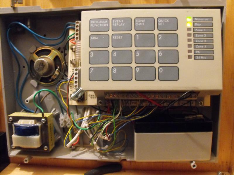

The keypad on my AJ600 alarm is dead. Both fuses are intact, mains are connected, the battery is producing just over 14v when disconnected. When I removed the front cover of the panel the tamper alarm didn't sound. Has anyone any ideas to help please?
If you put your code in or the factory code do any LEDs change ie tamper or panic.
if they do then the speaker fuse has blown or the resistor connected to the speaker has become detached, probably due to a power cut.(the resistor can be resoldered back on again)
if the LEDs dont change then power the panel down mains and battery and power back up again, you need to use the factory code to stop the panel on power-up.
as alaways please be careful as there is live mains inside the panel.
Thank you for that. However the keypad is dead - I can push buttons as much as I like but nothing happens.
as above then you need to power the system down and reboot it.
another note are the buttons rubberised or flat like a membrane.
if they are rubberised then you have an AJ600N which needs a NVM reset.
post a picture of the panel.
Ok its a AJ600 and very old probably one of the last ones manufactured as there is no resistor on the speaker.
if you did the power down and the speaker fuse is ok and still nothing then maybe time for a new panel.
google/ebay Honeywell optima gen4 its probably the closest in size and shape and will be a straight swap out.

I got round to powering down today and the system has reset - thanks REDSPARKY. I'm going to replace the panel as suggested and thought I'd better replace the external alarm as well as they are the same age. Do I just have to put up with the external alarm sounding when I take the cover off? The battery and sounder are a sealed unit I think. I suppose I could just smash the sealed unit open and cut the connections asap as the external alarm is to be replaced anyway.
