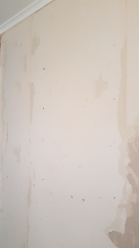

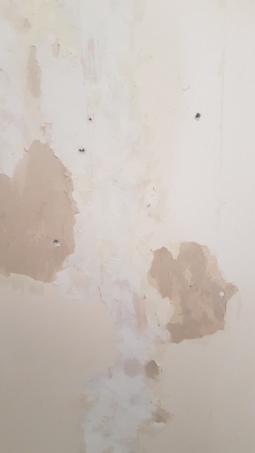

Hi,
Would welcome any advice on this. I've stripped the wallpaper (its a small internal room) and have looked a few YouTube videos. I'm going to start with one small wall.
So the plan is to apply pva adhesive (1:5) to this wall and wait 24 hours or so.
Tomorrow, I'll get some plaster and mix in a bucket. That thing you attach on the end of your drill to mix looks nice but I understand is optional (?).
Have hawk, sponge float, trowel, water spray ready.
So my basic question is: The walls are in the pictures below - do I need to do anything else to them before applying the PVA. Also -
- Thought about filling the small holes with filler - but is this really required ?
- Do I need to do anything in particular regarding the lightswitch ?
Any help welcome.
thanks
Leon
I Pva watered down twice, I normally plaster when the second coat is tacky. I also use a marshalltown trowel for the first and second coat of plater and then an ox pro ultraflex finishing trowel for the finishing 3 buffing..... I think i got both trowels from screwfix and toolstation. They cost a few bob but well worth having..... the marshalltown is also pre worn in.
pva neat with a handful of sand in .
leave for 24 hours then skim.
add the powder to the water not the other way round , and yes a mixing paddle is vital.
you need two buckets one to mix in and one with fresh water to clean tools etc.
sponges are for washing the car by the way.
Thanks Benny - appreciate you clarifying (and reminding me I need to wash my car - even in these corona-times).
