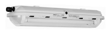

I would think best option is likely a cooker hood with lights built in, as whole assembly designed for the moisture and grease expected to be found over a hob. The problem with commercial lamps is one the price and two what they look like. This 1687851702248.pngmay take the heat and be gas proof so grease will not get inside, but I would not want one in my kitchen.
