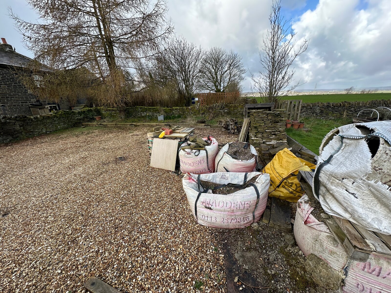

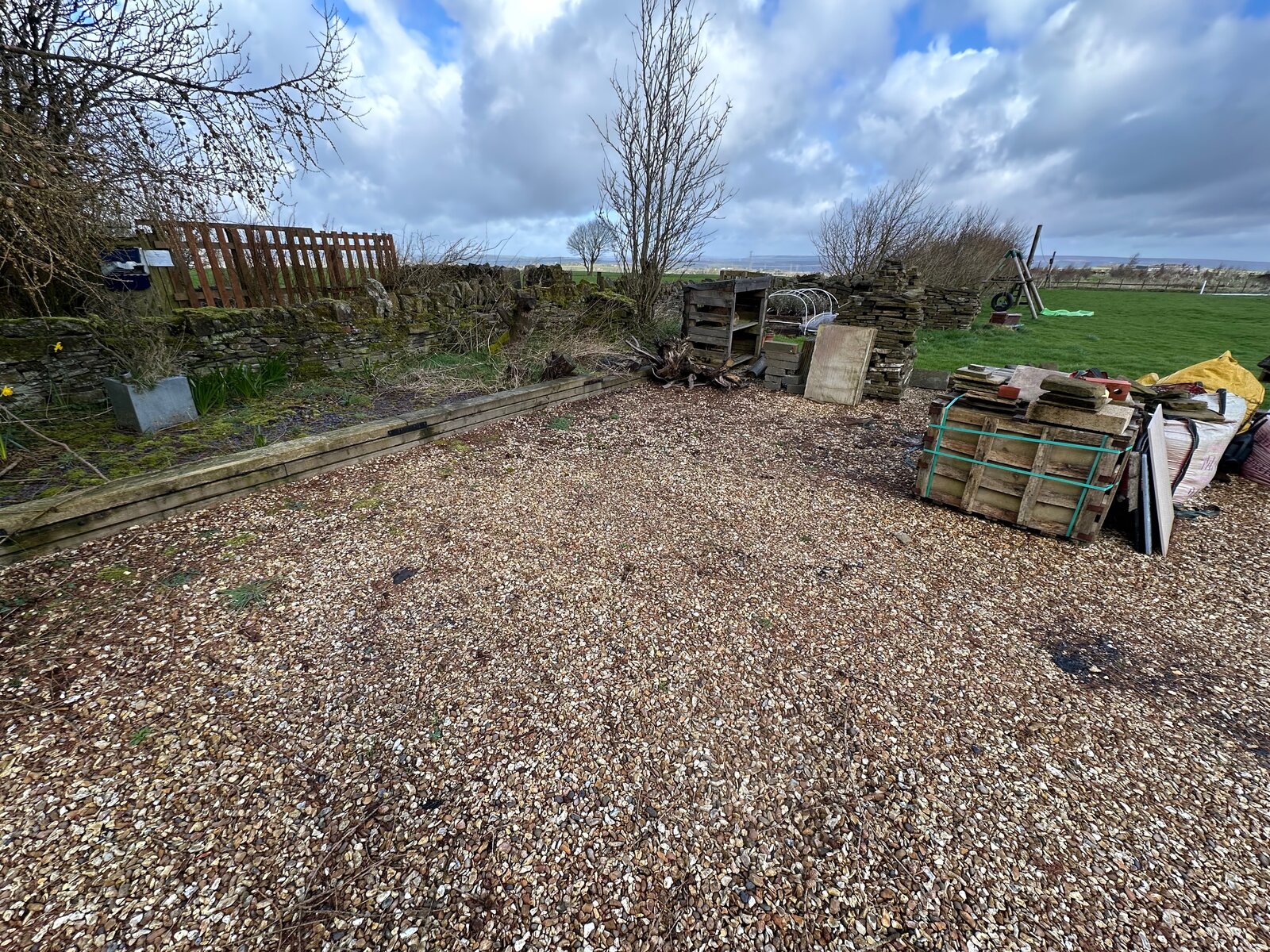

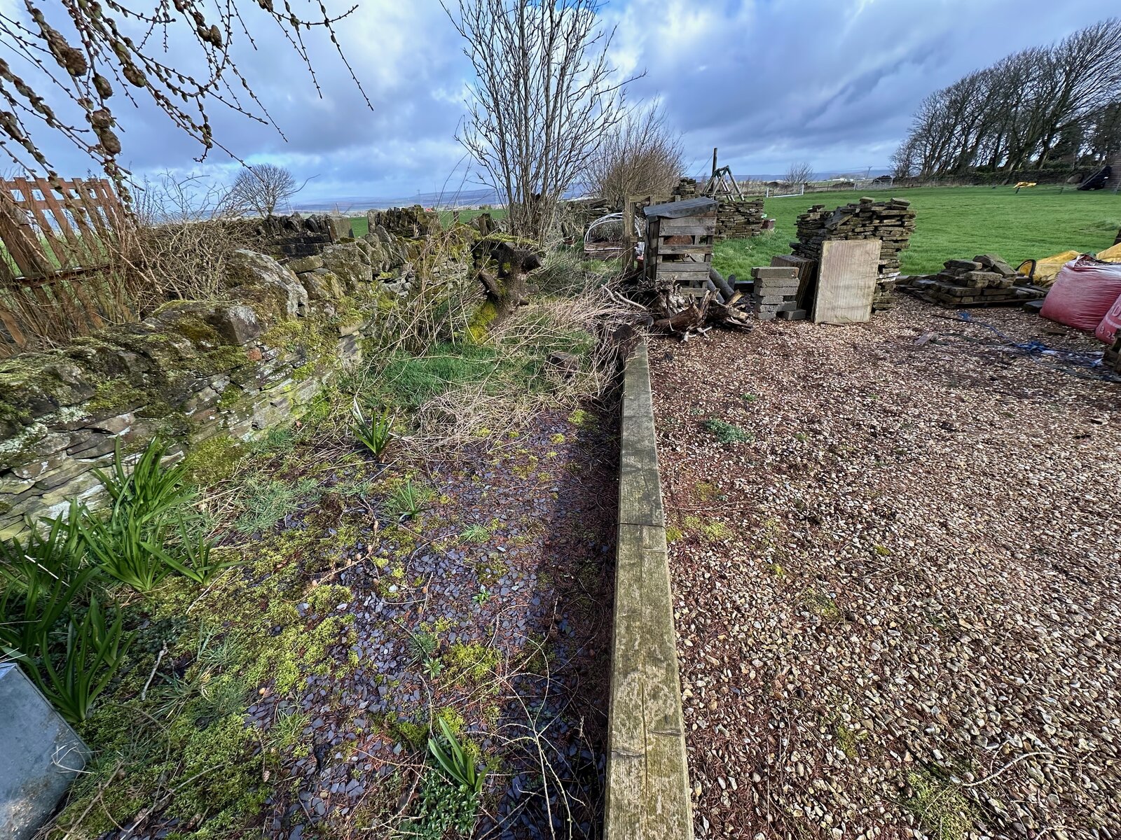

Ive attached a cpuple of pictures. Namely the west since this is closest to the boundary. Please note the trees on my side are to be removed.
This is a view to the north next to the west boundary. The wood sleeper is the thin line on the west of the plans. the garage is perhaps half a meter further to the right. so quite a distance from the wall
This is a view to the west
View to the north west and the plot area.
