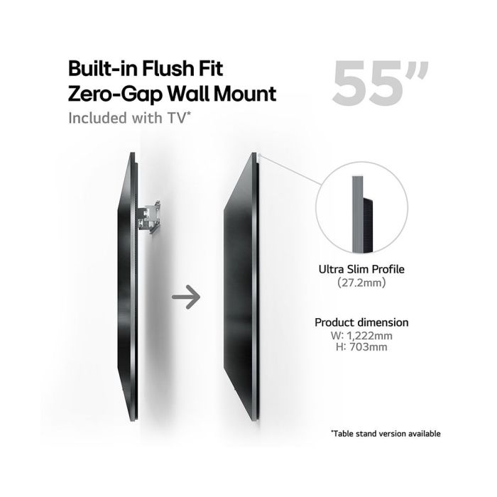

Sadly not that easy on this one. The TV fits fully flush with the wall, so the board needs to be also flush with the plasterboard. I don't want to see a wedge of MDF between the TV and the wall!
Any reason MDF over hardwood plywood?
You would only see it if you were stood right next to the wall. Are you saying the TV instructions instruct you to chop out a bit of plasterboard?
You don't buy an expensive flush mount TV to then have it "not quite" perfect!
The instructions would say fix to the wall and push the TV back to the wall, likely saying aim for a stud if a plasterboard wall. They're not going to give instructions on bracing the wall to support the TV but I'm not going to take that risk. It's intended to be 100% flush with the wall.
Picture added for reference, imagine that with a visible wedge of MDF behind it.

Turns out I might be getting a bit ahead of myself, the mount looks quite small (I'm still awaiting delivery) but hopefully should be wide enough to at least hit one stud where I hope to place it. Perhaps 1 stud with the rest of the holes toggle bolted/plugged will suffice. I guess I won't know until I attempt to pinpoint the studs to the exact TV location.
Yea, OK but you'll only perceive it to be flat against the wall when you're stood right by the wall.
The layout of our living room means the side of the TV is quite visible when walking around the room, it's not on a distant wall where you'd only look at it straight on so it's important to get fully flat.
