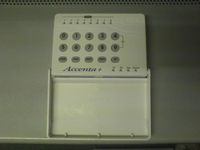

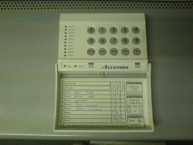

It is an Accenta 8 Mini and has been installed about 15 years ago and did not have an engineer code installed into it at the time as we were told we did not need it.
It did initially come up with tamper fault but now has more symbols showing and new keypad is different to original.

Going by your first post, you had an accenta, then replaced it with another system, correct??
You still have a tamper fault on the system, could be the panel, rkp, or sab, the system locks-out until the fault clears.
Sorry no it is still an accenta 8 mini which was originally installed but the original control panel was worn so ordered a replacement and was sent another which the box says is an ADE 8EP416-EU Accenta + as the same one was no longer available.
The rkp was replaced due to the micro switch on the back being broke. Fitted a new upgraded one and still cannot clear the tamper fault.
Yesterday managed to get the green light on with a picture of a padlock and the red light one which looks like a plug came on and spanner / tamper switch light was on also red, but keypad numbers although lit up were in-op.
When keypad changed over, wiring was copied like for like as connectors on new rkp were the same as the old one.

Double check the the wiring on the rkp and that the spring or switch is closing (sorry i'm not conversant with these systems)
if the above is ok, the tamper fault lies with the panel lid, external sounder or zone wiring.
Make sure the spring on the panel pcb is making contact with the lid when closing, you should hear a small click.
TBH i think you've went wrong along the way with the sab or global tamper
Do you have / can you use a multimeter?? if not i suggest you call the services of an alarm company.
