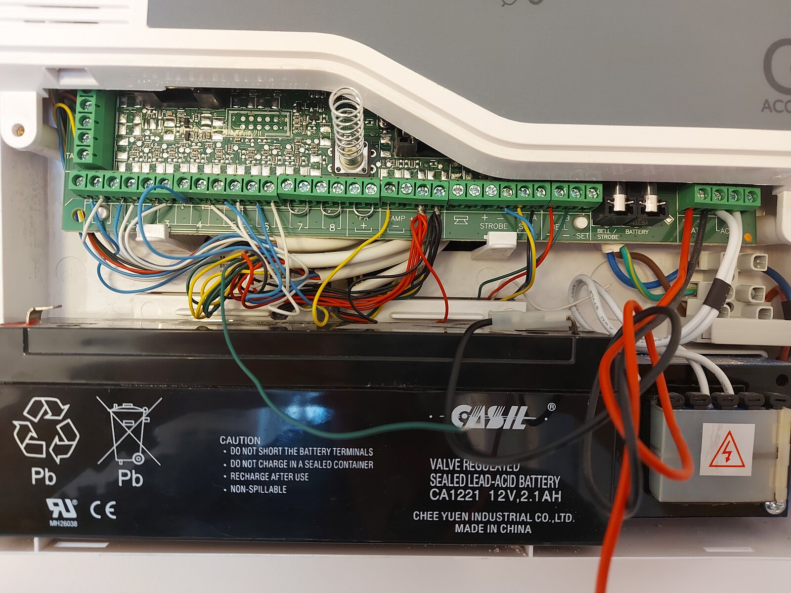

Accenta G4 alarm wiring help please
9 Jul 2022
3
Hi, my alarm decided to go off (I never set it) and I can't remember the code. I looked inside at the wiring and there appears to be a green wire which is not connected, from the attached picture can anyone advise me where it should go please?
Possibly the tamper terminal.
If you do not have the code then a default will be required to set back to factory settings.
Battery lead also missing off battery.
If you do not use alarm then power system down as your system may have other issues that's why wires are disconnected.
Thank you, it was working fine then went a bit mad today. I'll try the tamper terminal, otherwise I'll shut it off.
Sorted! The green wire into the tamper terminal, thank you again.
