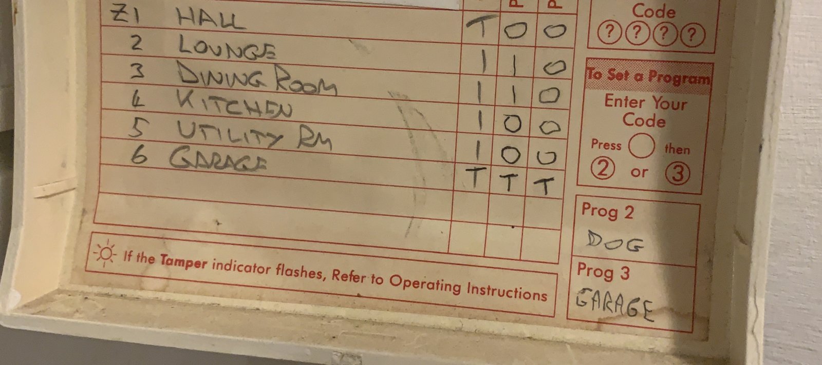

What devices do you need to isolate/disconnect ?
Do you have a zone list of your devices ?
Zone 1 front door, zone 2 hallway,etc.
I have 6 zones in total. The affected zones are kitchen and dining room. These rooms are being knocked through. I don't mind disabling the alarm completely whilst this work is going on. Does that help?
Please see below

Simplest way would be to disconnect zone 3 &4 in the control panel.
This would involve you linking out the 2 zones .
Can you take a photo of the wiring on the alarm pcb.To do this you need open the control panel lid ?
