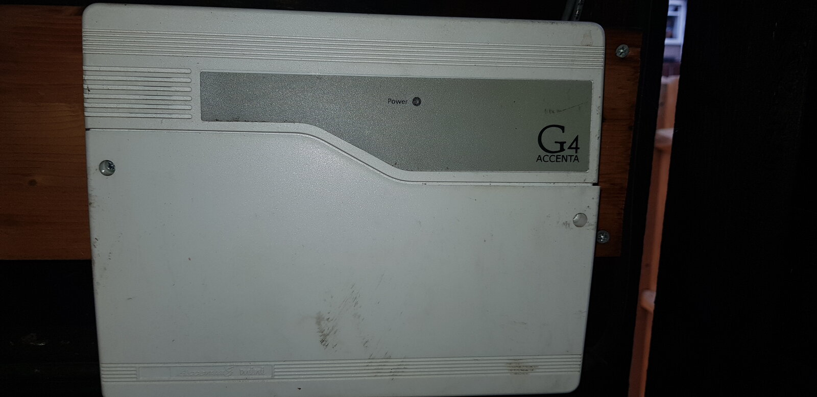

Hi, I have installed the Accenta Mini G4 and bell in my shed, it has been working for a good few years with no trouble at all, just one trigger on the shed door.
However today I could hear the alarm sounding and went into shed to find out why, the shed had not been broken into and when I tried to turn off the alarm and reset it the bell keeps going, the only way I can get the bell to stop is to turn off the mains supply. I can set and reset the alarm but with the power off the bell will never sound and I suspect the system is not really set but using the battery to make me feel like its set.

Just you said the only way you could get it to stop was to turn the mains off, the panel wouldn't stop just because you turned the mains off, as the back up battery would take over. The bell box's back up battery (on most modern bells) would have kicked in if the panels power had failed.

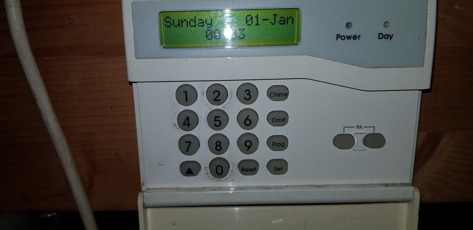

what as the display showing, what is in the event log?
how long had the alarm already been ringing for?
after 15 minutes the auto cut off is likely to have cut in and that could be a coincidence that you turned off the mains.

The display shows normal Time and date etc, nothing unusual.
The Event log shows mains Fail then Mains OK, for over last 100 entries, this was probably me turning the mains off and on, could not see any faults showing and give up after going through 100 entries.

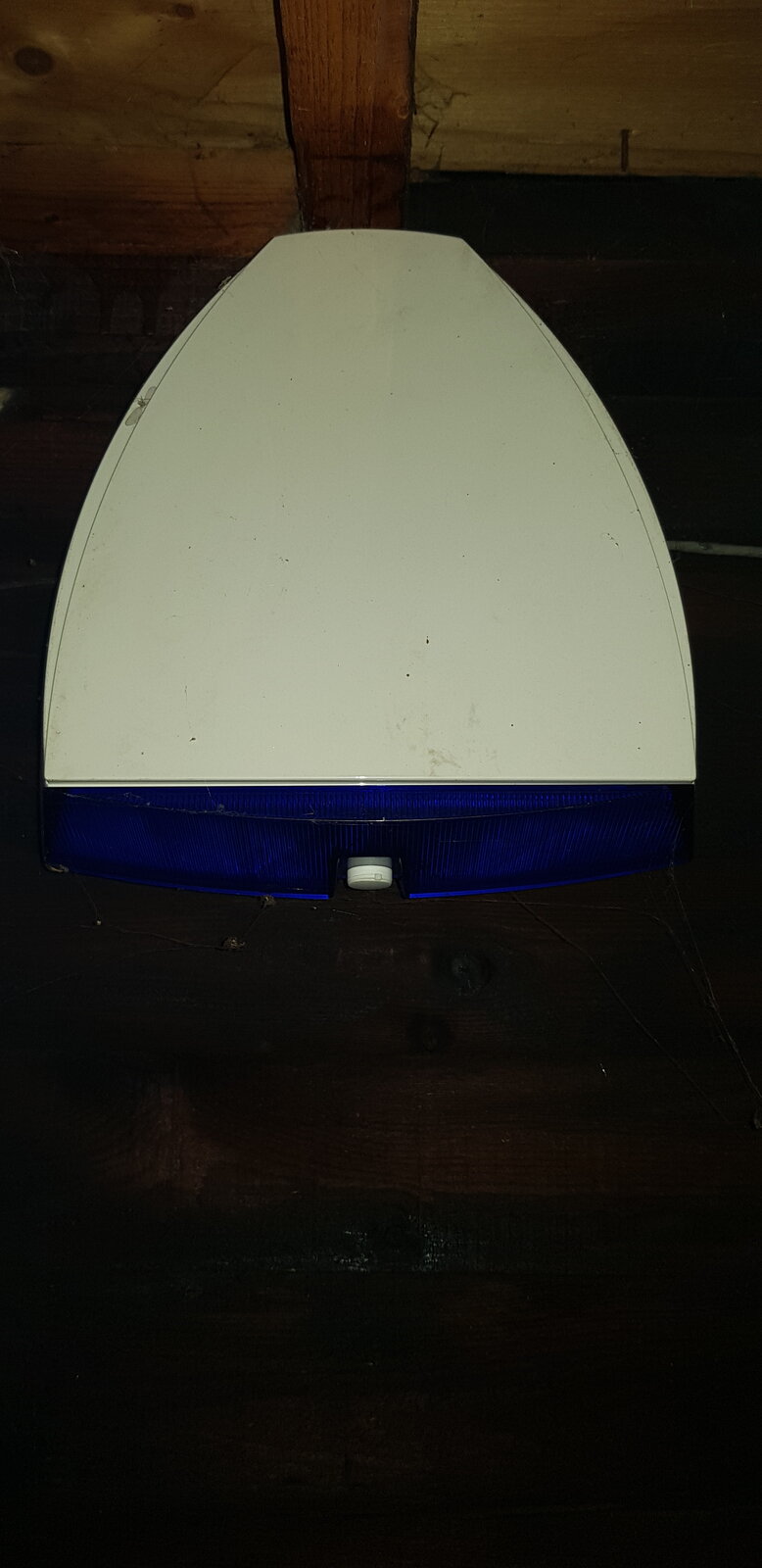

The alarm was ringing for ages, at least 2 hours, although it is not the normal alarm noise, which is like a 2 tone alarm. The noise it was making was more of a continuous loud buzzing noise, It did make the normal alarm 2 tone when I was in the programming mode and testing the alarm.

loud buzzing noise not a normal alarm noise.
do a manual bell test, how does the bell sound.
I did a manual bell test and it works OK and makes the normal alarm siren, while in prog mode the buzzing noise of the bell stops, however when out of the mode it gives off the loud buzzing noise all the time.
Took the cover off the bell box and the green and red lights are alternately flashing
not sure the bell is buzzing, I think it could be the transformer screws need tightening.
hard to be certain as cant see or hear it, but if the bell tests normally then the bell aint buzzing.

I don't use these bells, the sound if its coming from the bell doesn't sound correct.
You say a manual bell test sounds okay, which suggest the bell is okay, if it was a failed piezo I would expect it sound as rough during that test.
I would look at the back up battery as mentioned before and replace the bell, but maybe someone that knows these bells better than I can pass comment.
I tend to use odyssey/ odyssey X, Eurosec XS3D and Orisec bells, never heard one sound like that

panel back up batteries 4 to 5 years, bell box's can last 20 years+
