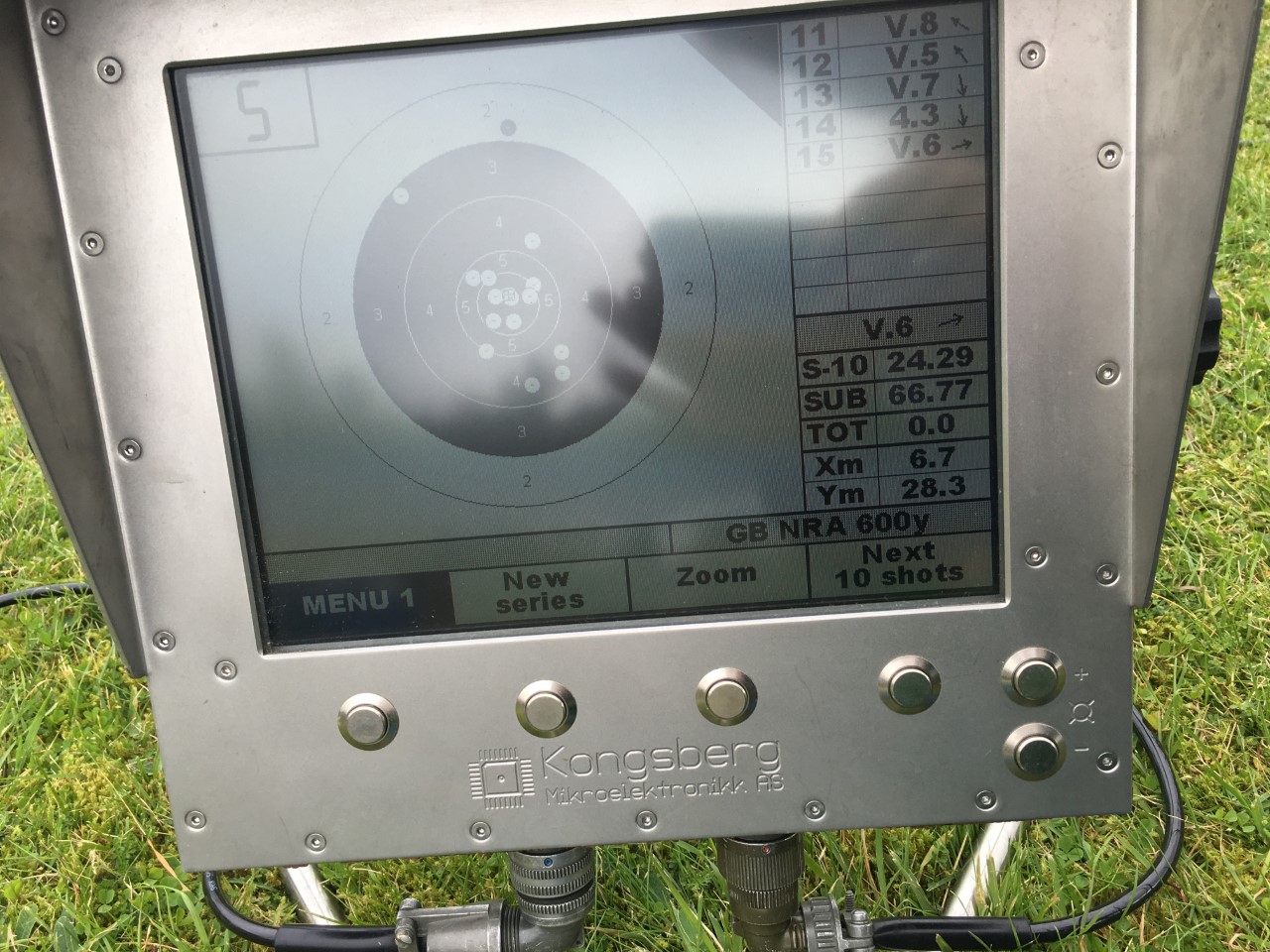

My "hobby" is shooting, i shoot at targets.
The attached is a screen shot of target I was shooting at with a single shot 308 inch [7.62.mm] supersonic round
What is of interest here is that the target has several microphones around it they calculate where the bullet hits.
The attached was at 600 Yards, so called "open sights" not using a scope.
The second from center inner circle is about as large as a human head?
Best way to see this image is to right click and use the "save as" function then zoom in?
If electronics can hear and plot a bullet, OK traveling supersonic at a target there has to be something that can locate a leak ?
