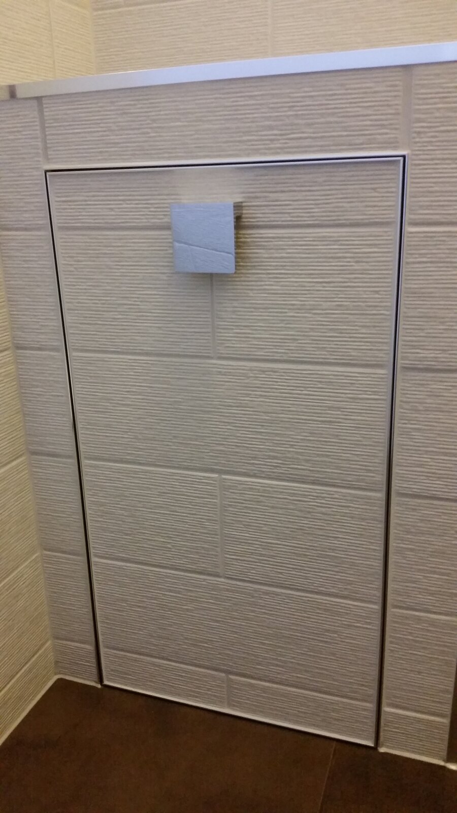

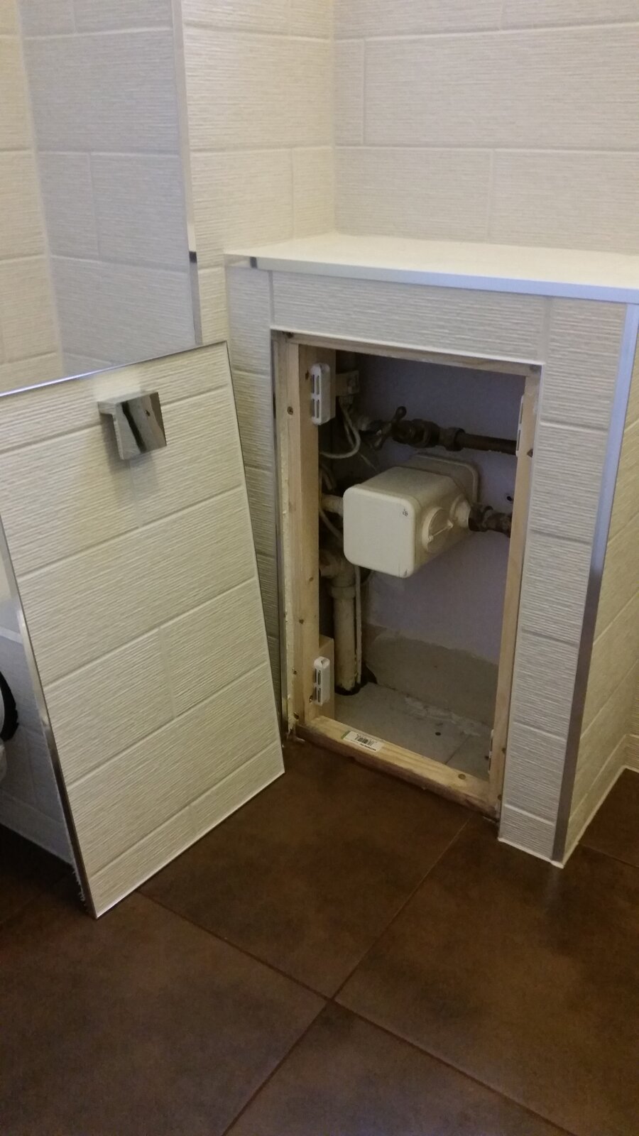

My cack-handed attempt. As Woody says, magnets in the reveal act as a stopper to prevent the door falling in, with the little magnet plates on the door. The finger hole is at the bottom, cos our 'shoe hamper' hides it, and I didn't want a knob or handle. All made from scrap stuff lying around.

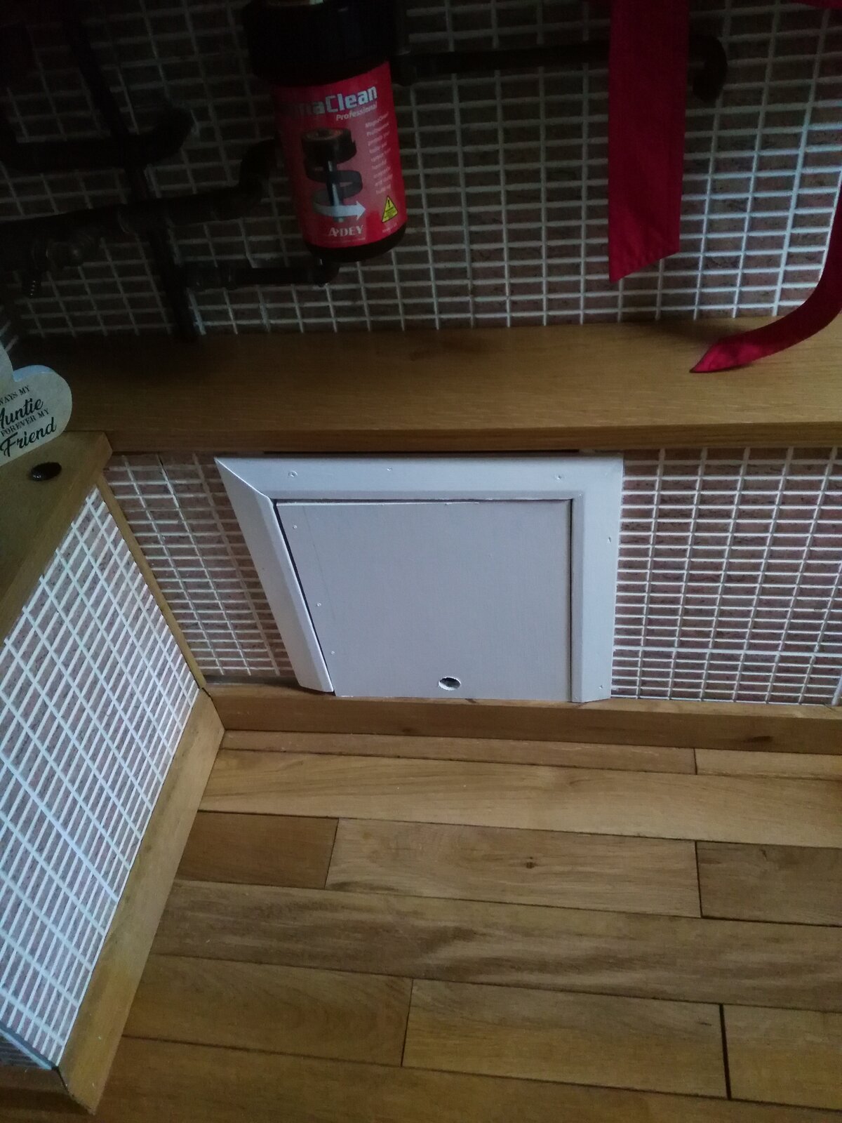

Magnets would be my favourite, here's one I made earlier.
