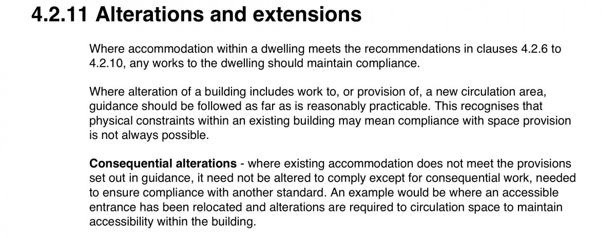

Dear Experts,
The building regs drawings for a new partition wall that I'm constructing show a requirement for an 800mm clear opening. I think this was added by the person who drew the plans after feedback from the council, without asking me. Or maybe it was there all the time but I didn't notice; in any case, I now have approval for plans that show a 800mm clear opening width.
As I understand it the width required for a wheelchair-accessible doorway depends on the dimensions of the hall that it leads from; if the corridor is more than 1050mm wide, the doorway need only be 775mm. In my case the doorway opens from a largish square hall, easily wider than this in every direction.
A standard 838mm wide, 44mm thick door just about provides a 775mm clear opening once the thickness of the door and the door stop strip have been allowed for. All my existing doors are significantly narrower; doors wider than 838mm are hard to find.
Note that I'm in Scotland.
My questions:
1. Does the requirement for accessible internal doorways even apply to me? This is a listed building and the external access involves significant steps; none of the doors (internal or external) are accessible.
2. Am I correct that I only need a 775mm clear opening to comply?
3. Now that I have approved plans showing an 800mm opening, what should I do?
Thanks!
Accessibility requirements do not apply to domestic extensions and refurbs, and I thought that applied to Scotland too.
One consideration is that there was previously a double door here, so I may be subject to the "no worse than previously" rules.
The relevant rule seems to be:
http://www.gov.scot/Resource/0050/00501003.pdf
If there was no need to comply in the first place, then changing things will not be relevant to any "can't be any worse" rule
The approved plans are just to show what you plan to do complies. If you change your mind, it's fine as long as your new plan also complies. I suppose if you follow the plans and technically it doesn't comply, they can't change their mind. But if you don't follow the plans they can decide it doesn't comply after all.
