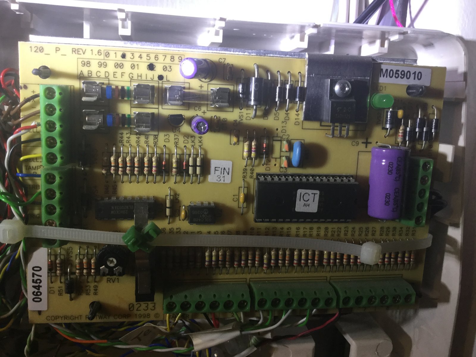

Hi hoping someone can help,
I’m looking to relocate my house alarm panel but don’t want to go to the trouble of borrowing ladders to get up to the sounder box, I was wondering if it is possible to temporary connect a 12v power adapter to the following wires to stop the siren sounding while I do the work, I’m presuming that it needs to see a constant 12v so what out of the below should I connect?

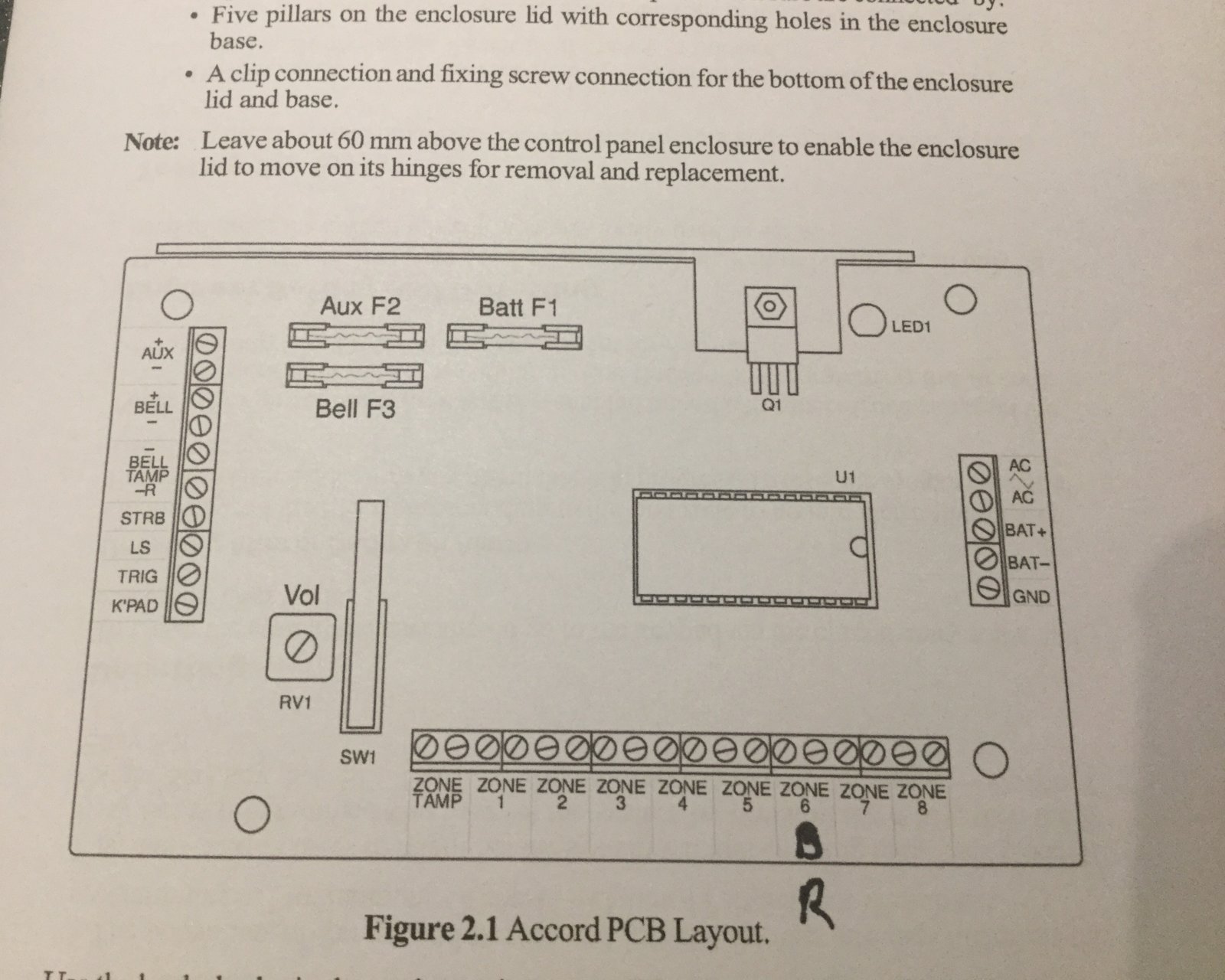

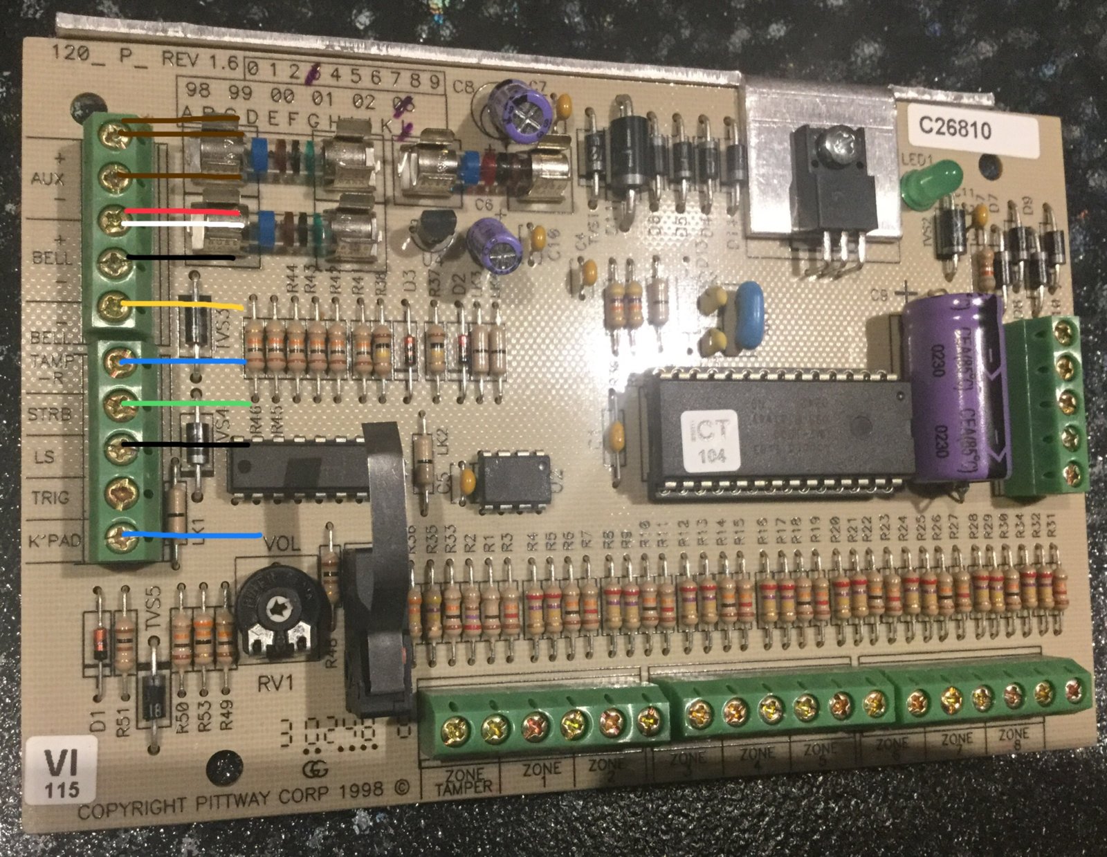

Here’s the following connections:
Aux + has 2 brown wires
Aux — has 1 brown wire
Bell + has 1 red & 1 white
Bell — has 1 black
Bell Temp — has 1 yellow
Bell Temp —R has 1 blue
Strobe: has 1 green
LS: has 1 black
Trig: is blank
K-Pad: has 1 blue
I have already tried connecting the:
Bell + red & white to the 12v adapter positive & the Bell — to the 12v adapter negative but that did not work so advice would be greatly appreciated.
Take the red & white and connect to 12 positive and take the yellow and connect to negative 0volts.
Easiest thing to do is remove bell wire from control panel and remove battery and connect the above wires to the battery terminals while you change the panel.
Make sure all cables are marked up before you remove them and also take photo so you can refer to if required.
