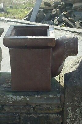

Looks like you've opened a can of worms there, I'd bet that gulley is connected to the house drainage system, so will need to be keep sealed or you'll have the garage stinking of drains. Could do with perhaps another pic from further back showing the existing gulley arrangement and where the Aco drains runs in relation. Gulley will look something like this, you've broken into the outlet section, so the trap sealing it off from the sewer is now compromised.
Personally, would dig back, and expose the drain running away from the gulley, and look to see if I could connect there somehow, if need be, fitting a vertical outlet on the Aco drain, into a 'tick trap' and then connecting that to the existing drainage.

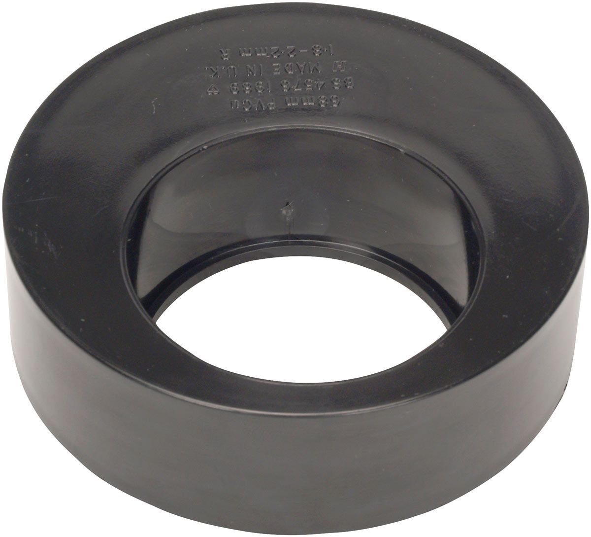

Thanks Ian. This is a bit 'heath robinson' even by my own standards, but I ended up fitting a 110mm to 68mm reducer onto the Aco pipe, cut a length of downpipe and fitted it so it ran over the top of the gully and into the drain. I then filled the void with about 100mm of concrete to fix it all in place and seal the breach in the trap. I used fibreglass roofing trim to shutter around the neck of the ceramic drain to ensure it was fully cemented in a flush.
This is the reducer I had to fit:
The 68mm pipe offset from the centre and the adapter was rotated so the 68mm pipe connects at the top of the 110mm diameter. This is the crux of the problem. It does clear the ceramic trap and also pich down at a suitable angle to flow toward the drain, but there will always be about 30mm of trapped water languishing below the exit to the 68mm pipe. I guess this will evaporate eventually through the Aco grill on a dry day, but still, it's a bit of a bodge for me.
