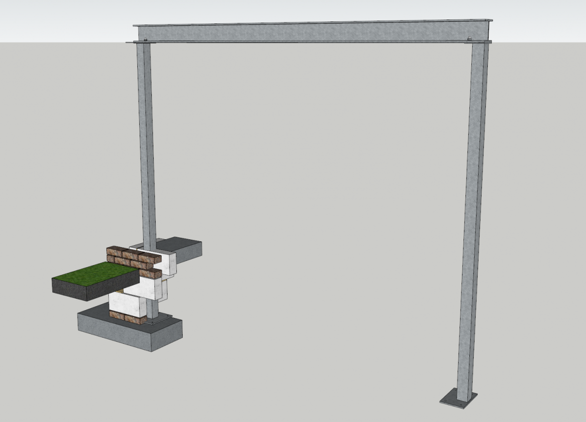

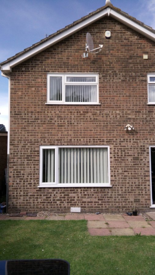

I'm soon going to be fitting goal post steelword to the rear of our house, whilst I've fitted steel beams before it's never been to this scale, except when I helped the builders over 10 years ago take out the wall in our kitchen which was of similar size.
The opening is going to be 3500mm wide, but due to the columns requiring bolting to the foundations the actual brickwork removed will be wider at foundation level, which is 750mm below DPC.

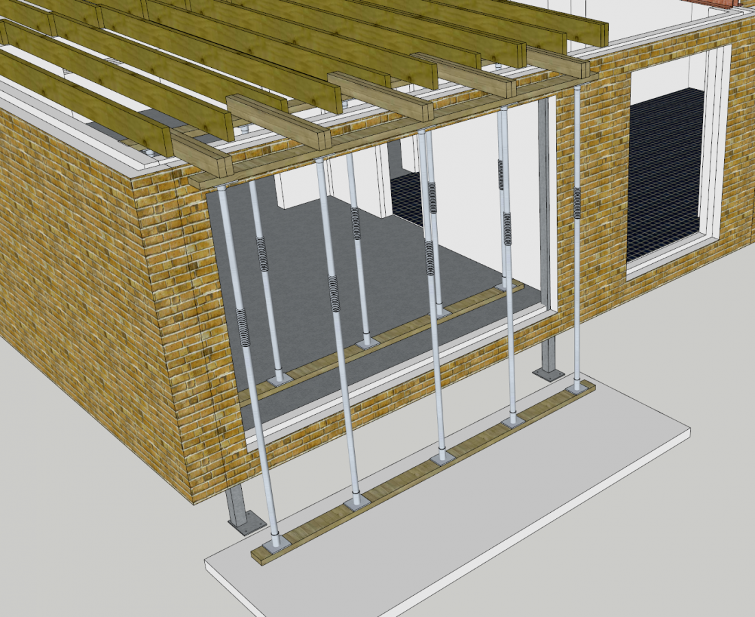

I plan on using 5 pairs of acrows, spaced at about 810mm centres along the opening, using 47 x 125 x 1200 C16 timbers in pairs as the needles. The outer acrows would be 300mm away from the building, with the inner acrows 400mm away from the wall. Acrows will be screwed to the sole plates and head plate, and needles.
The internal floor is concrete, externally I need to dig down 750mm to the foundation, so the soil at this depth should be pretty well compacted, but sole boards will be used inside and out.
The house is a two storey house with gable end above, 60mm cavity, total wall thickness 265mm, built in the 70's.
Would the above be sufficient to hold the house up whilst the wall is removed to allow fitment of the steelwork?
Would the side return wall require any bracing?
I presume it would be better to install the crossbeam and hold it in place with a couple of acrows. Then remove remove enough wall to hang the columns from the beam, drill the base plate fixing into the foundation and install the studs, then grout under the columns, and once set tighten the nuts?
Edit: Beam will be placed by the wall internally prior to putting the acrows in - best I not forget or it could get rather difficult!
@tony1851 Because the external return to the corner is only 480mm, so the brickwork is tied into the post, otherwise the corner could flex in strong winds, and potentially be blown out.

"the overturning force of the wind on the pier will be countered by the 'pre-compression' on the pier caused by the weight of brickwork above. There will also be other walls in the house parallel to the wind, which together will provide sufficient lateral stiffness to the house as a whole."
Frankly, your SE is lazy. It is easier for him/her to pull up a spread sheet, input a few numbers, and give you a print-out showing masses of useless figures
and symbols, and charge you for the privilage. The problem is that you - the client - has to pay well over the odds for a frame which is - frankly - unnecessary.
A suitably-designed beam - such as an I-beam with a welded plate, or even an off-the-peg lintel, would suffice for the load from above; and appropriate figures to prove stability of the side wall under wind load, should be all that is necessary.

What's you're opinon on the the needles, two x 5" x 2" C16 adequate enough, with 5 pairs of acrows?

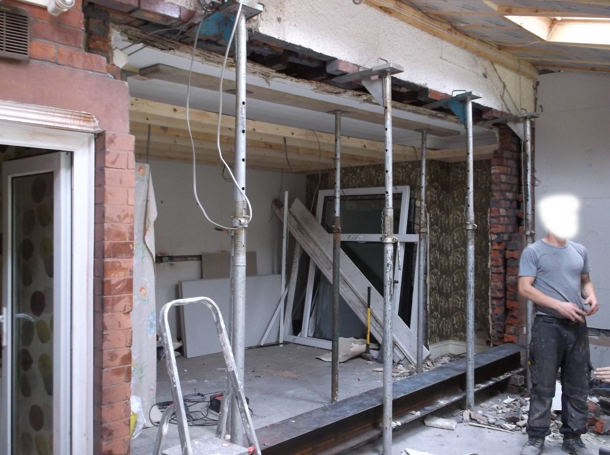

I think those would be fine. But have you considered using Strongboys - with these, you have more space to work.
(the inner row of props here are just supporting the floor joists, which run onto the wall).
Thanks, I have considered Strongboys, but from what I've read they can't take as much weight and are not ideal for cavity walls, and I thought they had to go closer to the wall so gave less space.
They can be used for cavity walls - the house in the pic is a 1920s house with brick/cavity/brick; yours looks like a modern house which will have lightweight block internally?
But it's down to whatever you feel comfortable with.
In practice the floor joists will of course be supporting the inner skin - builder was just using the Stongboys as overkill (presumably).

Inner wall is light weight block, not Thermalite though. I'll feel most comfortable using needles and acrows, I know everything is well supported then.
