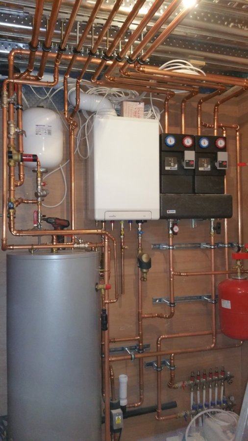

Until we get hte Superflow - this is standard fair for 4 bed houses in my portfolio. Cracking set up - pricing another one now with mixed emitters. Might want to get Chris to come down and do a piece ;).
Nice work. But has to be over kill.
I've seen industrial plant rooms with less copper and cable trays and unistrut.
Whats that black yoke with the clocks.... on the right hand side?
Its a 30 actually - I wanted the 24, but he didn't believe me when i said it would be enough... Its being commissioned as a system not a combi too ;).
House heatloss 15kW (bigger than the OP's I'd guess), and cylinder coil rated at 19kW. HW Priority off the boiler with WC on the UFH.
I've seen industrial plant rooms with less copper and cable trays.
ESBE Pump units - 7 UFH manifolds all fed direct from there - no pumpsets on the individual manifolds.
Rectangle underneath is a LLH.
Dan does a lot of rather grand places in London - they can afford it ;)
