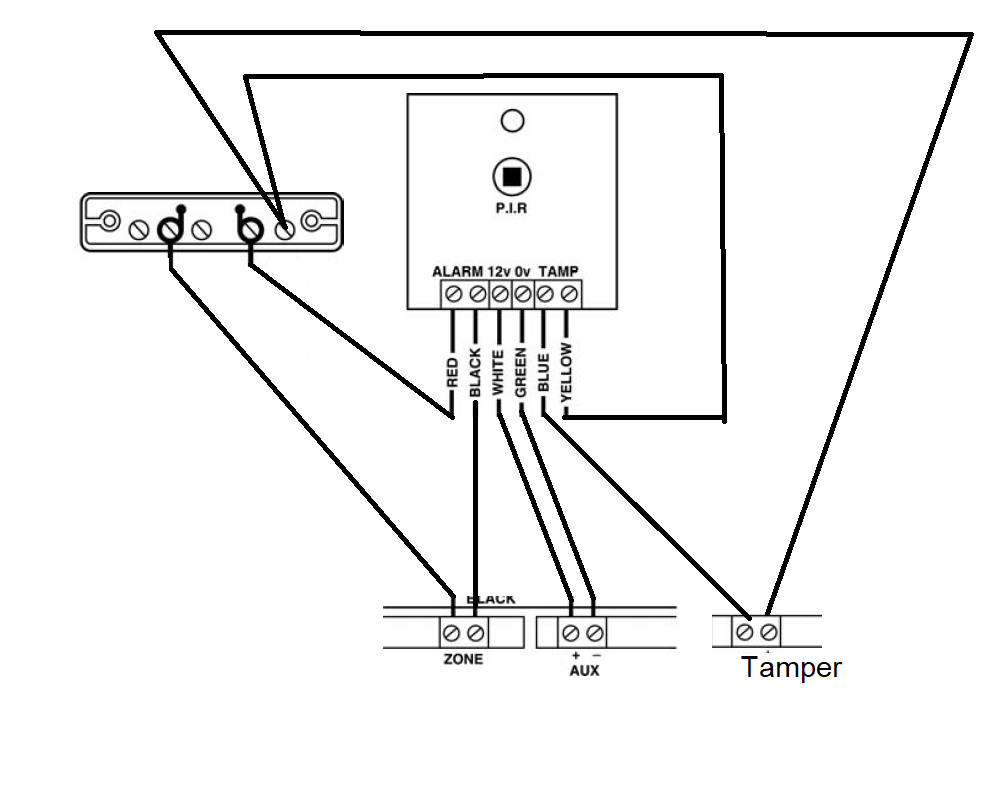

I have a cable in place for a new door contact.
The cable is coiled up by the control panel.
I would like the new contact to be on the same zone as the room pir.
Should the cable come out of the control panel terminals for the new contact or the room pir? Does it matter?
depends on what your using it for I guess
as for how to wire it, just needs to be in series for the alarm and tamper circuits if in use.

New contact to protect single garage door and also be walk in zone to start the timer. Currently has pir in room which is on walk in zone
zone x terminal 1 ----------------- Alarm terminal 1 PIR
Alarm terminal 2 PIR ------- back to zone x terminal 2
becomes
Alarm terminal 2 PIR --------contact reed terminal 1
contact reed terminal 2--------back to zone x terminal 2
image is a bit rough but should be a little easier to follow

May struggle with secures decription of series wiring following the attempt to ptogram a entry exit zone on zone 7.
