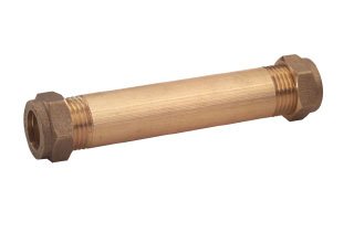

I'm sure this simple question will have been answered before but I can't find it in the forums - how do you fit a compression tee to existing solid copper pipe?
I've not cut the pipe yet but I'm guessing that there won't be enough movement in the pipes to get the ends into the fitting. Maybe there will, but I thought I'd ask if there is a trick to this first.

Using the tee, mark the pipe with what needs to be cut out. Put the nuts and olives on the pipe first the the body of the tee. There usually is enough play in the pipes unless it is in a very constricted space.
if it is tight i have cut the pipe where the tee is to go then cut the pipe further along its length and fitted a straight coupling and tee, this usually gives a bit more leeway to get the tee and straight in by manipulating the pipes and the fact there are 2 cuts helps more than you would think, and if you are really clever you can file or dremel the inside of the coupling to make it a slip coupling so it fits right over one end then pulls back over the pipe when the tee has been fitted

I had a similar problem on a pipe in a paint shop where no flame could be used. I cut a couple of inches of pipe out further along slipped one of these on, connected the tee. and tightened the burst pipe repair.
Job done. :)
