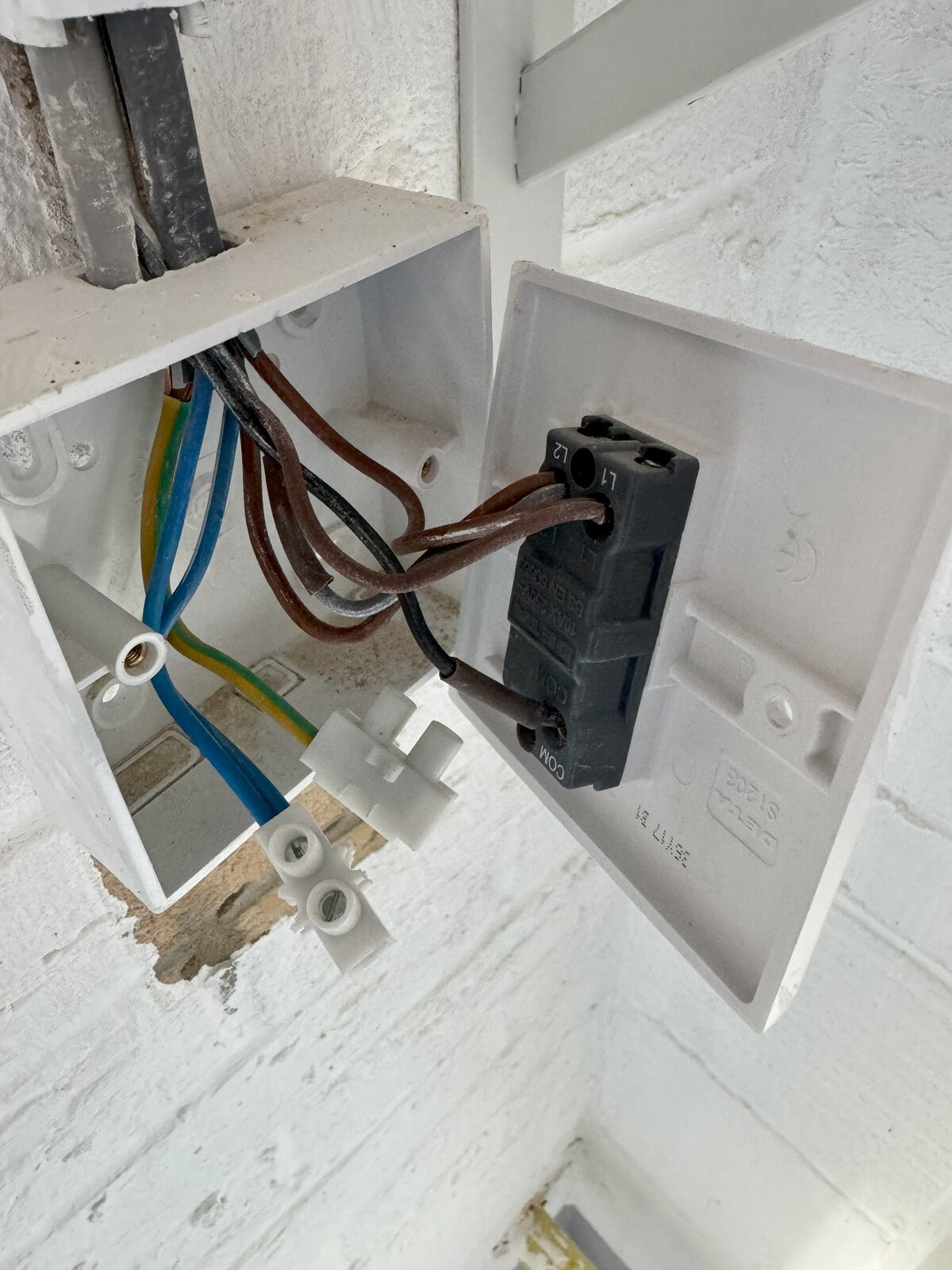

Thank you for the responses. I have attached a picture. This is just everything reconnected back to the original state and the camera feed removed (white cable in the background).
Show us where the 3 core+earth cable connects to.
I don't think you should be connecting to that.

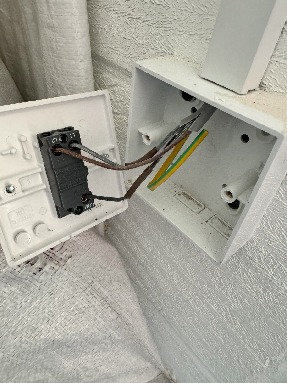

Send a picture of inside both switches.

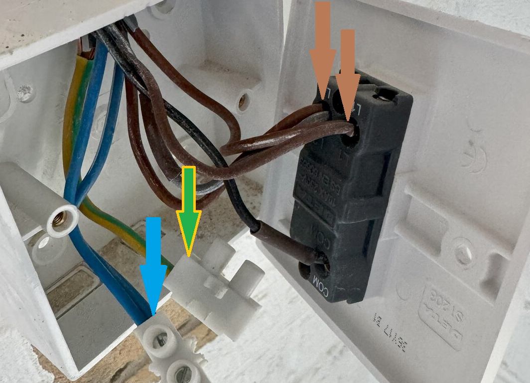

Here are the photos of inside both switches. Thanks

This is where you will find the connexions you require, one of the brown points will be permanent live, the other will be switched live.

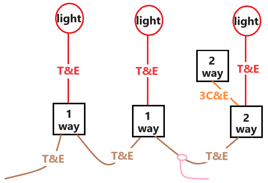

Alternatively identify which of the twin and earth cables is permanent live. Very likely the twin and earth cable loops between switches as shown brown:
and add the junction box there (shown pink)
To clarify what has been said - you could get your feed from the switch with lots of wires.
The blues in the connector block is neutral.
The permanent live you will require is EITHER at L1 or L2 on the switch - you will have to check first.
