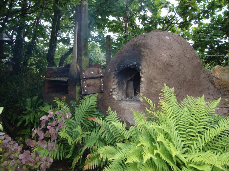

I've built an oven for a re-enactment group that I'm in and there are some pictures on DIYnot if you care to search.It is wood fired and the fire sits inside the oven tyo heat it up and is raked out to put the bread or whatever in there, for this reason a larger door than a letterbox is required , in fact there is a mathamatical formular that needs to be followed to give the right balance of air flows and equates to something like 65% of the internal height of the oven for the height of the door. As to it sitting on top of the barby then yes that will work because you are creating in effect what is called a french oven.I would research a bit more as to the size of the door in this situation as you may still need a larger door than a letterbox.
Thanks, I'll take a look on there and will hunt for your photos. I too was going to have the coal/wood in the oven, seems the best way to do it.
That's a giant, I could probably live in there!
Thanks for the information, looks like I have a bit of a job to look forward to in spring.
