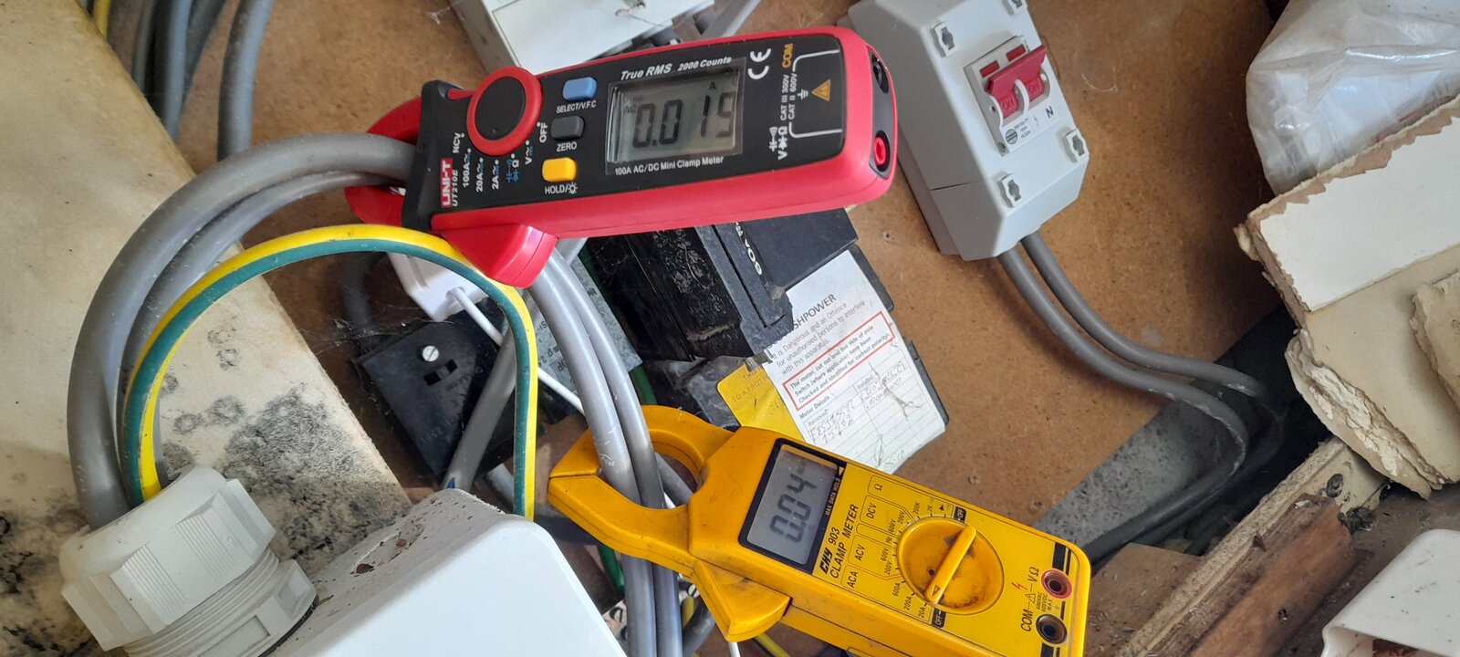

Not the case for an English rental property EICR, it states it covers non-portable equipment, 18 kg or with wheels makes it portable. I think this is wrong, it should be done as part of the inspection and testing of in service electrical equipment, often called PAT testing, but the law does not say that.
A clamp on ammeter should read the earth leakage, the red/black one is showing 15 mA, but the yellow one is showing 40 mA around the same cables, and the yellow one can't show less than 10 mA so not really suitable.
If the RCD is tripping then we have to use an insulation tester,
however since these test with DC, and we use AC it is not an accurate measure of current flow. 230/Ω=amps, so 25555.56 Ω = 9 mA but in real terms since it is not measuring and inductive or capacitive leaking, 1MΩ is considered the limit.
I replaced the yellow clamp on with the red and black one, as one yellow one only measured in 10 mA increments, and two it would not measure DC. It also seems to have a problem with the jaws, hence high reading.
I have tried to measure DC, the limit with an A type is 6 mA, however with the DC range it uses the hall effect, and it has to be zeroed, and I found in mA range even the slightest movement can cause it to require zeroing again, so not really possible to measure the DC leakage down to 6 mA.
However, using RCBO's then any DC leakage is only affecting that circuit, so although in theory DC can stop the RCBO tripping, the chances of DC freezing the RCD at the same time as it is needed to trip, are much reduced.
We should test the RCD under load conditions, as well as without the load, so the 15 mA test will show if there is excessive leakage, and the 30 mA test will include any DC leakage, but think testing like that would be rare in practice. Also checking if leakage under 9 mA is also rare, if you look at the expensive professional clamp on meters, many are like my cheap yellow one which I bought in Hong Kong before the take-over, so over 25 years old.
