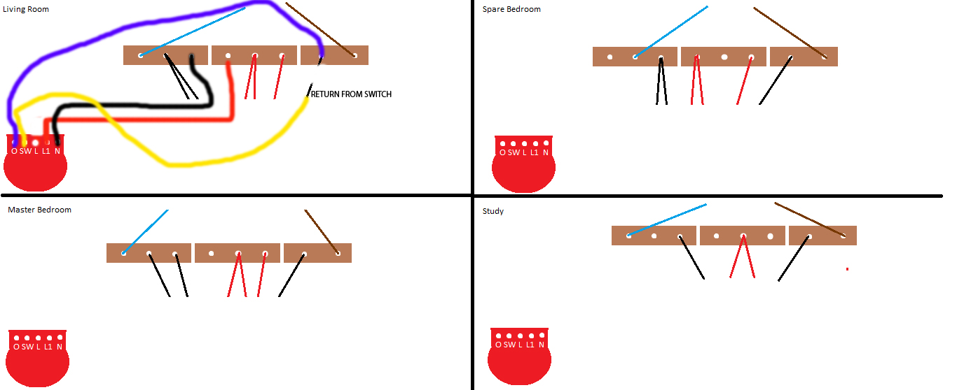

I recently purchased a few Shelly 1PMs (quite similar to Shelly 1, but with power monitoring and slightly different terminals - Shelly 1PM = O SW L L1 N)
Plan to add them to a few standard (one switch, one light) rooms in my house.
Was planning on following the guide here but the wiring diagrams linked (for the ceiling rose itself) do not seem to correspond with any of my own ceiling roses. All are working correctly just the different wiring for each one is making me second guess myself.
Also tried to check the pinned wiring diagrams on the forum without success as the images links appear to be broken
Attached is an image of all the ceiling roses:
Here is the wiring diagram given by Shelly themselves
Would be really grateful is someone could (quite literally) join the dots together for me!
