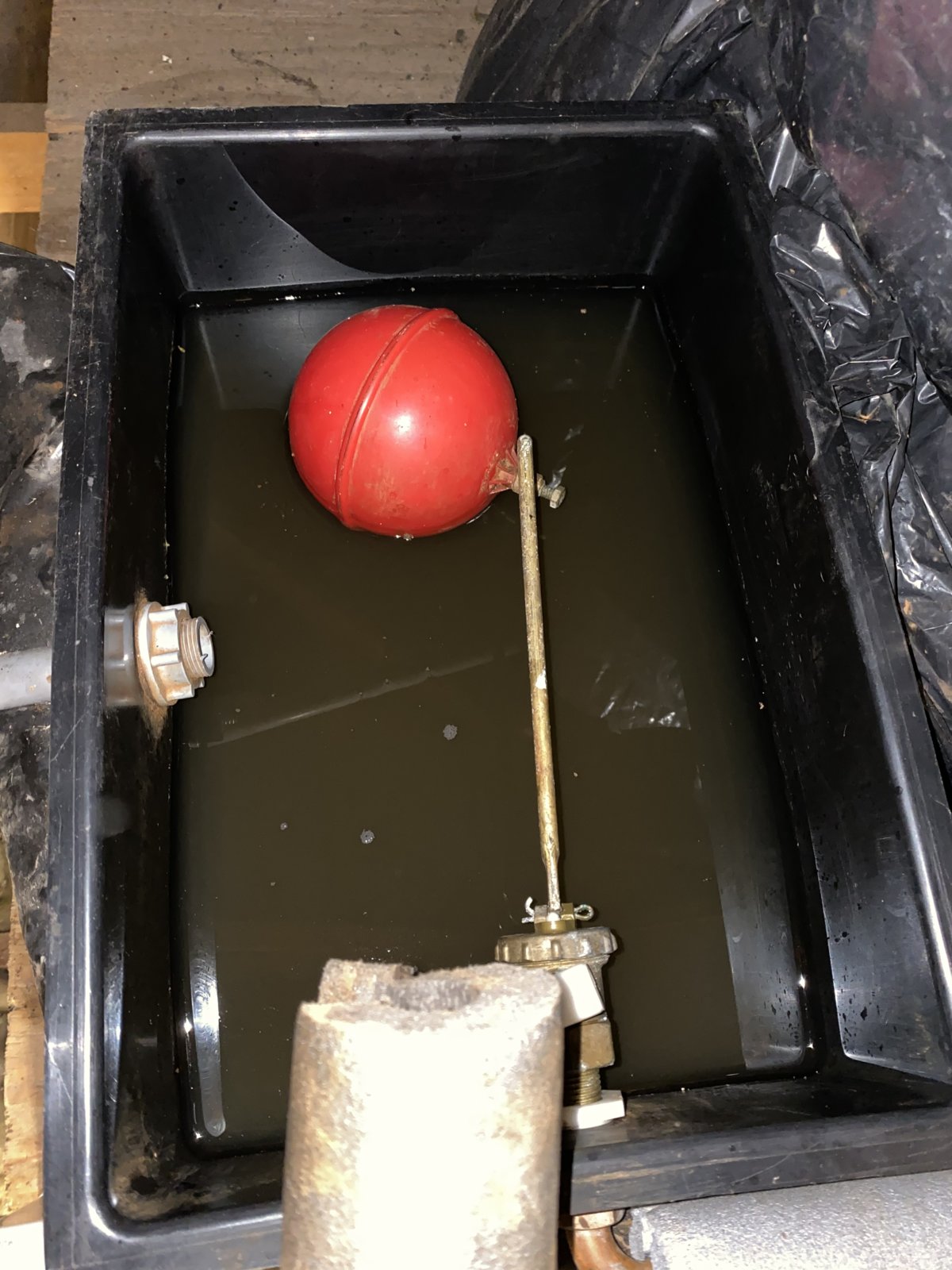

So when I refilled the F&E tank on Saturday, the water was obviously clear.
This is it today. Is that a sign the X400 is working or would it always look like that?
