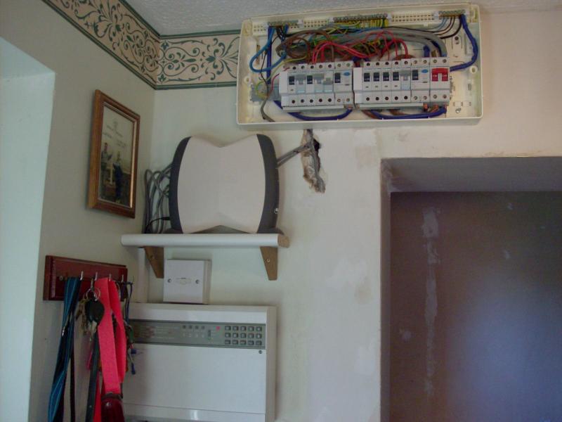

Hello All. I'm new to this forum, but cannot directly see answer anywhere else as yet.
In my hall, above head height, I want to add a double socket almost adjacent to my consumer unit, to separately to power a broadband modem/router continually and maybe some christmas lights once a year so no major power draw. The ring main goes in a different direction and is impractical to link into.
I want the double socket to have it's own separate fuse/trip switch in the consumer unit (it's brand new and there's space). This is to do with a wired comms network I've got running through my house.

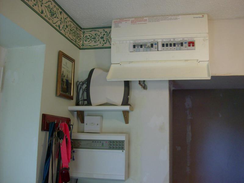

In my attached photo(s) you can see the modem/router above the house alarm (I'm going to be trunking in the loose cables), which already has a fused box with a 3amp fuse (linked to the far left trip switch on the consumer unit). What I'm asking is how it's best and safest done by myself. In addition to the double socket, do I need a separate fused box like the house alarm between the double socket and the consumer unit and if so what size fuse goes in the in each.
Hope this makes sense and I haven't added in too much information than necessary. It seems such a simple job but I wish to do it myself and seek your experienced advice.
Many Thanks. [/img]
2.5mm Twin and Earth directly from consumer unit to new socket. Use a B20 Hagar MCB.

No need for an FCU for your socket, your alarm is done correctly and does need one.
Your ethernet cables going directly up behind the consumer unit is not exactly ideal!
Just to clarify the photo. The ethernet cables do come under the consumer unit, rather than behind it. I know it's quite difficult to make this out in the photo.

You cannot do that as the feed to the alarm is (looks like) 1mm cable and probably only has a 6A breaker protecting it. You cannot put a 13A socket on that. Your alarm is best left on its own circuit.
You are being overly cautious re running a spur. A separate circuit wont protect your computer stuff from anything. Use a surge protection if you are concerned. I'd be more worried about the proximity of the LAN cables to the power circuits..
Further to the other comments on your ethernet cables, they also look to be under more than ideal mechanical stress! I'd move your router to the right a few inches :)
Understood. Don't worry about the ethernet cables though, they might look it, but they aren't under any stress, simply tucked away lightly behind the router and are separately 'piped' through the wall . I'll be shielding them appropriately away from the power cables later on.

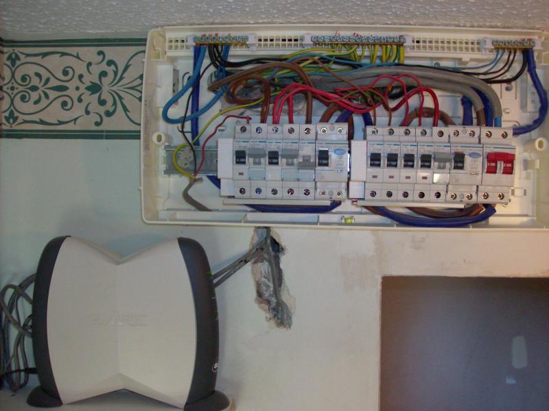

Looking at your photo - is that bare copper from the incoming live tail showing above the main switch?
If it is, then that is a really bad thing, since one accidental touch to that, and you'll get one hell of a jolt - and given how high the CU appears to be, if the shock doesn't kill you, falling off the ladder might!
What I would say though, is unless you have a isolator before your CU, don't try and fix it yourself - either get your supplier to fit an isolator, or get an electrician in who's happy to sort it, or get your supplier/DNO out to pull the main fuse, so you can safely fix it - I wouldn't do it with the cable live...
