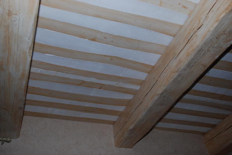

I live in an older house (1841) where the upstairs level currently has no floors. The ceilings in the lower habitable level rest on top of the support beams/joists.
My ultimate goal is to convert the upstairs level so that it is habitable, but realistically this will be a multi-year project.
The upstairs level is 150m2 (roughly 12.0*12.5), has windows and a large (insulated) vaulted roof above where the ceiling would go (although I don't plan on adding a ceiling despite the additional volume that will require heating).
The support beams/joists that carry the ceiling for the lower level are of two different sizes and spacings (all units in inches)
1) 4.5*8.5 with 30.5 inch spacings between centres
2) 7.5*9.5 with 43 inch spacings between centres
When we bought the house the structural engineer said that these beams wood support a concrete floor.
I would like to lay boarding over the ceilings, with 50mm insulation over this. Then add UFH on top of the insulation followed by a concrete screed.
At this stage I am only concerned with laying the boards and installing the insulation.
Given the large spacings between the beams what size (thickness) do I need for the floorboards - my concern is that they might sag when the concrete screed is laid? Can I use chipboard?

Over 30 and 43 inches, any standard timber floor covering would sag and bounce. You'll need very thick boards, especially if you intend to screed. Maybe a precast concrete slab floor, or a roomfull of acros and poured reinforced slab.

Deluks, the beams are visible from below. I have attached a photo of each of the different beams. The ceiling above the pine beams is 14mm tongue and grooved pine. The ceiling above the larger beams seems to be bespoke. It consists of (35mm) wood strips with plaster in between. The panels have steel frames.

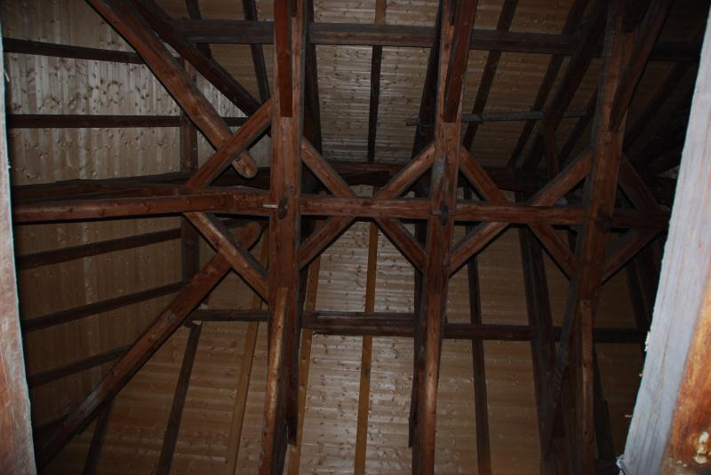

Catlad, to make sure that I have understood correctly, when you say “countering with say 3x2” do you mean 90degree 3x2 joists on top of the existing beams? Floor height is not an issue as the existing wall height is approximately 3.2m (although the bottoms of the roof beams are about 50cm lower than this. The roof is a pyramid shape with a slope of about 45 degrees. Picture attached.

Yes as Noseall suggested 90 degrees to existing joists, if it is anything like the couple I have worked on it will help you to level the floor out.
