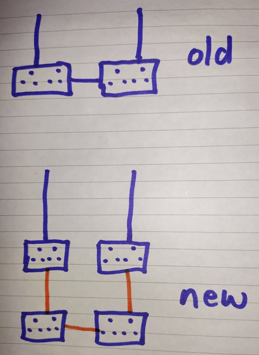

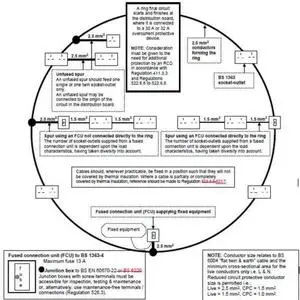

I have two double sockets next to each other, (32A ring circuit), and want to add two outdoor sockets. One for a rigid body spa and one for basic garden equipment such as strimmer's and hedge cutters, (mower is petrol).
With them being so close to each other, I am assuming the cables come down from the loft, (it's a bungalow), to the first one, them simply go to the side to its neighbour and back up to the loft.
Is it safe/compliant to take a spur off each one or should a FCU be brought into the two circuits for safety?
Although I'm capable of doing the work I will be using an electrician due to my poor health. Just want it in my head the best/safest/compliant way for him to do it so I can question if he deviates.

One spur only can be taken as shown, however the rigid body spa is the problem. Most garden equipment is class II so no earth, but is it is earthed outside the Equipotential bonding zone then can't really use a TN-C-S supply.
If that is correct, then just make the two new sockets part of the ring.
Remove the cable between the two existing sockets
then add cable from one of them to the first new socket, then to the second new socket, and then to the other existing socket.
Can I just add a comment ? - Personally I favour some kind of isolator for outside sockets , example 20A DP switch (Yes I know 20A? but if it`s a propriety make rather than cheap tatt then I do not envisage problems) inside the dwelling . That way if damage/leaking occurs to the outside sockets they can readily be omitted ready for replacement/repair purposes and avoid problem RCD trips. That would bring us back to utilising spurs.
Classic case for extending the ring, check the existing cabling if you're up to it and the means of disconnection is safe and up to date as its a spa.
