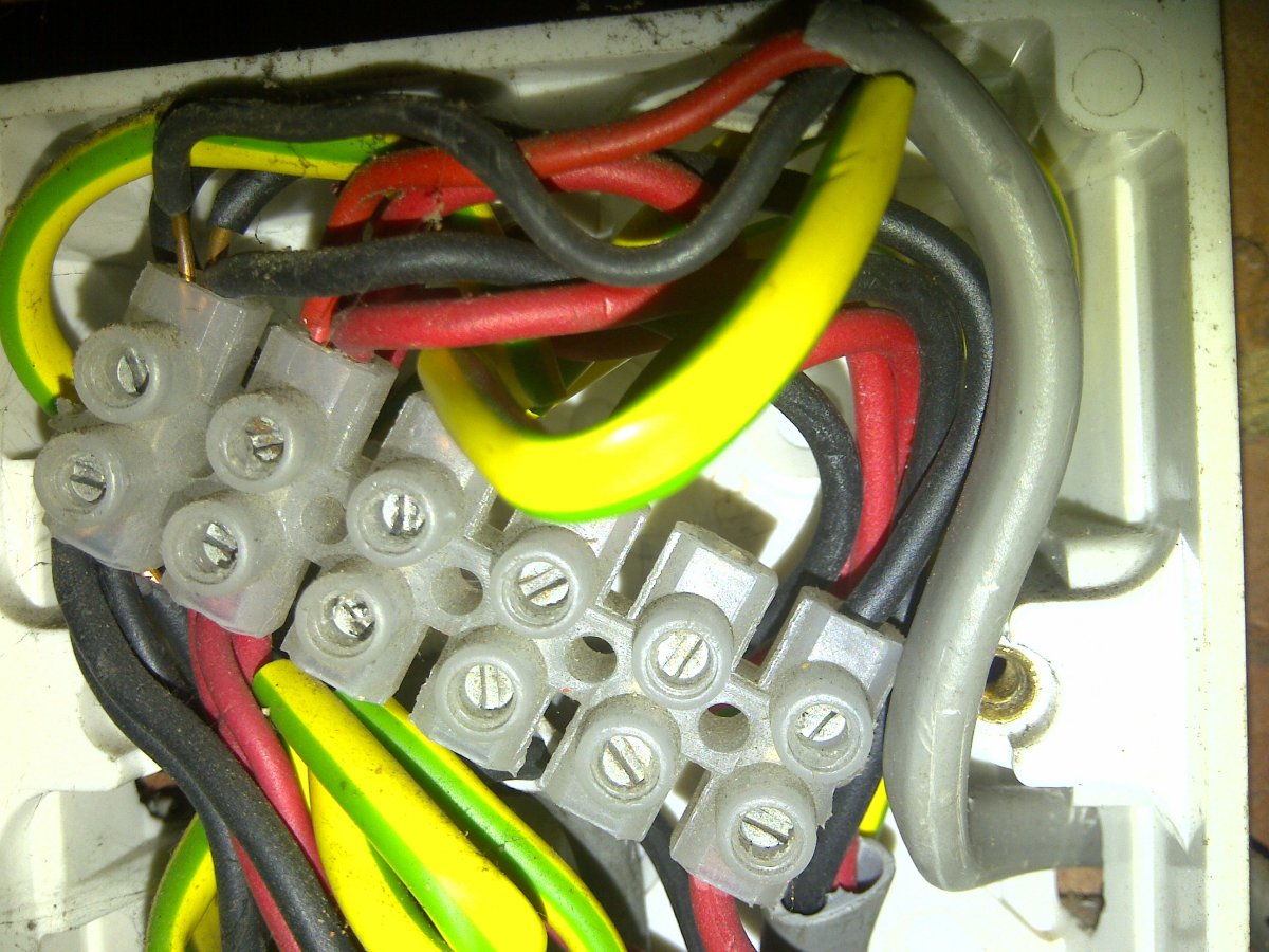

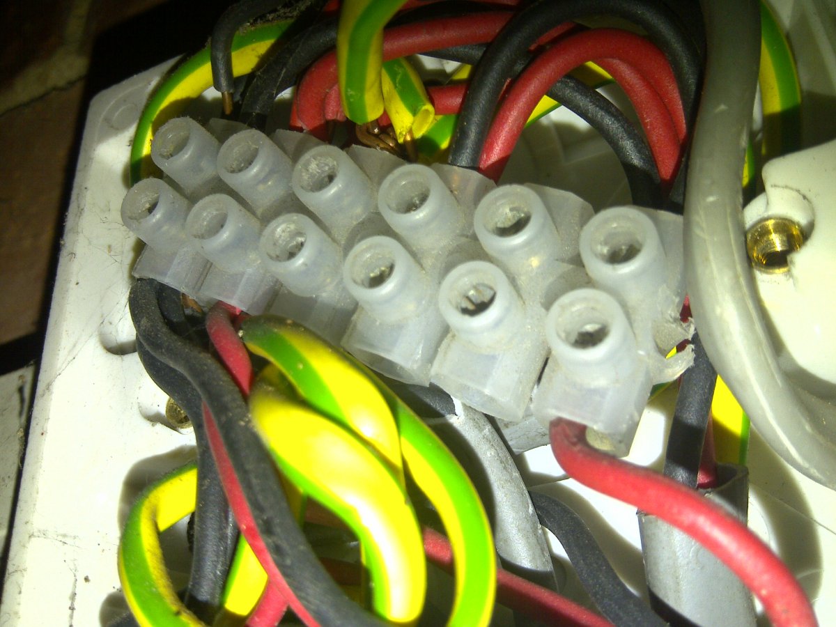

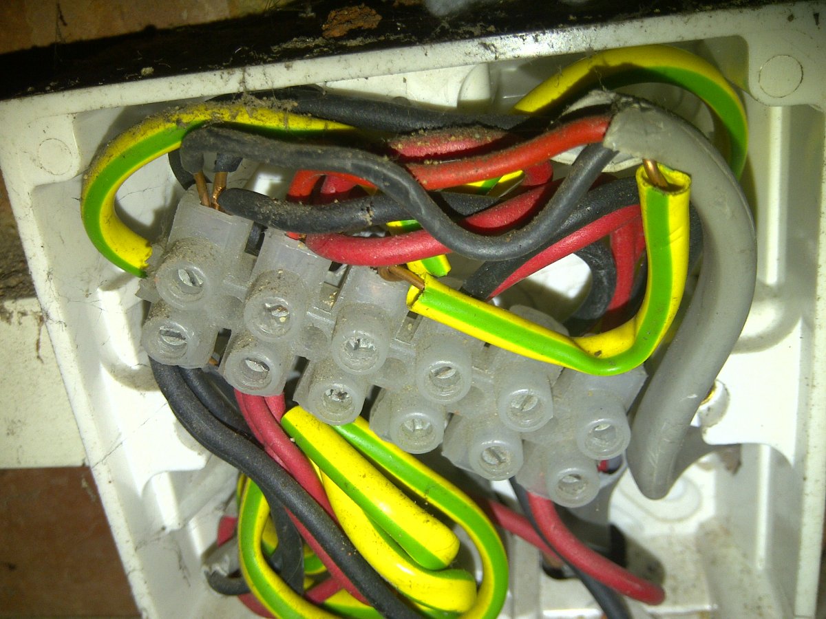

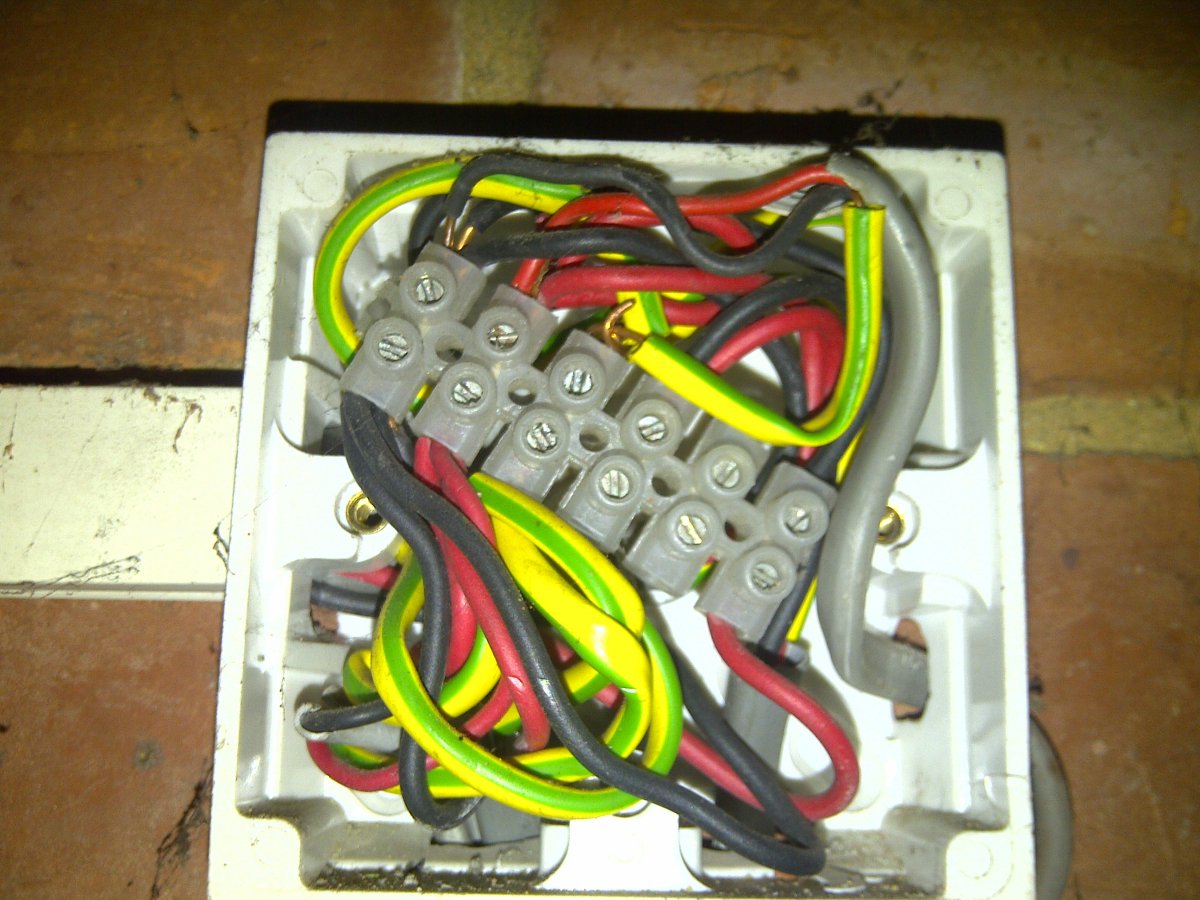

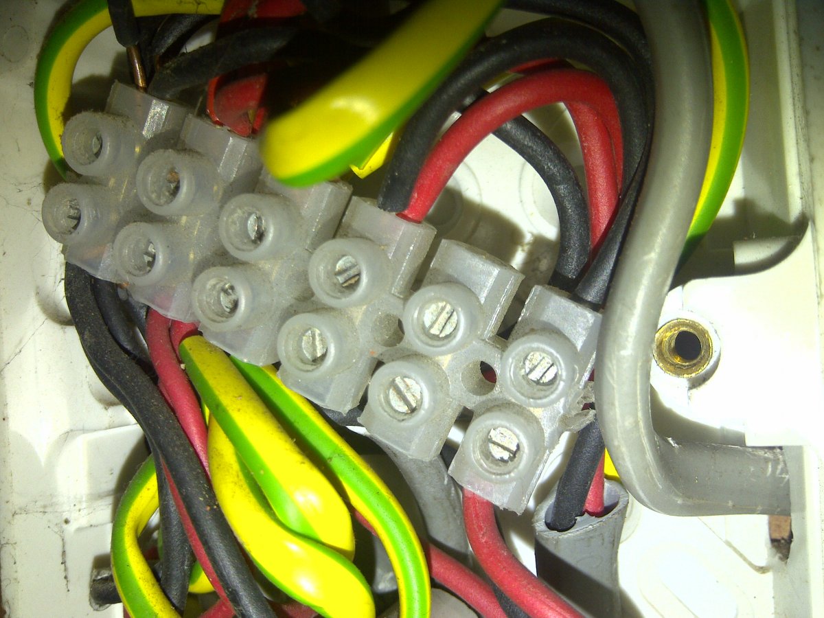

upload_2017-3-17_16-31-34.jpegupload_2017-3-17_16-32-12.jpegupload_2017-3-17_16-32-39.jpegupload_2017-3-17_16-33-15.jpeg
The cable for the security light is the one coming in from the right hand side of the junction box.
If a FCU is not required, then I assume a STDP switch will suffice?
Yup - a switch is all you need, and a double pole one will provide complete isolation - a useful precaution for outside lights, even if there is no RCD on the circuit at the moment. What power is the light? It's easy to overload a lighting circuit by using large halogen lights. 6A is 1380W, and you can swallow up almost half of that with ease.
And as for that rat's nest....
It really could do with tidying up - there's exposed copper, at least one of the earth connections looks a bit iffy....
... the cables aren't clamped, and basically there's too much crammed in there.
Something like a central heating wiring centre would be better.

Linking terminals together is a good way to avoid cramming things is - in this, for example, you can see that some of the terminals in the top row are linked, but the smaller block on the left shows the technique - you use one side of the terminal block to loop a link from one to the other, leaving you a row of terminals on the other side for individual cables.
I don't know how far to the right in your photo the space extends, but if you want to make provision for future expansion then you could create 4 sections - L/N/E and Switched Live with some unused terminals in each.
