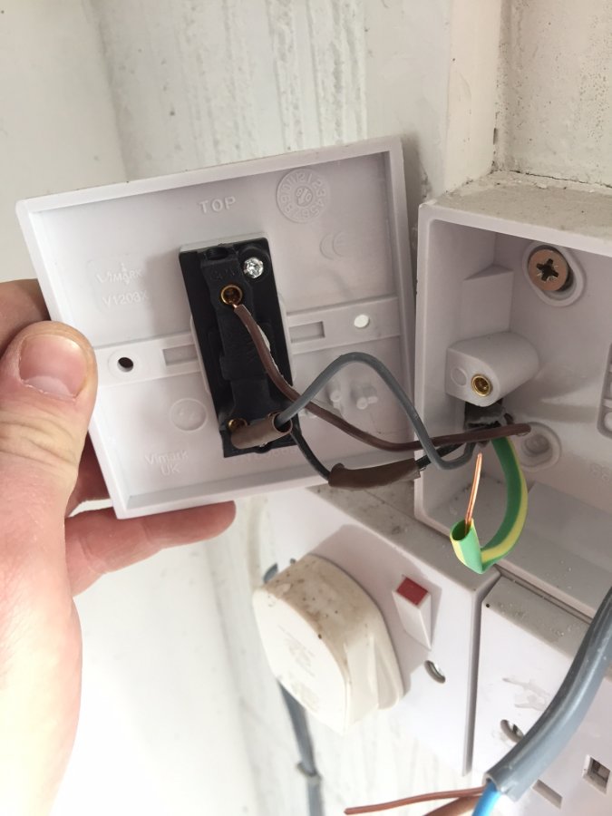

I would like to add an additional 2 outside lights to my house. I currently have a light switch that I figure I can take a spur from. Ideally I'd like 1 cable to go from a new switch (next to the current) to a splitter, to then go to 2 lights.
Idea is to take live feed from original switch to new timer switch, then feed switched power down the new cable, that then splits to 2 lights.
I've already run some 2 core cable in, not thinking about the cabling requirements too o_O
Is this possible? Thanks
This is the current light switch

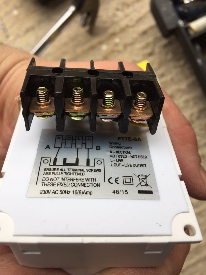

The new timer for the new light
That switch is part of a 2-way circuit. There is no neutral there. Either the important stuff is at the other end of that cable, or in a ceiling somewhere/at a light fitting.
So, no. You cannot do what you propose with what you have there.
What's the cable with blue and brown not connected to the switch?
That timer needs a neutral which your existing light switch doesn't have. Also the new lights will need a neutral, again you wont have the neutral from the light switch or timer to provide this. You first need to be able to get a neutral and live to the timer and then to the lights.
Also don't leave that earth wire bare and unconnected to anything
So, this is in a garage, the cable will run to the light on the ceiling.
The cable you questioned is the one I've run in today.
What you 2 are saying is I need neutral. Can I take a spur from the light this switch ... switches? Then use the cable I've run already?
The earth was existing and had a crimp on the end, It'll get replaced.
Take a permanent live, neutral & earth from the existing light fitting down to your timer, then from the timer take a neutral from the neutral terminal, switched live from the Live out and join the earth wires together in either a spare terminal or clamp all to your junction box.
Forget about the existing light switch as its of little/no use.

Have another look at his picture.
N-NEUTRAL NOT USED.
But yes the new lights will need a neutral.
Ok thanks. What do I do about the split? Is it possible to just split it colour to colour?
EDIT:
To clarify, there are 4 pins
N - Neutral
NotUsed
L - Live
L OUT - Live out.
So it does require a neutral? I just connect the feed N to the N-Neutral pin?
N-NEUTRAL NOT USED.
If you look at the timer there is a terminal labelled "not used" this is the terminal that isn't used. The neutral is used and required.
Ok, so what Omega say is correct. Thanks.

Re the loose earth, is there no parking terminal in the pattress box?
