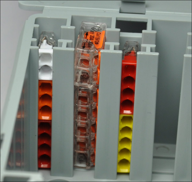

Just after a quick sanity check on what I am proposing before I start. my landing and stairwell is L shaped and I currently have one ceiling rose hung on the right angle of the L. There are switches top and bottom and it is wired up using the attached method. I am want to replace the ceiling rose with a double insulated spot light, add an extra spotlight on the landing end of the L and then a new ceiling rose with chandelier at the other end of the L in the stairwell.
My plan is to replace the existing rose with a junction box in the loft and terminate switch and lighting ring in the junction box. Where the diagram shows "to lamp holder" i will run twin and earth that to a second box and then wire each light fitting to that box.
In theory I could run all the cables from the one junction box but there would be too many cables terminating in the one box.
Hope this makes sense?
Makes sense, just make sure the junction box is either accessible, or a maintenance free one.
Also your spot lights make sure that there's no extra air leakage into the loft as partly it will be a waste of heat and partly there will be additional condensation risk from the warm damper internal air.
There wouldn't be if you used a junction box with enough capacity for all the cables.
Sorry - Wagobox XL (to take the new 221/2273s, - if you happen to have a stock of the older types of connectors the XLA accommodates those.)
